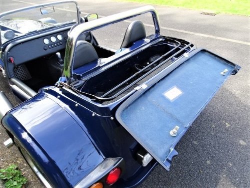

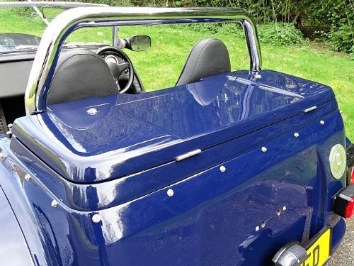

MrPid Posted April 23, 2019 Author Posted April 23, 2019 I have attached two pics of my old car, as an example. Im trying to work out if the complete lid is the top two fixtures (above the fasteners). Cheers, Quote
Stuart Posted April 23, 2019 Posted April 23, 2019 Looks exactly the same as my 20 year old one and that was definitely 2 pieces Quote
Gary Taylor Posted April 23, 2019 Posted April 23, 2019 Definitely 2 pieces the base and the lid Quote
Dave Eastwood (Gadgetman) - Club Chairman Posted April 23, 2019 Posted April 23, 2019 Yes, it comes as two pieces the lower frame that silicons and is screwed onto the tub, plus the actual lid, a set of hinges and a set of locks. ZK bodywork is the traditional style bodywork used from the late nineties to the current date. Earlier bodywork, know as "kit" bodywork, looks very similar but has a large number of detail differences, including being slightly narrower towards the top of the scuttle/bonnet area Quote
