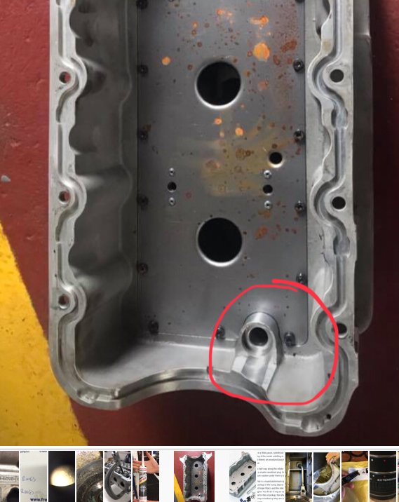

Could someone advise which pickup the Raceline sumps take?
I’ve been offered one for my 1800 Silvertop

That was my first port of call, however there is nothing  specifically about the pick up on there
Raceline have their own pickup, that's somewhat integrated into the sump
Yeah I can see that part, does the standard pick up just connect to that?
There's an aluminium tophat that sits in the hole circled, with an O ring above and below. As you bolt the sump up, it compresses the O rings and forms a seal directly into the base of the oil pump.

There are 2 windage trays, 1 for the 1800 and 1 for the 2 liter

The black top needs to use the silver top windage tray or race lines own one.   Didn’t think the 1.8 or 2.0 where different.  The windage tray when fitted to the black is not directly bolted to the engine like silver tops but spacered and bolted to the steel cover in the raceline sump. . There for the steel cover in the sump needs needs captive nuts when used with a black top.
