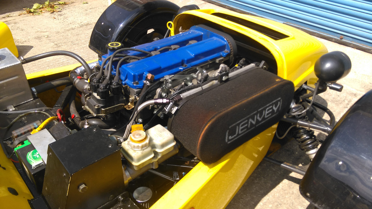

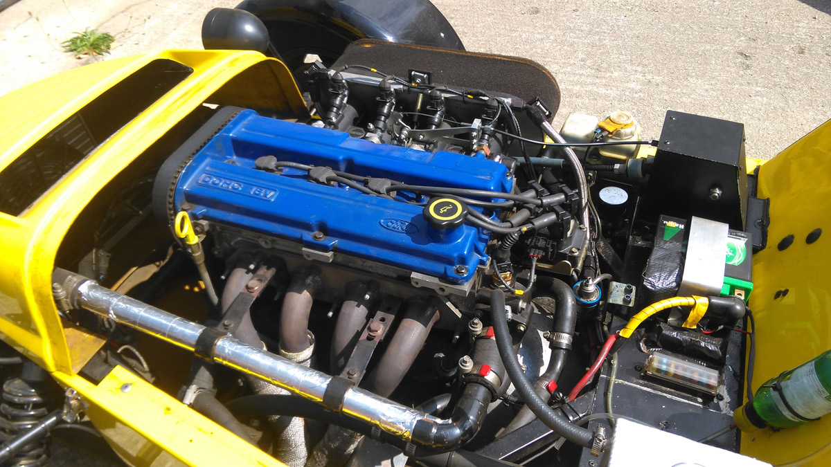

- 1800 Silvertop Zetec, built by Stanwood Performance, blueprinted for the 750 MC race series. 'Fast road' cam and ported / polished head. Standard bottom end with the exception of ARP rod bolts. Don't discount the 1800 in favour of a 2 litre, I've had a 2l before and this engine suits a light car much better due to the reduced internal mass of the engine.
- The car had been a sprint car before I bought it and completed very little mileage - Stick Q269 KCP into https://www.check-mot.service.gov.uk/

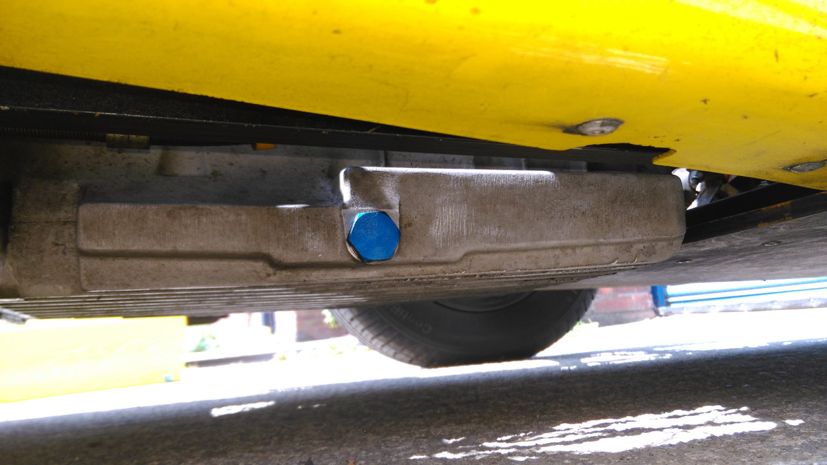

- Jenvey 45mm ITBs, SBD / Bosch injectors, custom motorsport engine wiring loom, Raceline wet sump / baffle / pickup, Dunnell flywheel, standard clutch, DTA EX48 ECU, Omex shift light system, Sytec fuel pump and filter
- Cambelt done under 2 years / couple of thousand miles ago. Oil change done twice in my ownership with fully synth Ford grade 5w40 (5w30 is standard but this is better for maintaining pressure when hot).

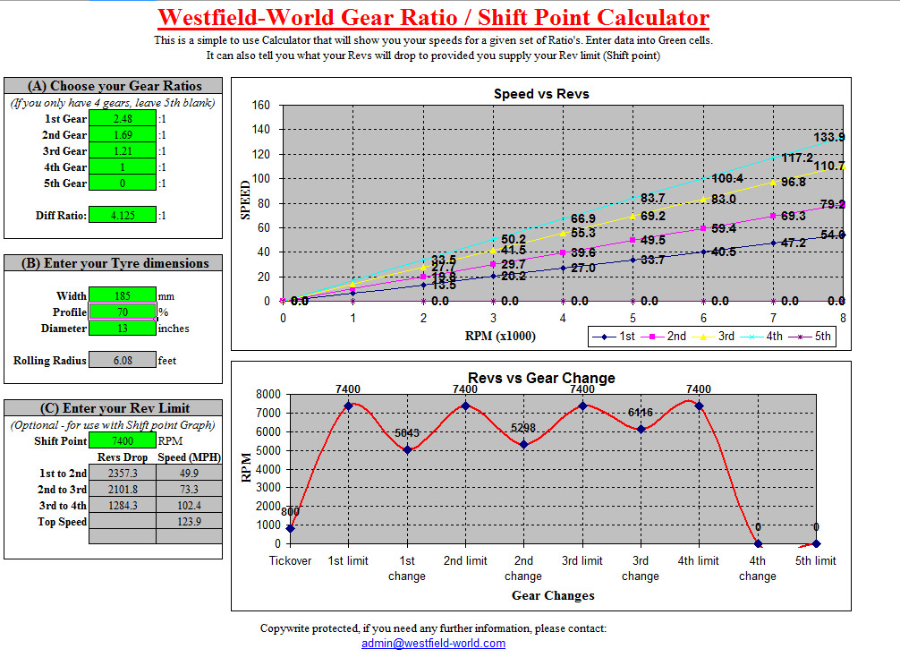

- Gearbox is a 4 speed with Quaife long first (2.48) gearset. Gears 1, 2 (1.69 ratio) & 3 (1.21 ratio) are straight cut with 4th (1:1) being semi helical. Recent overhaul with new input and output seals, filled with correct SAE80 mineral oil. Top of 4th with my 4.1 diff and 13" wheels gives 124mph top speed which matches perfectly the aero top speed of the car. Why carry around an extra 15kg and a 5th gear if you don't really need it? :)

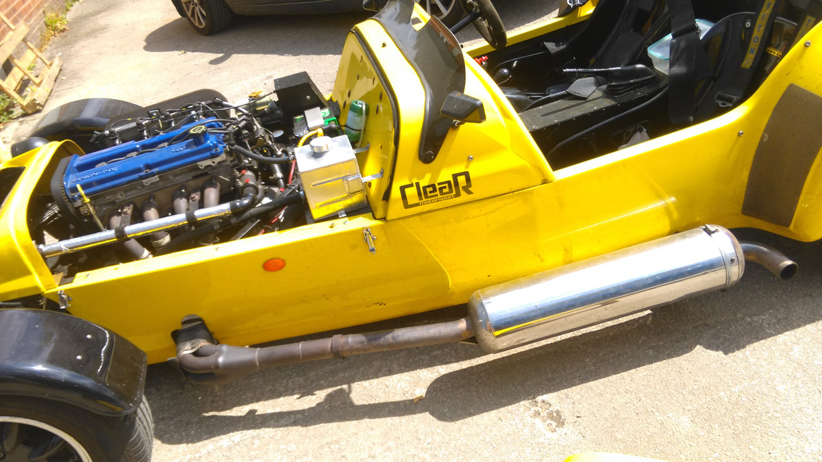

- Includes RS2000 alloy bellhousing, all water pipework, almost new Polo rad, engine mounts, starter and heatshield (never has the 'hot start problem' that a lot of Zetecs do), alternator, spare oil filter, clutch cable and throttle cable for top mounted pedals, and any other bits I can think of or find when I pull the engine out that won't be any use for the BEC conversion.

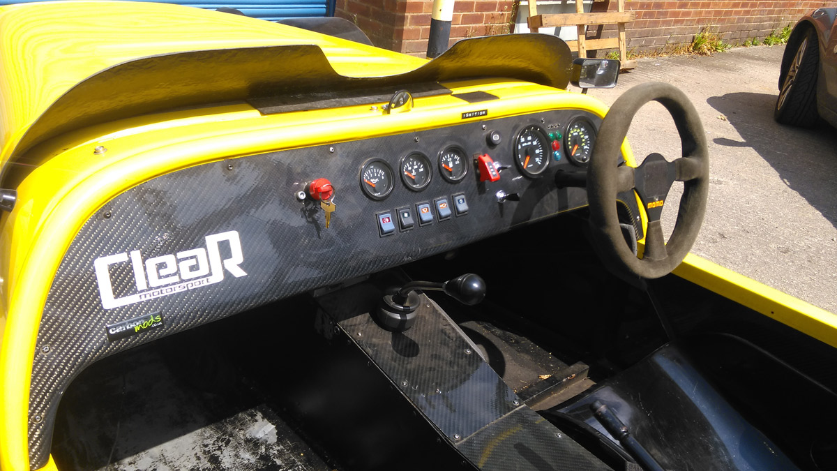

- I will also include the manifold, dash, all gauges / sensors, etc. This will truly make it 'plug and play' in a wide bodied Westfield, saving you a heck of a lot of effort and time! I reckon you could easily have this in your car and running perfectly within a weekend.
