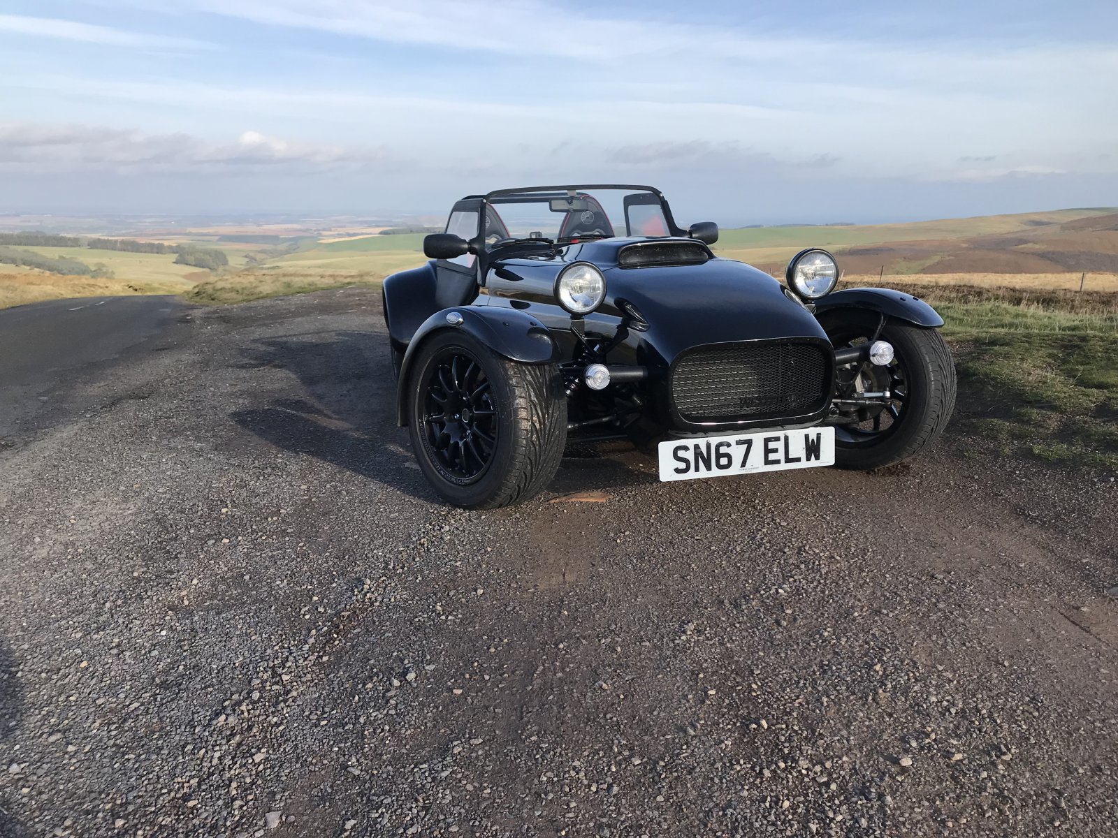

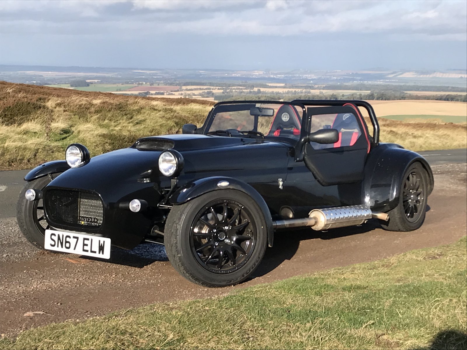

Evening all, I’m looking for some advice please. I competed my build of a fw special addition back in August and got it on the road for September. It was a complete new kit all Westfield supplied parts. I’ve got two issues.
Firstly I’ve got a bad oil leak and the oil is dripping down and out of the bell housing. I’ve spoken to mark who has advised me to check the sump bolts as it could be leaking from the rear of the sump. Cant say I’m pleased about having to work on one of the very few areas the factory put together. The other is the clutch is slipping quite badly. I originally though this was down to the oil but Mark assured me this wouldn’t be the case. I’ve tried giving my self more free play on the clutch and have even used a shorter stop bolt for the clutch peddle to give me more travel but it still slips. If I loosen it off any more I can’t get it to gear.

First of all your car looks fantastic.
