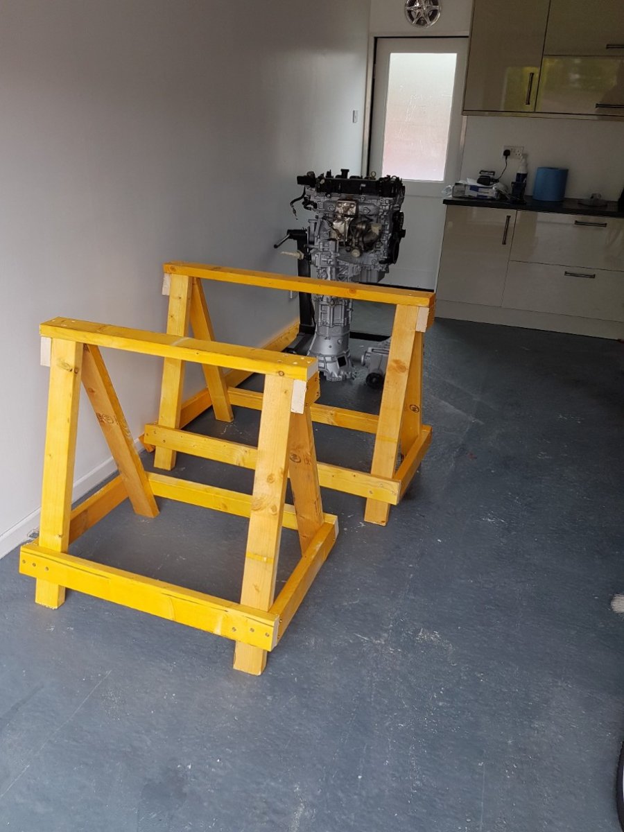

Thrustyjust Posted June 10, 2017 Posted June 10, 2017 I did most of the build like this Then dropped to the floor and used some of the 4 X 2 to support the width of the floors and chiselled slots to lock the axle stands in there, but it was so much easier building as far as I could on the stand with castors. My loft hatch is above the car, so had to wheel outside to be able to get the next box of bots out, but also meant I could push it away from the back wall, to do things that side. Quote
BugMan Posted June 10, 2017 Author Posted June 10, 2017 6 minutes ago, Thrustyjust said: I did most of the build like this Then dropped to the floor and used some of the 4 X 2 to support the width of the floors and chiselled slots to lock the axle stands in there, but it was so much easier building as far as I could on the stand with castors. My loft hatch is above the car, so had to wheel outside to be able to get the next box of bots out, but also meant I could push it away from the back wall, to do things that side. I like that idea, like you say you could move the build around a bit easier to give access Quote

Steve (sdh2903) Posted June 10, 2017 Posted June 10, 2017 1 hour ago, BugMan said: I like that idea, like you say you could move the build around a bit easier to give access Getting the car up to a decent height is really beneficial. If in a small garage being able to move around is a huge bonus. I just knocked up a couple of tressles for about 20 quid and were a godsend. Quote

Alan Cutler (Adge) - Dorset AO Posted June 27, 2017 Posted June 27, 2017 Finding wooden stands are useful. Lowered mine 3 times (quick and easy with a band saw) as build has progressed. Have got as far as first firing of the engine on them. Currently aiming to fit body with car on them. You can even use them to keep warm when you finish, assuming you've got an open fire or log burner! Eco friendly or what! Quote
