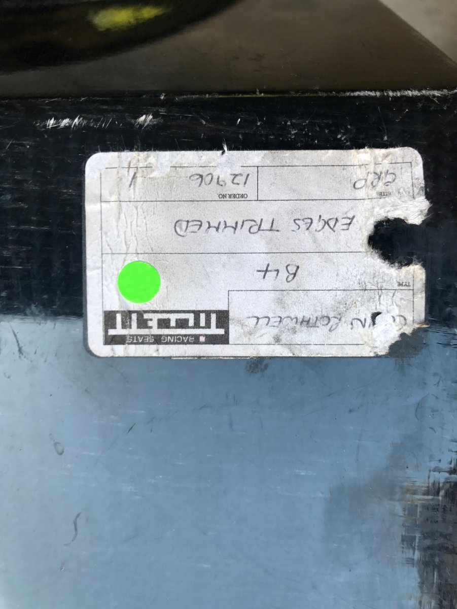

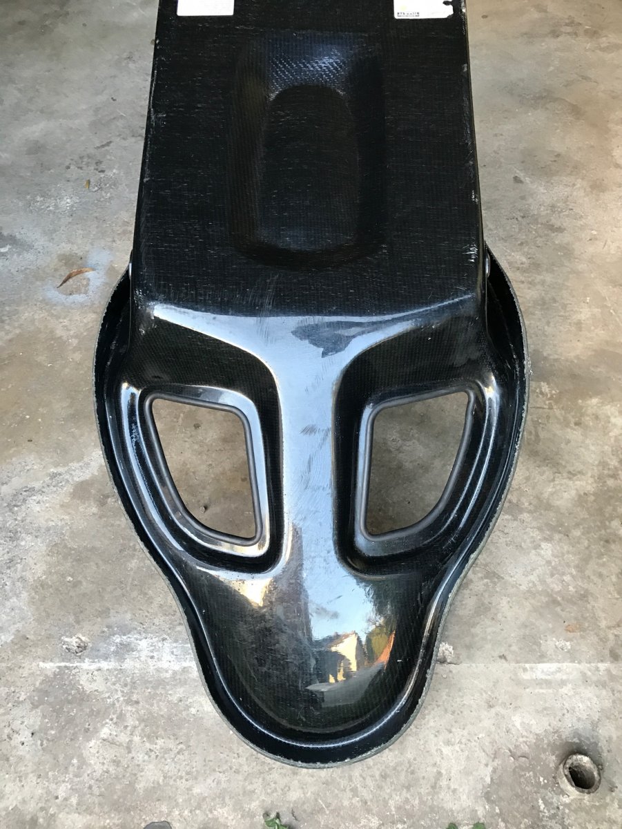

Used Tillett B4 GRP seat with trimmed edges (40cm version).

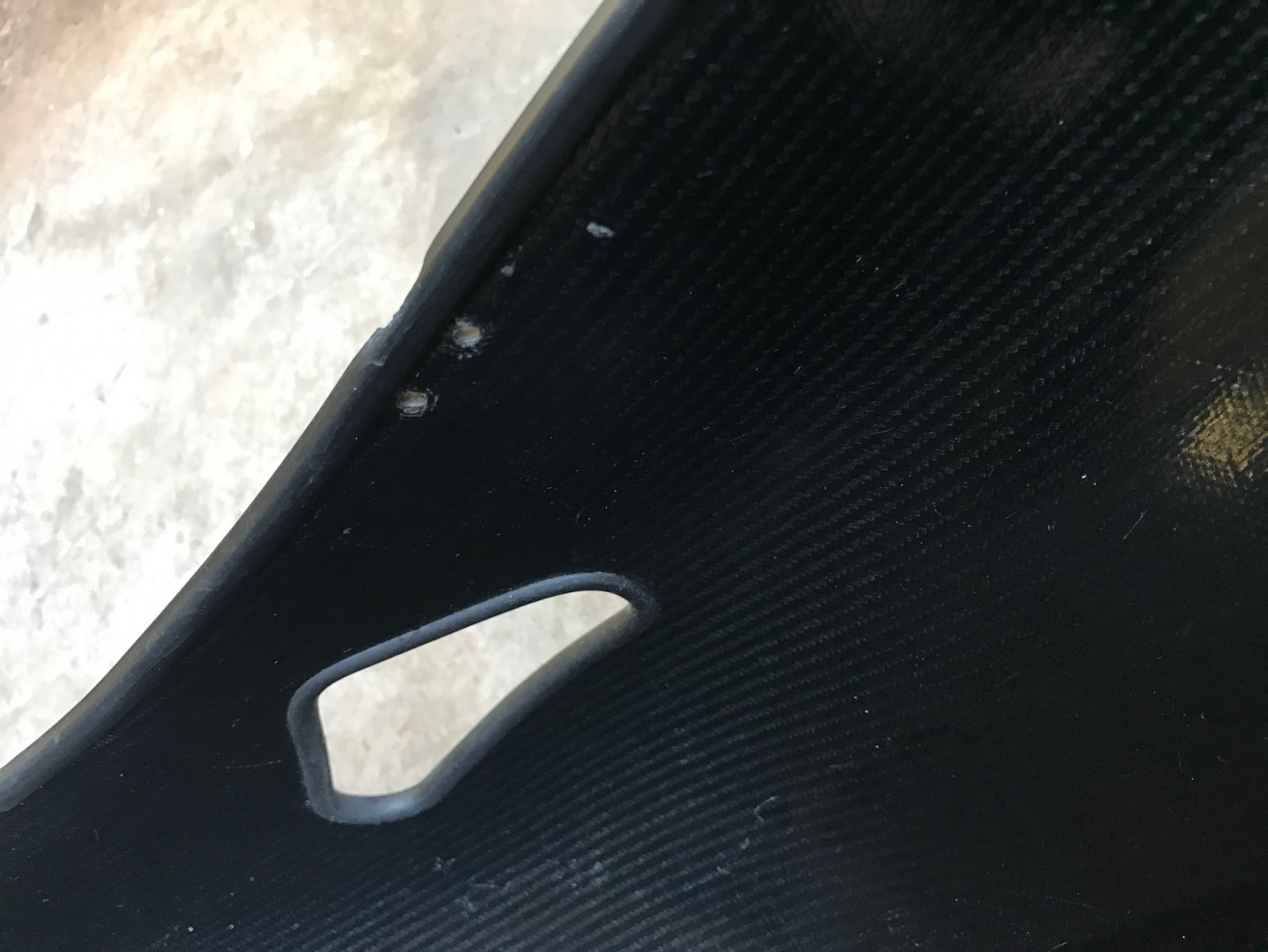

Used Condition with some wear and tear - see photos. It has a few scratches on it, and unfortunately scratches show white on this seat so they are visible.  There are also a couple of small holes drilled in the left hand side, close to your left knee.
