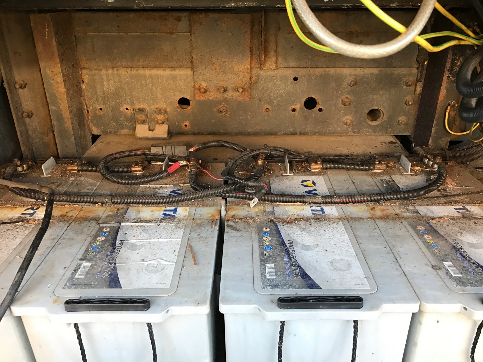

Guys I am just finishing converting a 7.5t daf 45 into a transporter/motorhome. It was an ex council mobile office so had 4 very large 12v batteries linked in parallel and in sequence (I think that is what it is called), in it to supply mobile 24v and 240v power via an inverter.
Looking through old docs it would seem they upgraded from a honda generator as a power source. Aparently they spent over £3K converting the power source!!
My issue is it had been sat for several months minimum, with no use so I have found it doesn't hold 24v charge very well. I have taken them out and charged them individually, 1 holds a constant 13+v after a week, 1 drops to just under 12v, 1 under 9v after about 24hrs, the other will not charge at all (literally 0.00V !!) So my thoughts are 2 dead 2ok. The local supplier wants £270 each battery!! I know I can get them slightly cheaper on the bay of E, however living on an island couriers are funny about bringing batteries over on the ferries.

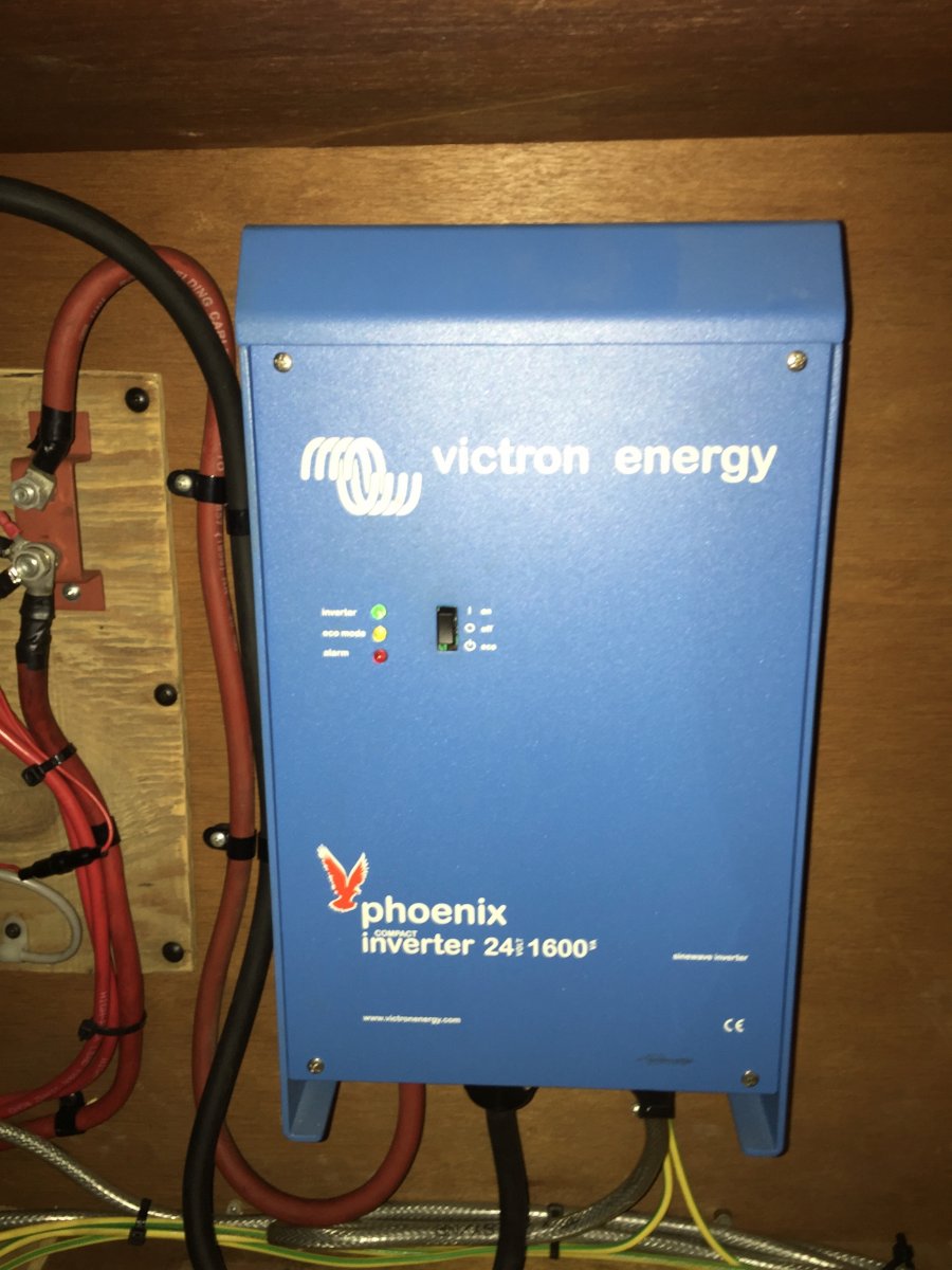

Would  it be ok only running 2 rather than 4 batteries?
What sort of usage could i get out of them?
Inside the van i have a microwave/double hob/kettle/toaster that would need to draw 240V power from them through the evening. A 24v winch for getting the car in the garage area. I have a small generator that would be able to supply sufficient power during the day.

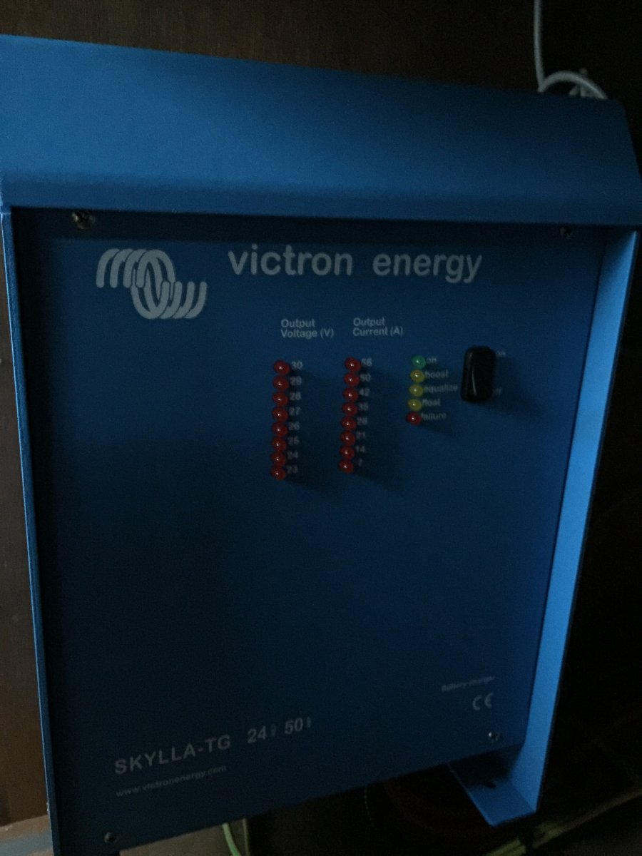

Only 2 batteries running an inverter with those high current appliances are not going to last long. It also seems like it doesn't charge from the vehicle when running so I think a mains hook up at the circuits would be necessary especially for a weekend. Reading the instructions it would appear that it needed charging daily from the mains even with 4 batteries.
The best way is to connect the two good batteries that you have and give it a go at least then you will have a good idea what you can run and for how long before going on your first trip or buying new batteries.

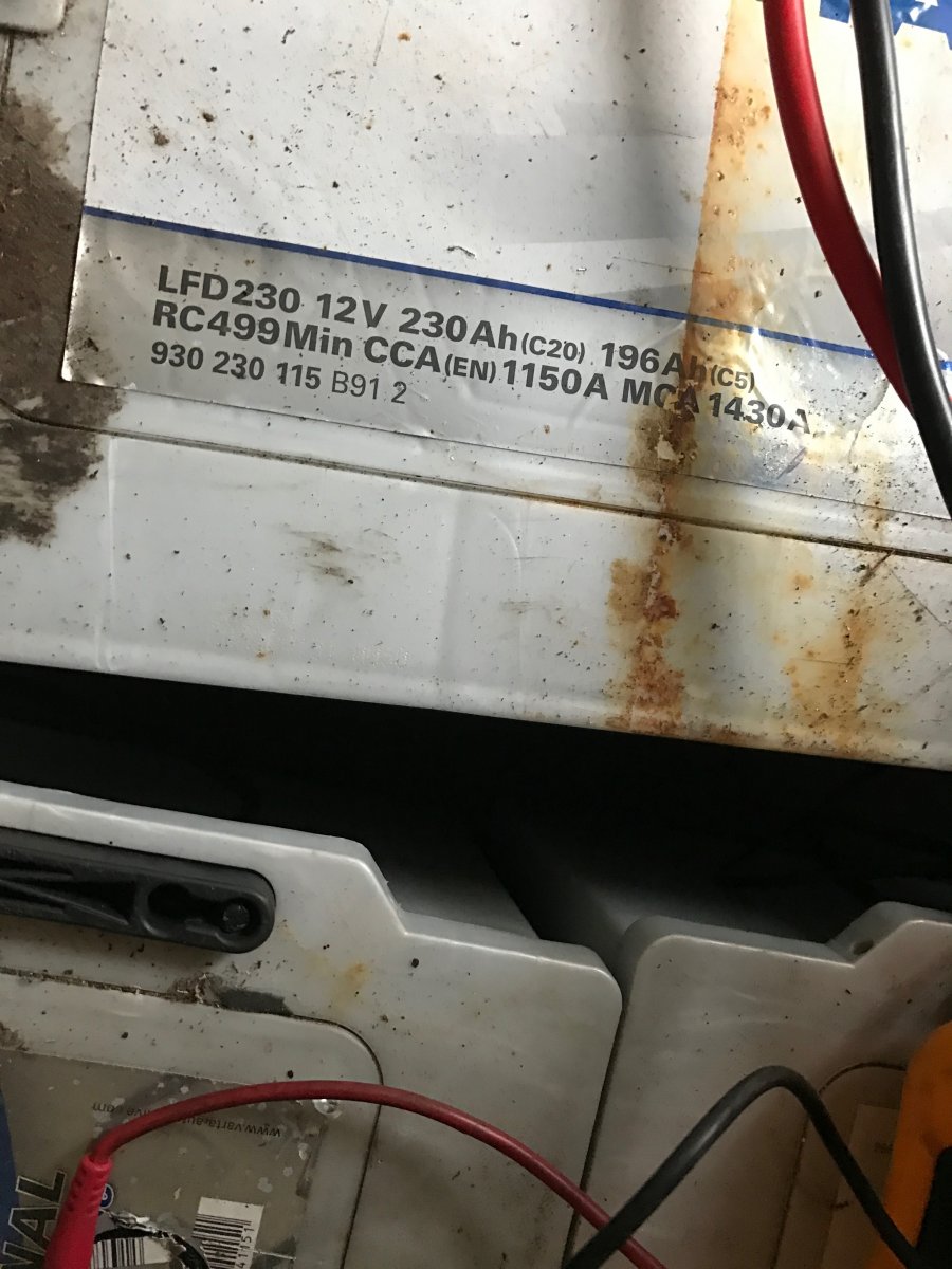

You can make a (very) rough estimate on what you might get out of just two battieries from the ratings. 240Ah x 2 @ 12V gives 5760Wh. Allowing for efficiencies and losses, I'd take a stab at best case 4kWh.
from your description, no problem running on just 2 batteries assuming you wire them in series. FWIW I never like to see batteries in parrallel, just feels wrong to me as they are never identical so one will always be propping the other one up to some extent. Same can be said for series as far as the current goes but a battery is just cells in series so you can't avoid that.

Hi Lee,
Just to avoid confusion, having the 12V batteries in series (+ve to -ve) adds their voltage giving you the 24V (say 100Ah @ 24V), by having them wired in parallel (+ve to +ve and -ve to -ve) you add their capacity (say 200ah @ 12V). By doing both with 4 batteries, you get a 24V battery with double the capacity of one battery. 200Ah @ 24V. The inverter is 24V so as a minimum, you need two 12V batteries connected in series to get you that. If it worked out cheaper, you could get 4 smaller capacity batteries and repeat the series/parallel configuration. Just because I don't like connecting them in parallel doesn't mean it isn't standard practice :)
