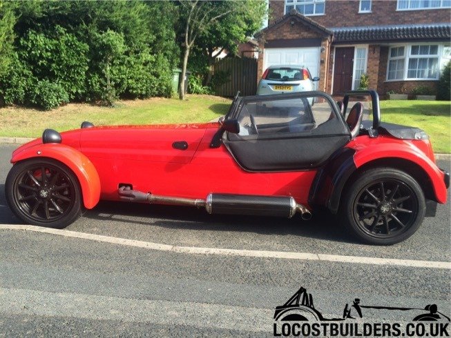

RMarine (Paul) Posted January 8, 2017 Author Posted January 8, 2017 19 hours ago, Dave (OnliestSmeg) - Joint Manchester AO said: What roll over bar do you have? Mine didn't require frame when I had RAC rop.  hi im not sure, so i have attached a few pic of it ThanksÂ
Onliest Smeg David Posted January 8, 2017 Posted January 8, 2017 That's what's known as a JAP bar and you'll definitely require a frame to fit hood.
Dave Eastwood (Gadgetman) - Club Chairman Posted January 8, 2017 Posted January 8, 2017 That's the standard later style, (sometimes known as JAP) roll bar. You need a frame for the hood, with that one. Though to be honest, when it tried a hood without a frame on my old RAC bar, I hated it, not enough head room, and the back looked a pigs ear, from the outside. But I guess I'm quite long backed, and do tend to use the car with the hood up quite a bit...
