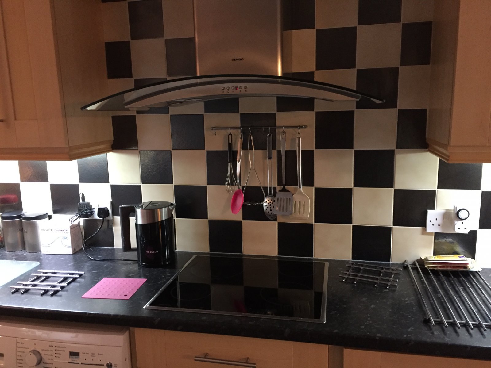

anyone know how close is too close for a set of sockets next to a cooker in a kitchen?
I put these in about 10 years ago. Not aware of any regs around distance but you don't want trailing leads over the stove etc
As stated 300mm from the edge & 150mm above the worktop.
'shuffles into kitchen with tape measure and checks socket near cooker which I fitted 5 years ago and gives a sigh of relief' ........................

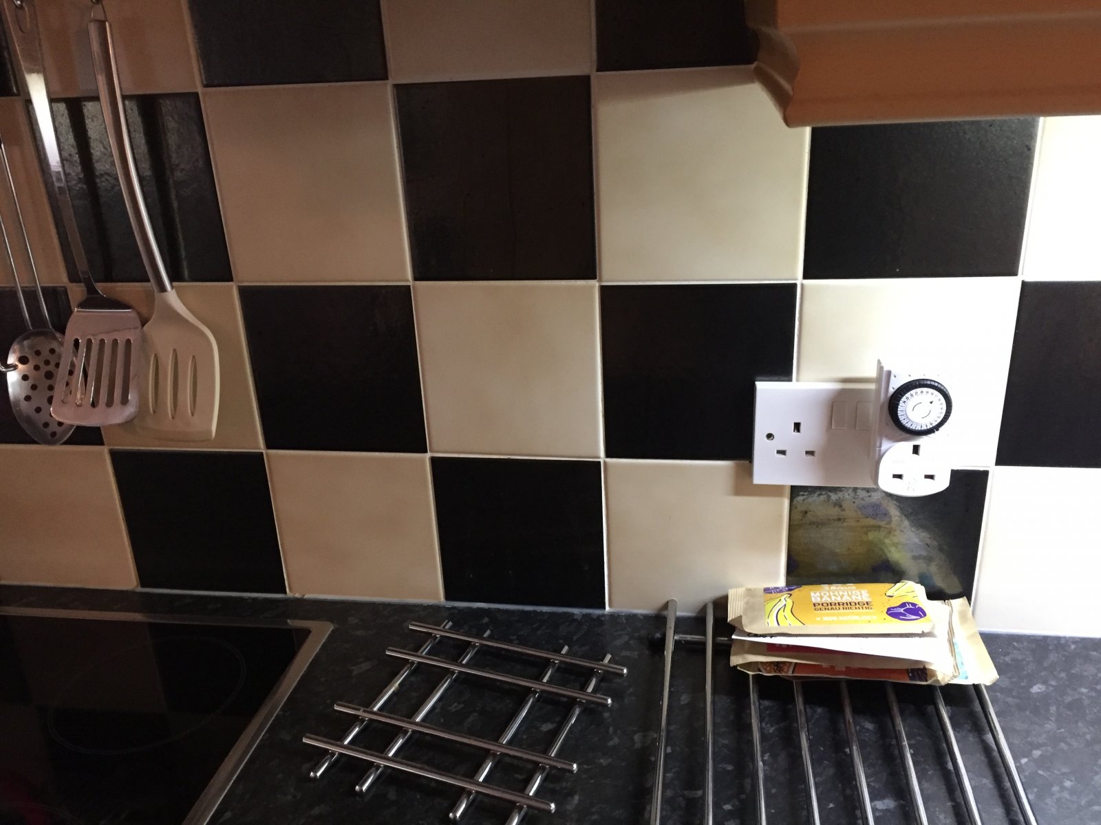

thanks, I think ill just be outside the 100mm measurement in that article but its close. there is little chance of any trailing wires as the worktop is only 20cm anyway before the wall. the plug was obviously moved sideways at some point from above the previous cooker.
