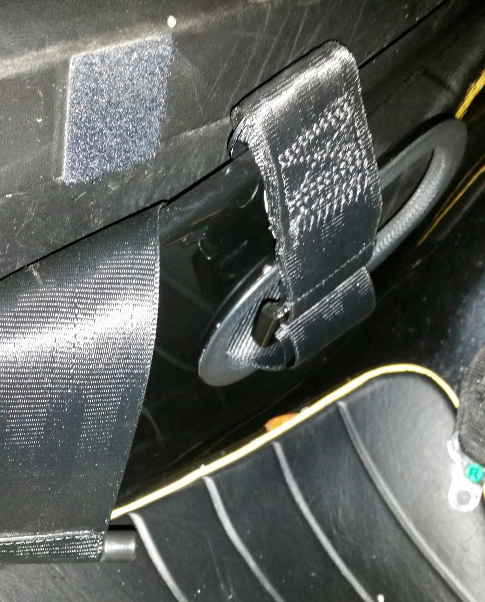

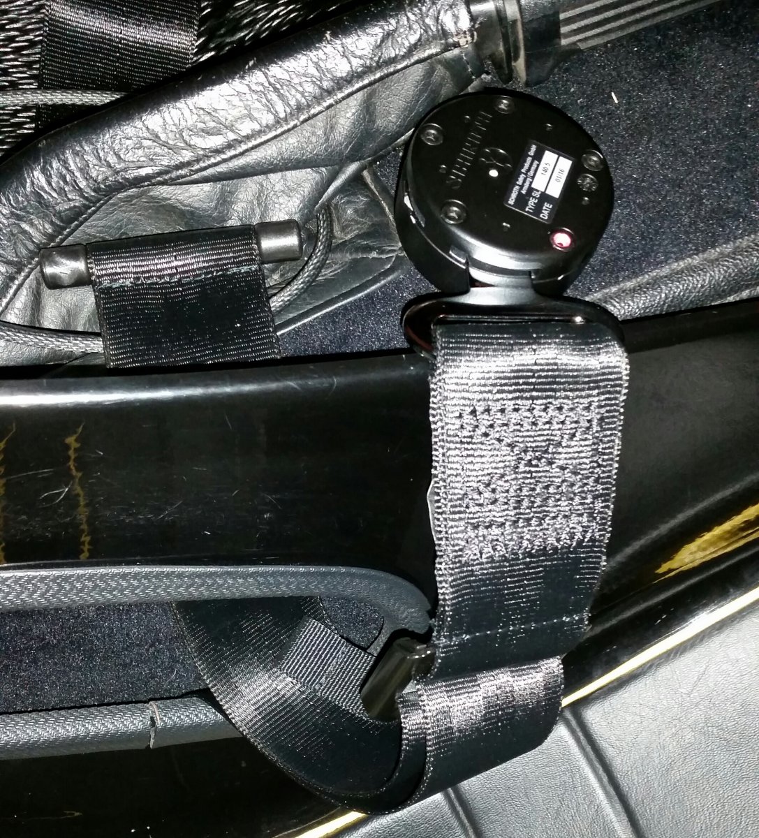

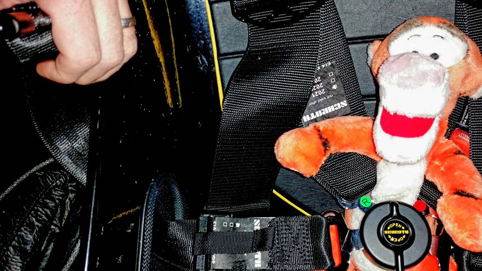

Here's me tightening tiggers harness.
Note loose end through hole in seat side turning it into pull up set up rather than pull down...2017-01-03_15_29_41.jpg
Buckle has plenty of adjustment to lengthen so rest on centre and over side.
Here they are waiting for me to clamber in....20170103_154532-1.jpg 20170103_154515-1.jpg
(n.b. may not be as much adjustability with seat far forward, but some chasis have two sets of mounting bolts {Pandas} which would enable mounting lower harness bolts further forward.)
