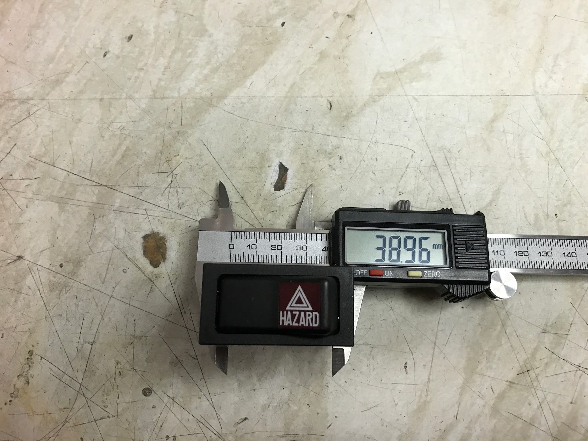

This is the Switch they've used for the past fifteen/twenty odd years:
It looks in reasonably good condition, if you want it, just drop me a pm with where to send it and I'll stick it in a Jiffy bag for you.
It's a Britax supplied (SWF badged) part number 511.190 with the hazard symbol uncoiled and turned through ninety degrees to suit the Westfield mounting. if you want to try and source a new one.
