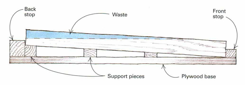

Also how would I go about tapering the wood? I was thinking about using sacrificial planks on each side of the wood set at the taper I required and then putting them through a thicknesser like such...

I think this might work for tapering using a thicknesser?
Tapering the timber is the easy bit! I would do it exactly as you have suggested, as long as your thickneser is man enough with a long enough bed.
