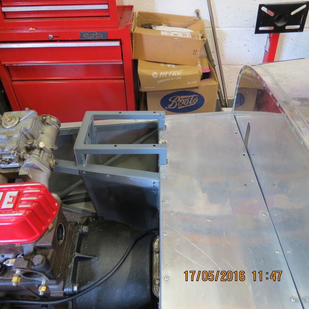

Hi All,
Does anybody recognise which pedal box my 1986 pre lit chassis was designed to take?
westfield%20june%2016%20019_zpsj5ygfzkp.
I have a 'standard' Westfield pedal box, but that is designed to fit on the bulkhead between the scuttle and the 'frame' that is there to accept the correct peddal box. I can't fit the standard pedals as there is a diagonal chassis member where it should fit.
Any suggestions appreciated, but I might need to go floor mounted.
Cheers
Gary
I believe it maybe ford escort with a modded and rewelded clutch pedal. You will need a ford cortina mk3 master cylinder to bolt to it too. I am 100 % on the master cylinder but I am sure I am hopefully correct on the pedals.
Thanks, sounds a likely culprit.
Regards
Gary
Early post-lit cars used a modified mk1 Escort pedal box. Likely that the pre-lit is too.
Jen
Thanks, off to ebay now.
Gary
