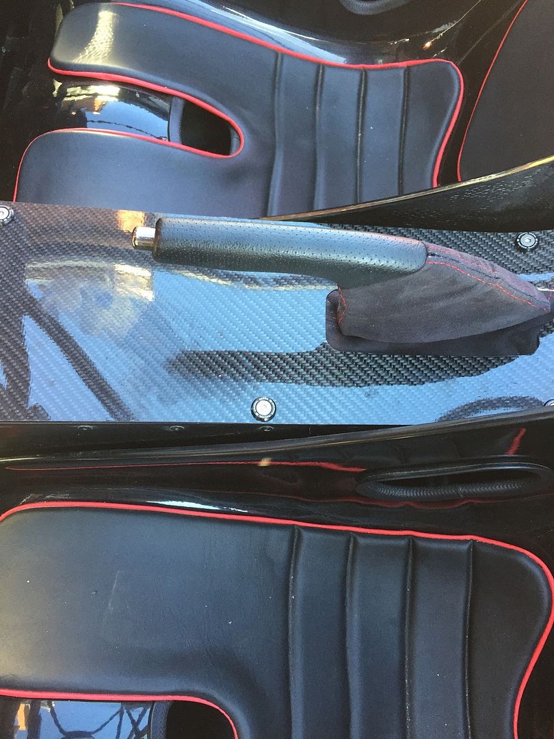

This is how I had it for IVA it's just WF handbrake surround wrapped with vinyl.
3B0D9FCC-0C15-4A49-B647-ABE72EDB1209_zps
This is how it is now I just glued it to the bottom of the top then glued a rubber gaiter over that.
0E634C59-BC0E-4324-95C6-BCAFF8BBAB3C_zps
A724B9C3-F3B6-41A1-A596-91F4BE6F28EC_zps

thanks Andy, looks a neat solution, i cant find the gator on the westfield web site but i can see the ring that you used in the first IVA photo, i am wanting to make an invisible fixing so will probably need to take the tunnel top of again anyway, my cars a 2000 model so the handbrake leaver looks a little different

Yep I would wait for Stoneliegh to get some ideas, the cloth gaiters came of eBay which I took s punt on I had the rubber bit of WF.
You won't see many handbrakes like mine as I swapped it to the s2000 one I had.
