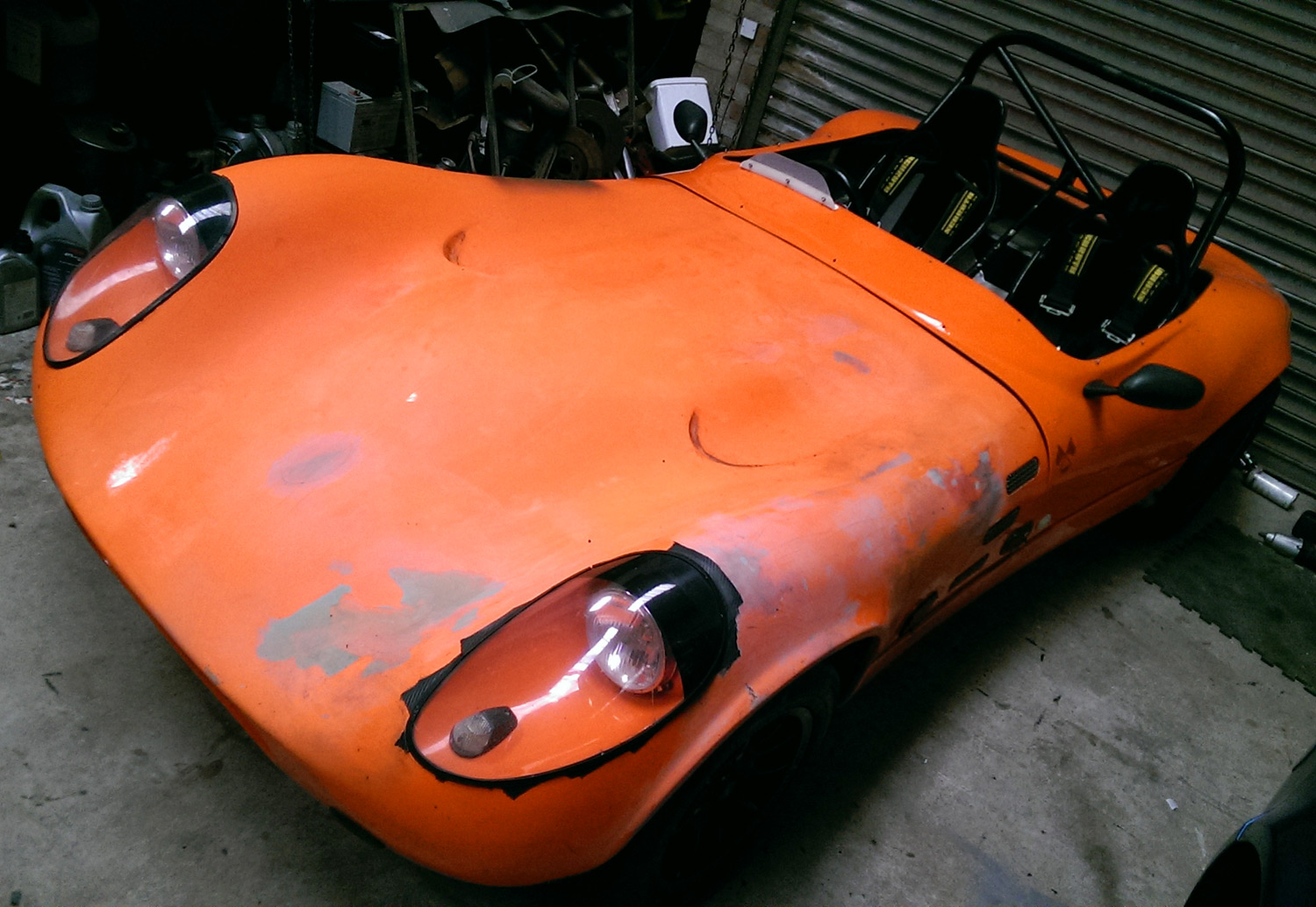

My latest project has a very battered bonnet. So much so that one of the previous owners decided to wrap it in fake carbon :barf:
Upon removing this, there are numerous and extensive spider cracks in the gel coat, and a few areas where these have been 'repaired' - however the filler hasn't gone off, so I am assuming it was mixed up short on hardener...

I think my first port of call on the soft filler would be cellulose thinners and a small wire brush to get it out of the cracks - usually works on uncured fillers.
Dig bad out with a dremmel and carbide burr creating a v deep enough to get rid of the crack.
Then rough up surrounding area and clean well with a solvent degreaser. Thoroughly dry.
Apply flowcoat  / gelcoat repair and allow to harden.

Well, I had some Acetone so decided to give that a go - worked very well, although I feel a bit weird now after getting through nearly a litre of it, haha. Around 1/8 of the bonnet area had a thin layer of sticky grey filler smeared all over it, it's ended up a lot better than I thought.
The damage doesn't look too bad, with the tips above and the various guides from the forum I am sure I can make it look a lot more presentable :) Cheers again!
