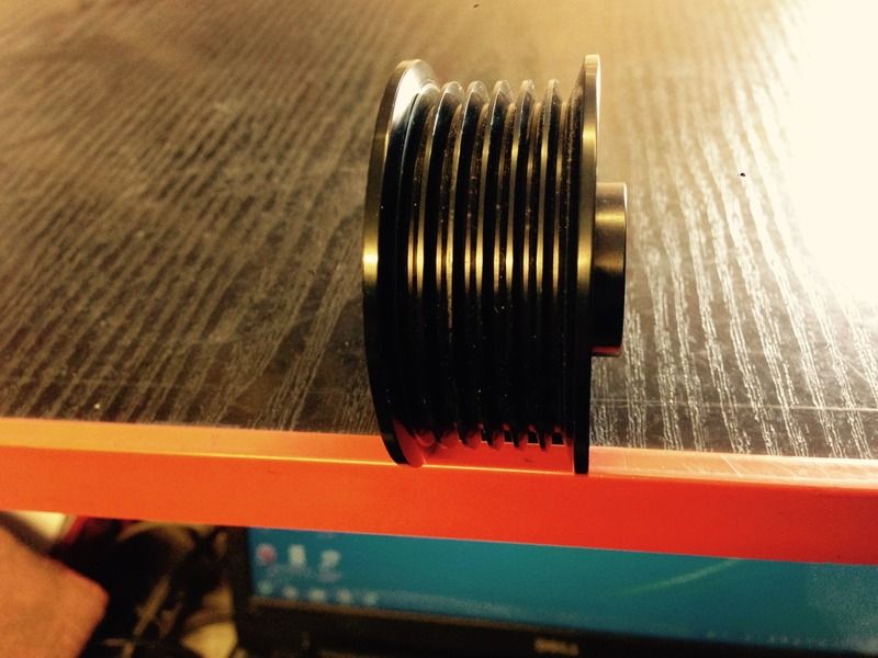

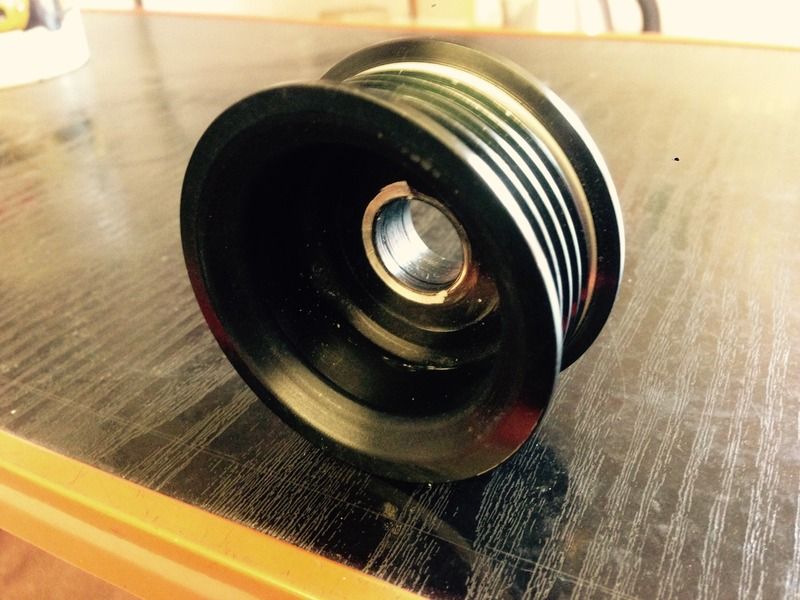

6 Rib Pulley to fit Denso 40amp Motorsport Alternator
As used briefly on the my 2.0L Blacktop Zetec, I say briefly as I only unpraded the alternator over winter and this was fitted at that time.
However it is very slightly to large  diameter for my set up and at idle was not turning the alternator fast enough to charge.
Light weight Alloy
6 Rib
53mm dia across the ribs
57mm dia across the outside
15/17mm shaft dia
£20 inc p&p
