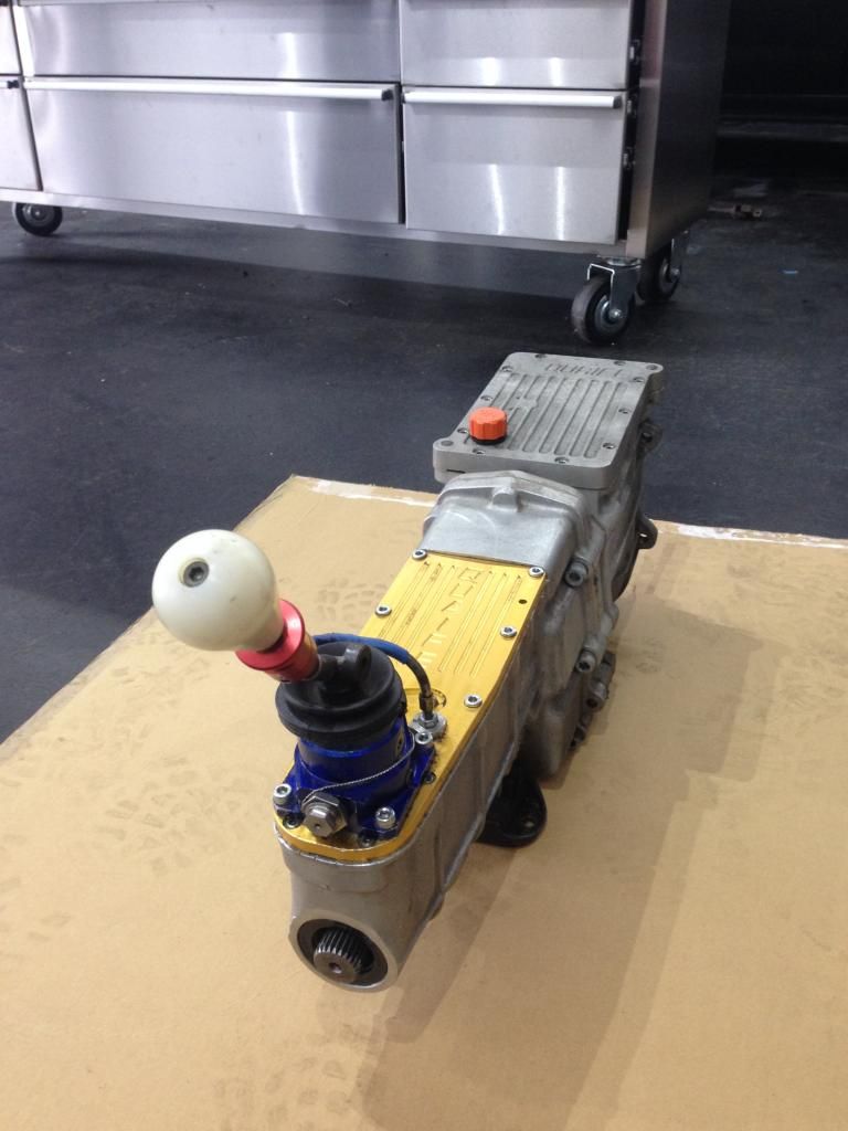

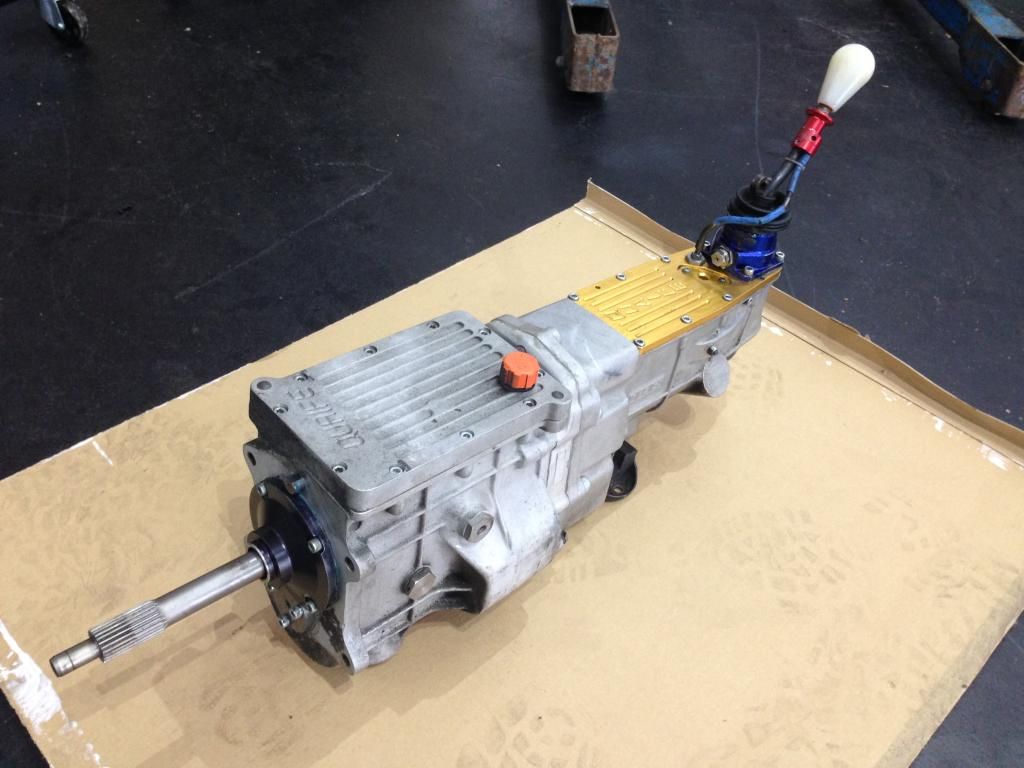

My six speed (plus reverse) sequential quaife box is up for grabs.  It's an earlyish model, not sure of the actually age but I've had it for about four years I think, last rebuilt a couple of years ago.  It's a dog engagement, semi helical setup so not noisy to use but good quick shifts.
This is a type 9 replacement so subject to lengths etc should be an easy adaption for that box.
AFAIK it's a 1:1 5th gear with overdrive 6th, I used to run it on a 3.9 diff but once I was on higher power it was topping out at about 125 at a lot of tracks so I moved to a 3.3.
It's been run on Redline Lightweight Shockproof oil, lever has the crank on it so fits nicely in a seven.

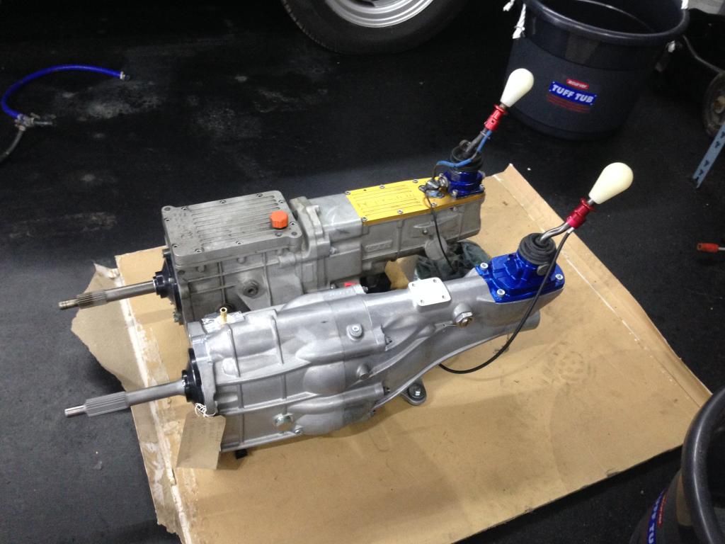

This is the new and the old together -
