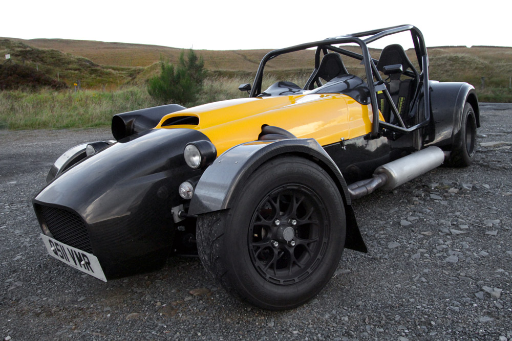

12 x 3 looks good and never any bother with police or MOT testers even though I take the full size one with me for testing.
Standard letter size with plate cut back to the minimum distance allowable to lettering.
Amazing how much smaller than full size plate that is.

Stick on nose cone, looks to me to be 100% size and font. No issues.
