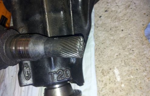

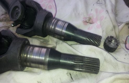

Dave Eastwood (Gadgetman) Posted January 22, 2014 Posted January 22, 2014 It's not just the UJ's there are a few photos knocking around the forum of the shaft itself wound up till it looks like a corkscrew! It's the main reason why owners started having them made, even when originals were still available.
wiggywoo Posted January 22, 2014 Author Posted January 22, 2014 It's not just the UJ's there are a few photos knocking around the forum of the shaft itself wound up till it looks like a corkscrew! It's the main reason why owners started having them made, even when originals were still available. Yes I've allready done that till they twisted and snaped in half made a mess plus just missing chippo's head with flying debris. Had stronget tubes and now gone at the splines
