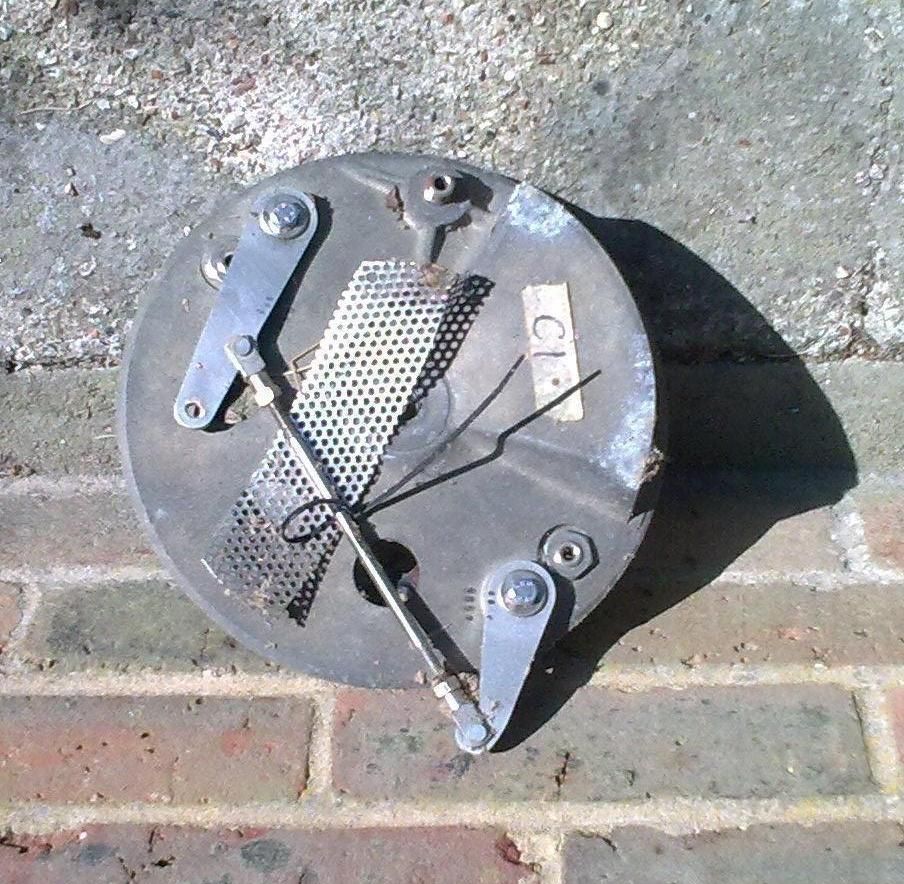

Man On The Clapham Omnibus Posted July 4, 2013 Posted July 4, 2013 The house I moved to last December was once owned by a vintage car enthusiast. He died about eighteen years ago and his house was sold to his live in lady friend. She, in turn, died last June and I bought the house from her executor. Naturally he doesn't know anything about the previous owner as he is only a recent friend of the dead lady and cannot answer any questions. At the bottom of the garden are two brick built outbuildings and in the roof space of one I found this brake assembly. The last but one owner had been a very keen Model T Ford enthusiast, but this brake is not from one of those as far as I can tell. It might even be from a motorcycle. The shoes are narrow (see top pic), and there's an air cooling duct with a mesh grille (loose and tied on with a cable tie at the moment. It is double leading shoe so probably a front brake. The Big Question today for the Westfield massive is what the Hell is this from? p.s. Better pictures to follow... Quote
Man On The Clapham Omnibus Posted July 4, 2013 Author Posted July 4, 2013 I must say that's my gut feeling. Circa 1955 I would guess and from big machine of that era. There my knowledge ends, sadly. Quote
Mark (smokey mow) Posted July 4, 2013 Posted July 4, 2013 Agreed with above it's from a bike. I happen to have the Haynes manual in front of me for the Triumph T100/ 5TA which it looks very similar too in design but isn't? Quote
Howard Posted July 4, 2013 Posted July 4, 2013 Ceriani four leading shoe brake. Used on a variety of Italian bikes 60s onwards plus some classic British racers. Link added. http://www.manx.co.uk/products/hubs/c230f.htm Quote
Pantherman Posted July 4, 2013 Posted July 4, 2013 I would say its from a 50's bike possibly Norton , could be an aftermarket one something like a John tickle ( he's on the forum ! ) if it is it will be stamped. The twin leader fittings don't look original ,hard to tell but could be a single leading brake plate converted to twin leader. Sorry no real help I know ! Quote
Man On The Clapham Omnibus Posted July 4, 2013 Author Posted July 4, 2013 Well I'm astounded! It looks as if Howard is right - that's precisely what it looks like if a bit tarnished. The shoes are new, and the whole thing looks unused too and is only lacking a spring. Thanks all for the input. Now, any suggestions as to how I can use it on a Westfield? A little Googling shows it is half of the final product and minus the drum, of course. I don't know whether it's a replica, but I would guess so. What was a Model T enthusiast doing with an exotic Italian brake assembly, I wonder? Quote

Howard Posted July 4, 2013 Posted July 4, 2013 Bit more background if the link works: http://www.laverdaclub.nl/italdoc/Laverda/cerianibrakes/Index.html Looking at prices of parts it might be worth a bob or two even though not a complete hub. Quote
Man On The Clapham Omnibus Posted July 5, 2013 Author Posted July 5, 2013 Norman, Howard, it may well have some value - I'll be at the Kop Hill Climb in September and there's a fair few vintage bikes there usually. Maybe someone there could use it. Failing that I need to do some research on its worth. Thanks all for the input, and the amazingly quick return of an answer Howard. Quote
