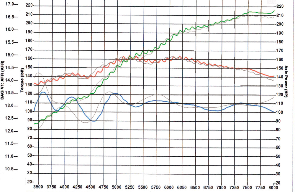

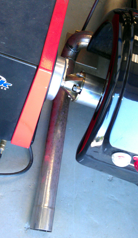

AdamR Posted June 4, 2013 Author Share Posted June 4, 2013 Bit of an update, part 2 of the transformation has now been completed The first session in March was to make the car safe at full chat (it had previously been too lean), which was successful, but Richard and Fraser weren't happy to leave it at that. So, I popped back this morning to run through the rest of the map and see if the dry sump system I'd fitted recently had freed up any power. The theory is that because the crankcase runs in a slight vacuum (two stages of the pump 'scavenging' from the engine but only one pushing oil back in), the windage losses from the crank hitting the air and oil froth in there are reduced, so the car can make a bit more power. Naturally we left the power runs to the end Last time I managed to melt their floor paint and a rear arch had to be removed to get the car hooked up However, they have since made an exhaust outlet and some huge hub adaptors - top stuff! So - onto the mapping. It turned out the fuelling was a bit ropey mid-range and on part throttle, with some areas too lean and others too rich! But, after some adjustments (made easy by the Dynapack being able to hold the car at a steady rpm while the throttle was opened in stages) the AFR was corrected throughout and a bit of pinking / detonation at high throttle and low revs removed. This should improve driveability / smoothness and fuel economy, too. The torque plot is certainly smoother now which I was chuffed with! A couple of runs with the car held at full throttle at 6500, 7000 and 7500rpm were done too - bl**dy scary watching that - to ensure the mapping was spot on at these commonly-used, high-stress areas. Finally, we did a couple of power runs, Richard tweaking away between each one to fine tune the AFR. Turns out peak power was up 6bhp at the rear hubs, and this sort of gain was pretty consistent from 6k upwards Nothing like the crazy gains some people claim from dry sumps (I've seen 20bhp!) but as a side effect of a better oil system I'll take that! I'll scan the graphs and pop them up later for anyone interested Quote Link to comment Share on other sites More sharing options...
FILFAN Posted June 4, 2013 Share Posted June 4, 2013 thats about 5% increase and nothing to sniff at all good sorry to sound smug though but when they first announced they had a dynapack i said straight away that they needed extensions to fit a westfield on due to the limited clearance as my car was tuned on one and ran into the same issues. never got any response Quote Link to comment Share on other sites More sharing options...
AdamR Posted June 4, 2013 Author Share Posted June 4, 2013 thats about 5% increase and nothing to sniff at all goodIt's a bit less than that for my car (up to 217bhp from 211bhp at the hubs), but still, all good as you said! Makes sense - maybe they were too busy dreaming up how to fix it, haha. Quote Link to comment Share on other sites More sharing options...

AdamR Posted June 5, 2013 Author Share Posted June 5, 2013 Managed to get the two graphs scanned in to compare, the greyed out lines are the 'before'... Quote Link to comment Share on other sites More sharing options...
