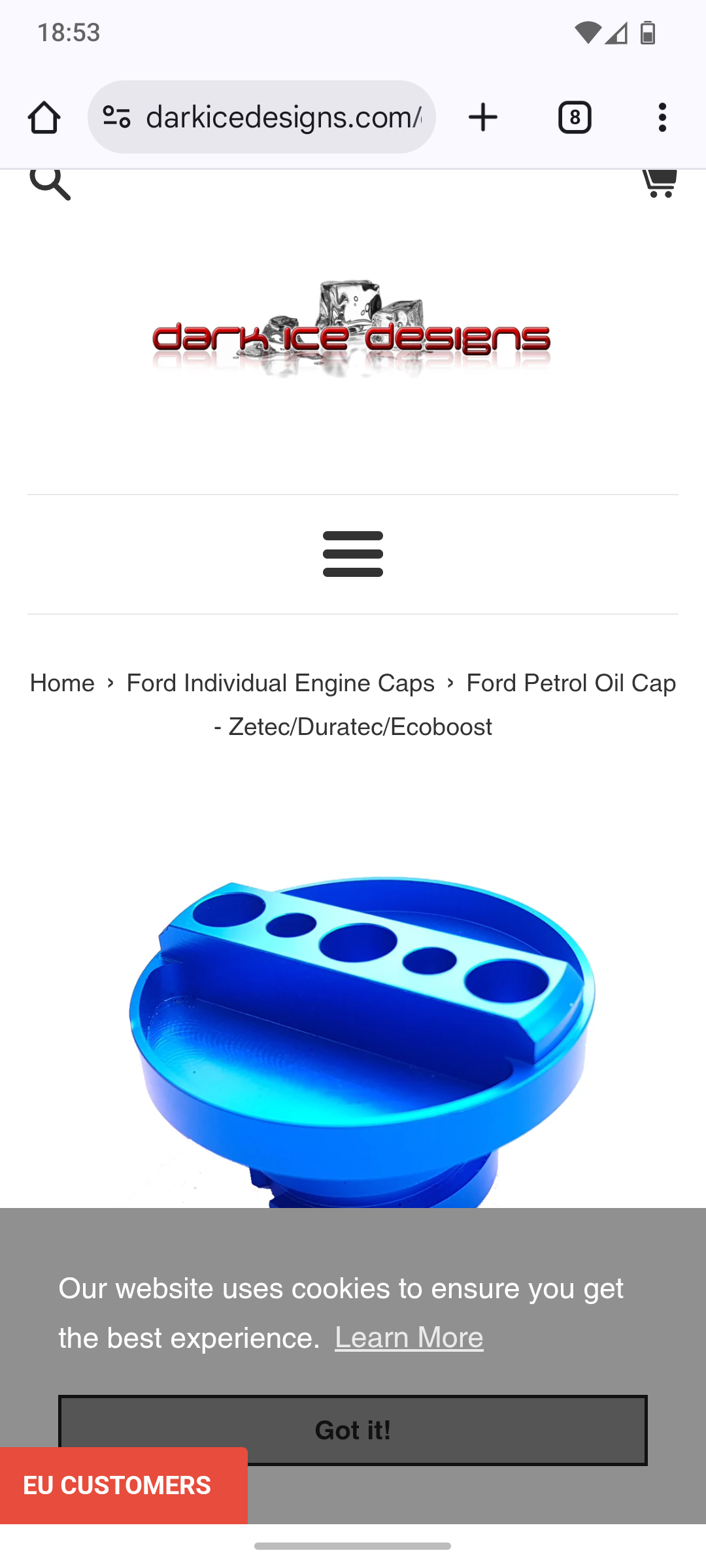

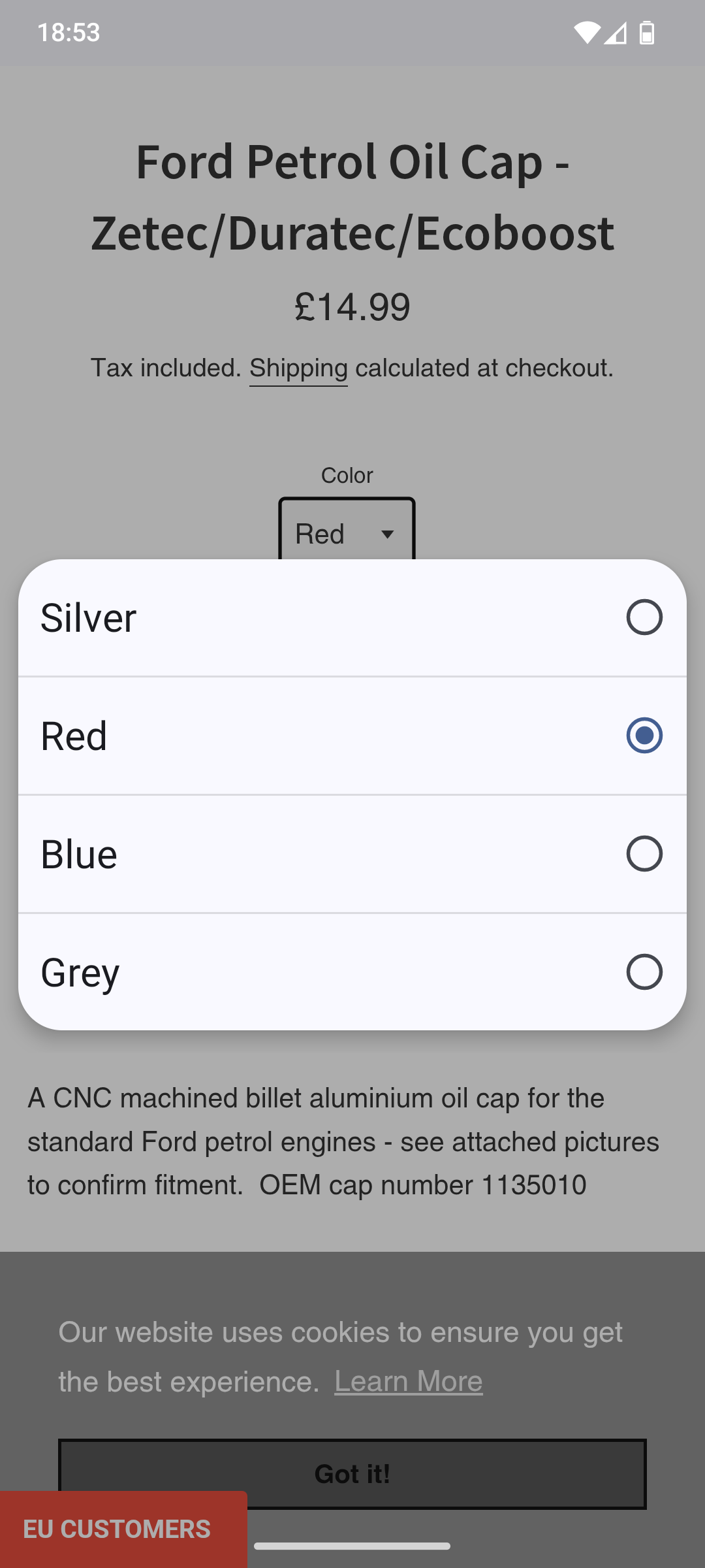

From this site, it's a perfect fit. https://darkicedesigns.com/collections/individual-engine-caps/products/ford-petrol-oil-cap-zetec-duratec-ecoboost-f-acc-099-102 -
