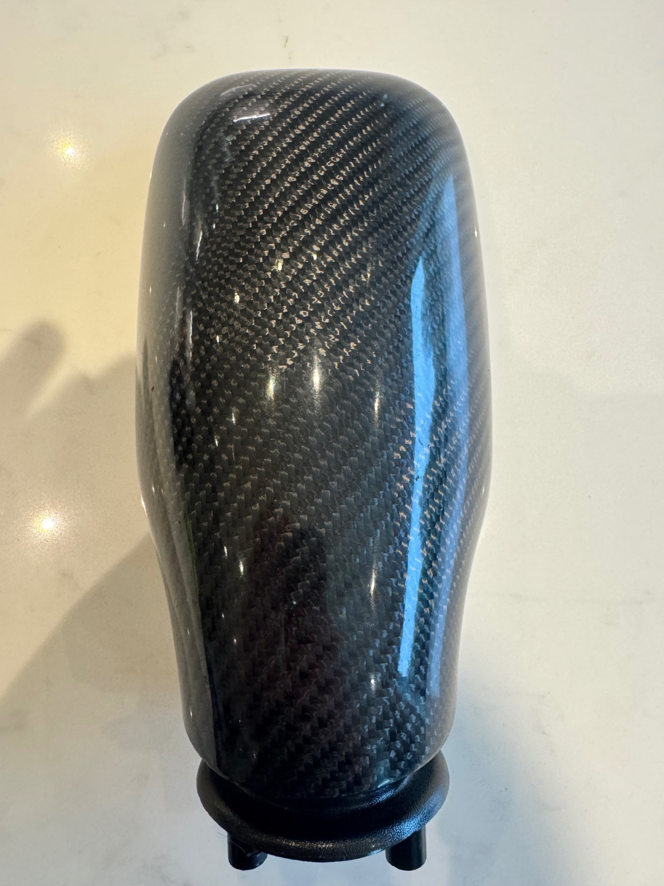

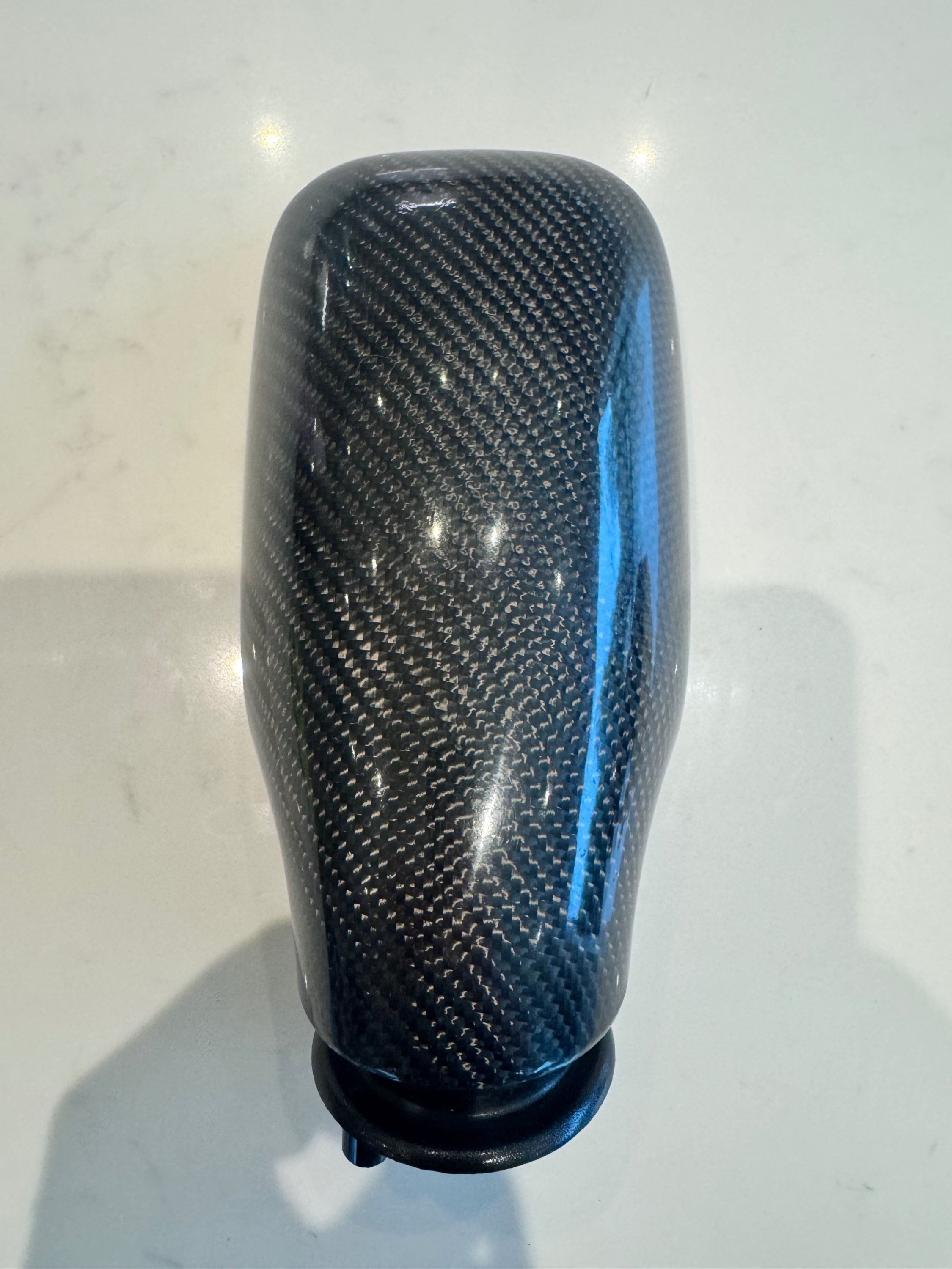

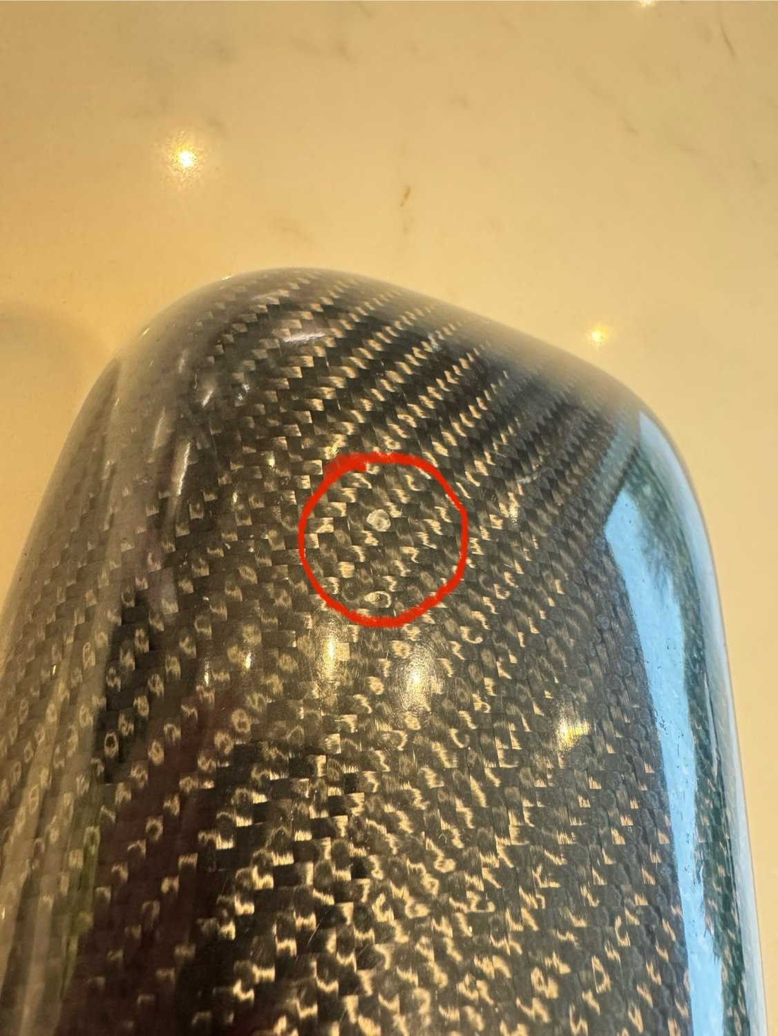

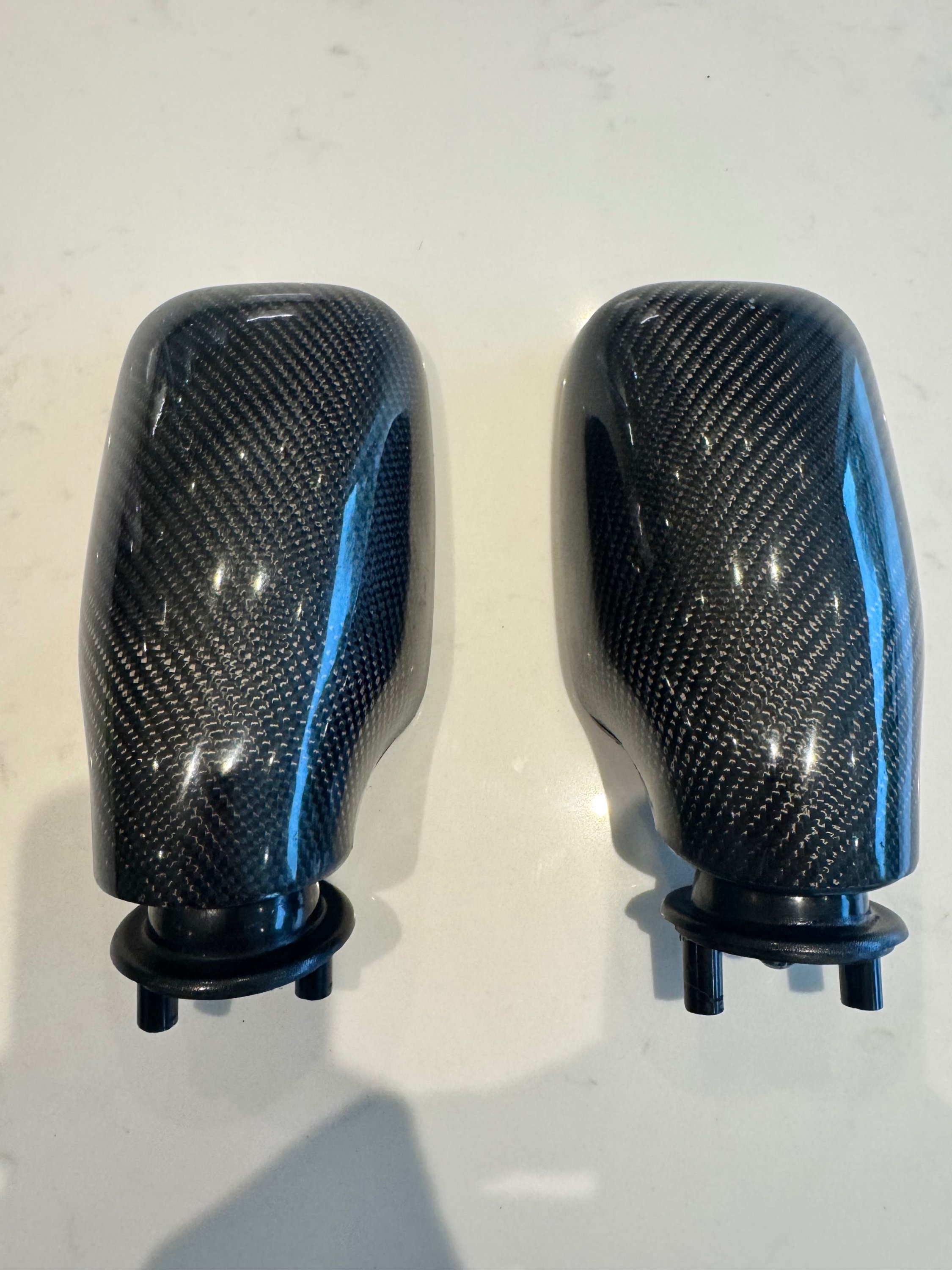

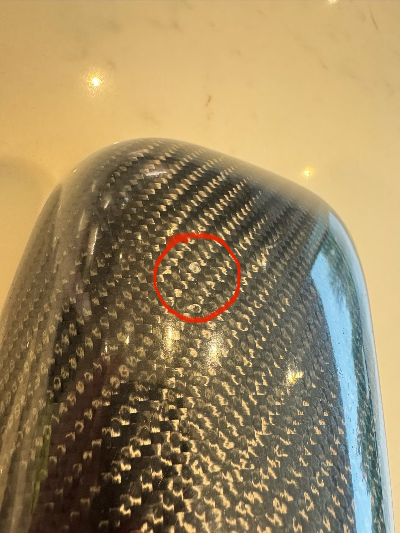

Selling ad I have recently fitted a full roll cage. There is a very small stone chip on one of the covers, I’ve tried my best to photograph. £75.00 ono inc postage.

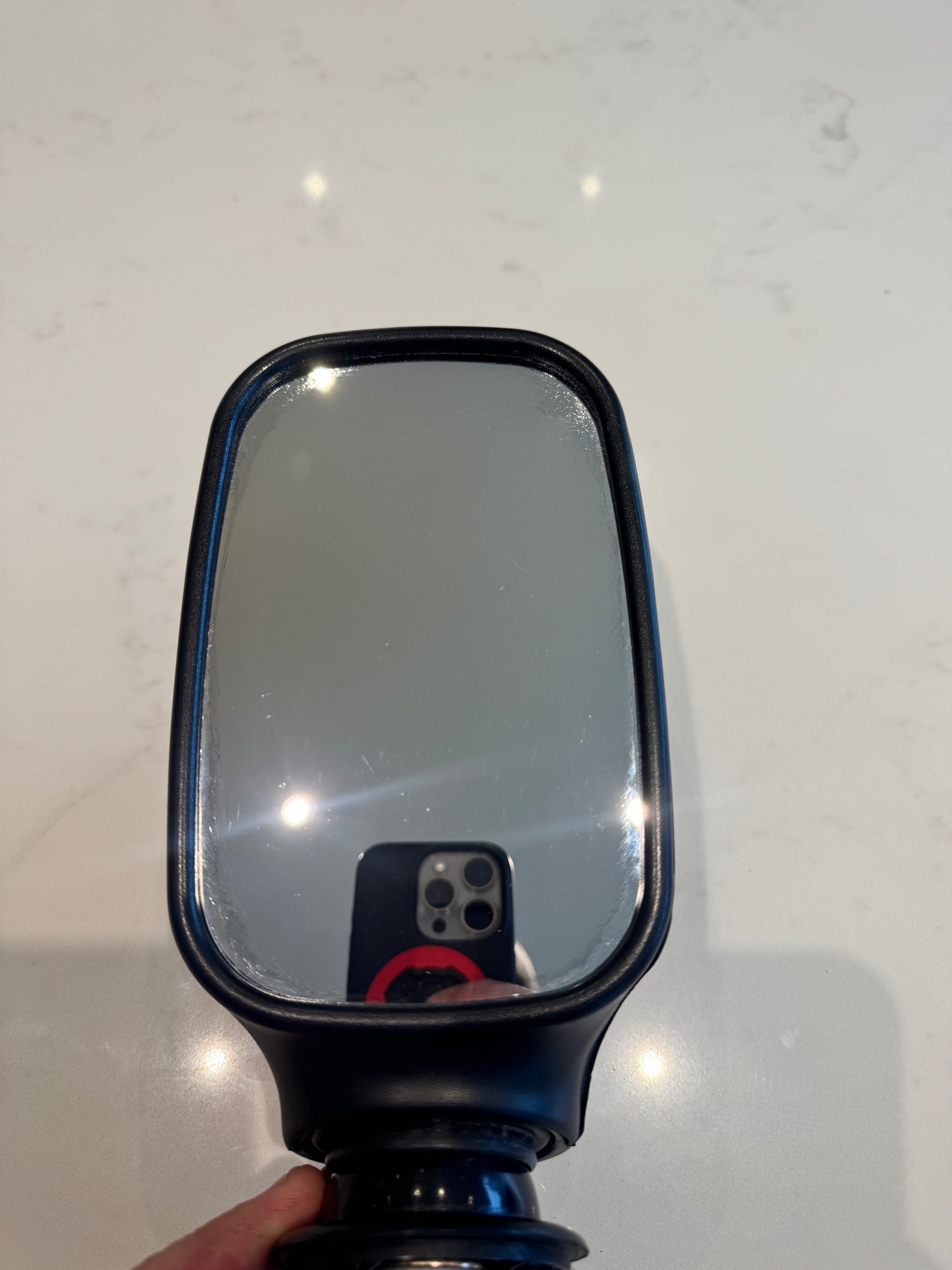

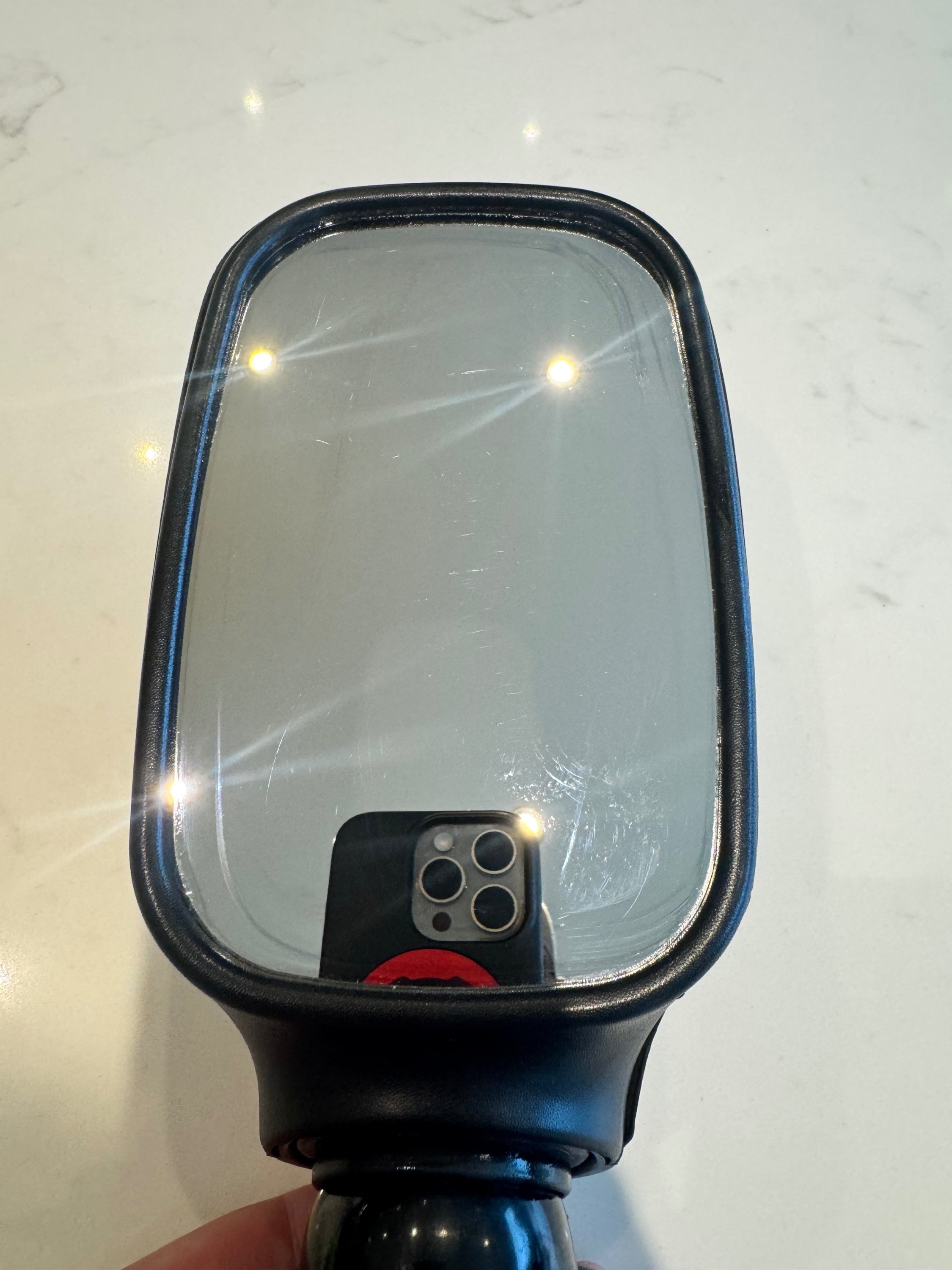

I have removed this from a Westfield SEIW to install a full roll cage. £100 ono Please contact for more info.
