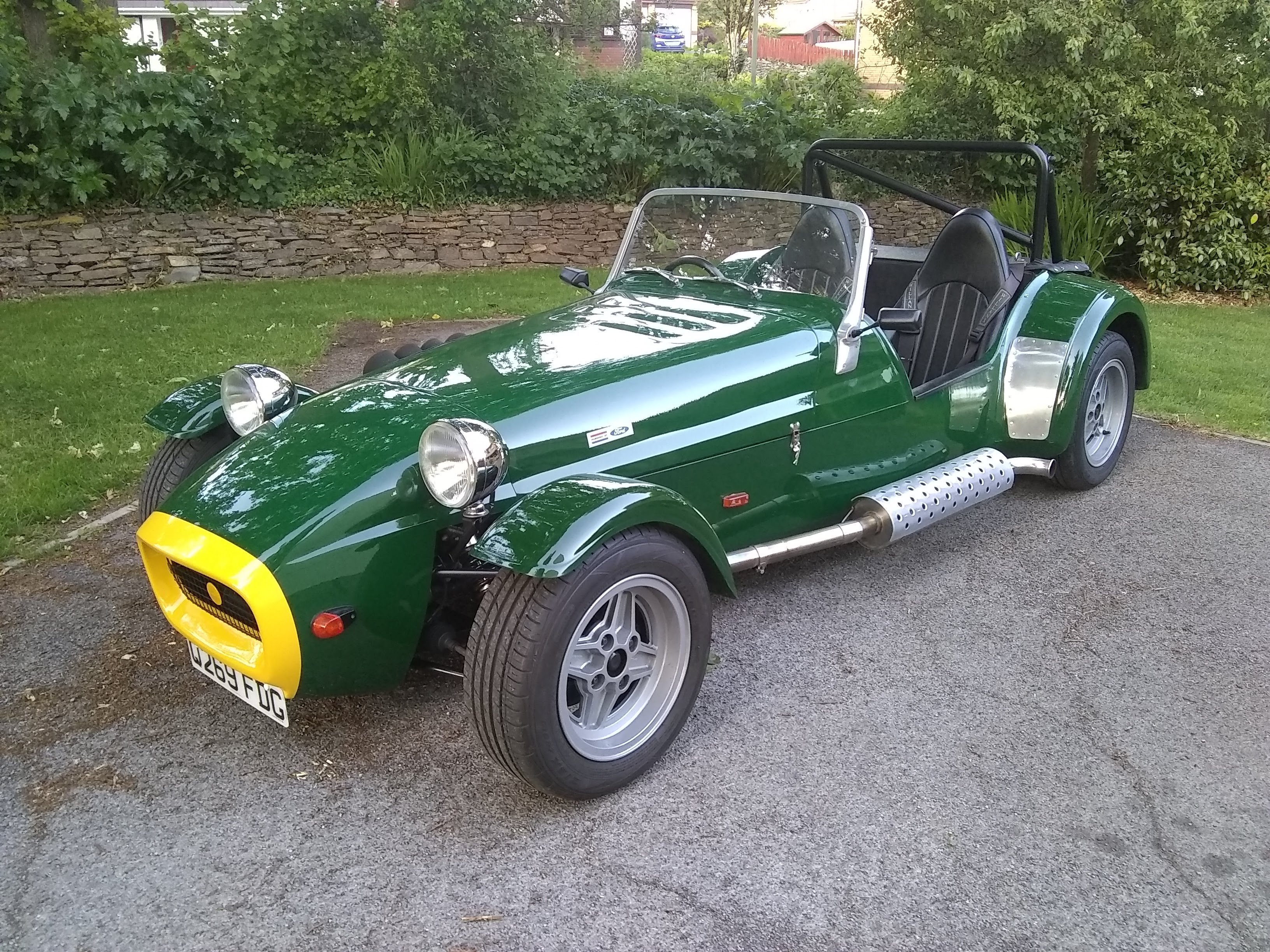

  2. I think you have an early fixed arch widebody car like I used to have not a narrow body car. You have cut outs for the rear lights and shoulders. This may make your search easier, poss trim ZK protector, ideally trial one and see if it fits. I made my arch protectors from 1 mm aluminium. From the photos it looks like the top of the rear of the tub is sloping, if so it may have broken away from the rivets underneath holding it on to the chassis, quiet common if carrying a spare wheel. Best have a look and check. I've had to reattach the rear of the tub on three cars. I went to Shelsey a few months ago, absolutely loved it. Best of luck with your plans👍

    185/60 R13 Tyres x4
    Personally I wouldn't be too anxious about taking the step to R13, obviously tyre choice more limited but ride is great. I've taken R15 off two cars to go R13. On a previous car I had 185 60 on the front which would not fill Westfield cycle wings hence why I used Caterham style cycle wings, looked fab. Current car has 205 60 all round and they fill Westfield cycle wings fine.
