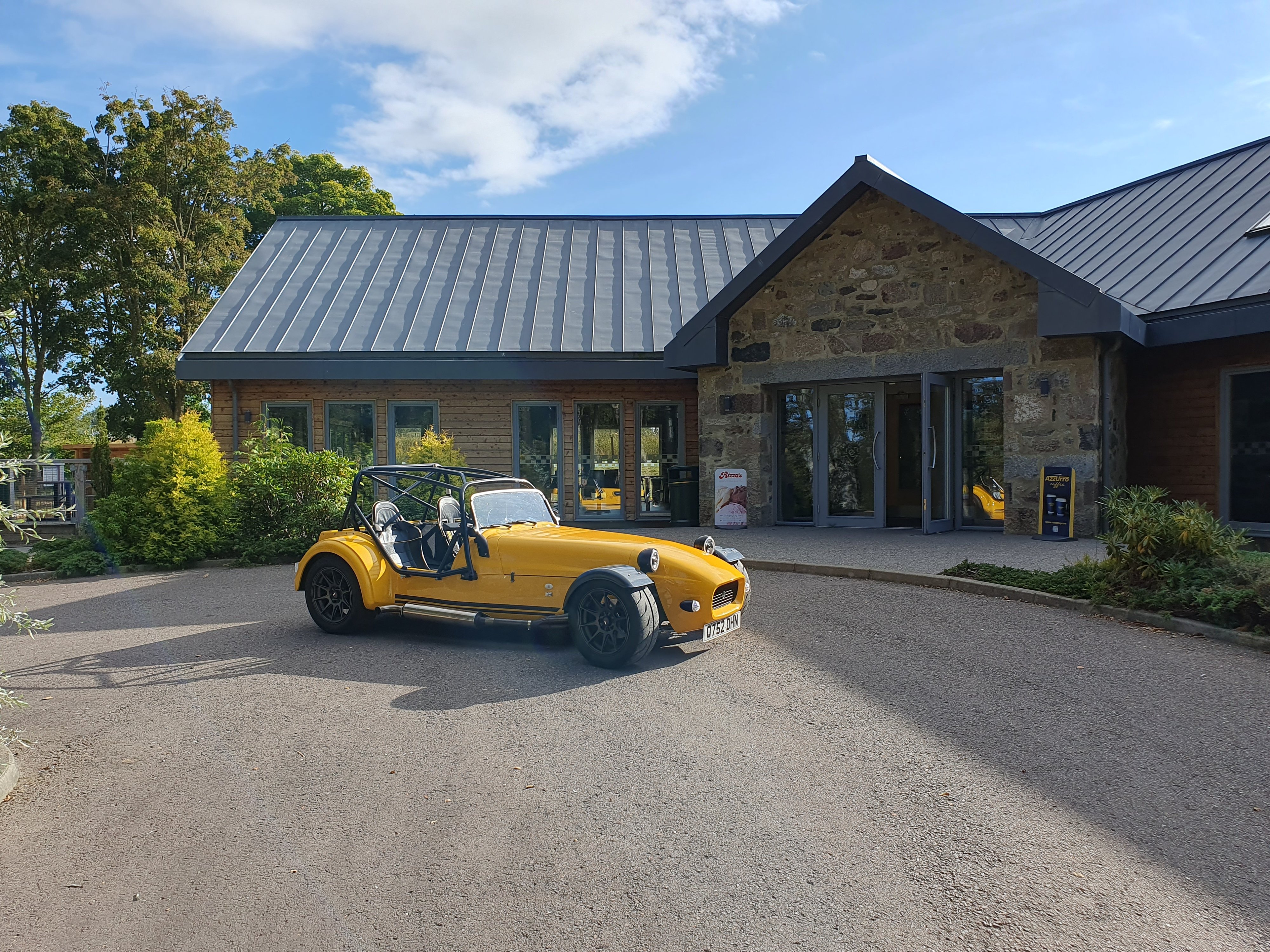

You could fully clamp one to the cage without needing the side supports, then just remove for mots or heavy rain/track days (that's what I do). I used Makralon AR (scratch resistant coating) and it's held up brilliantly as well as being optically clear -
I wanted to try one of those short screens with my cage, to give a bigger wind deflection but without having to have a full screen and wipers etc. Can't recall who used to make them, MoFast maybe, but they no longer do so.
