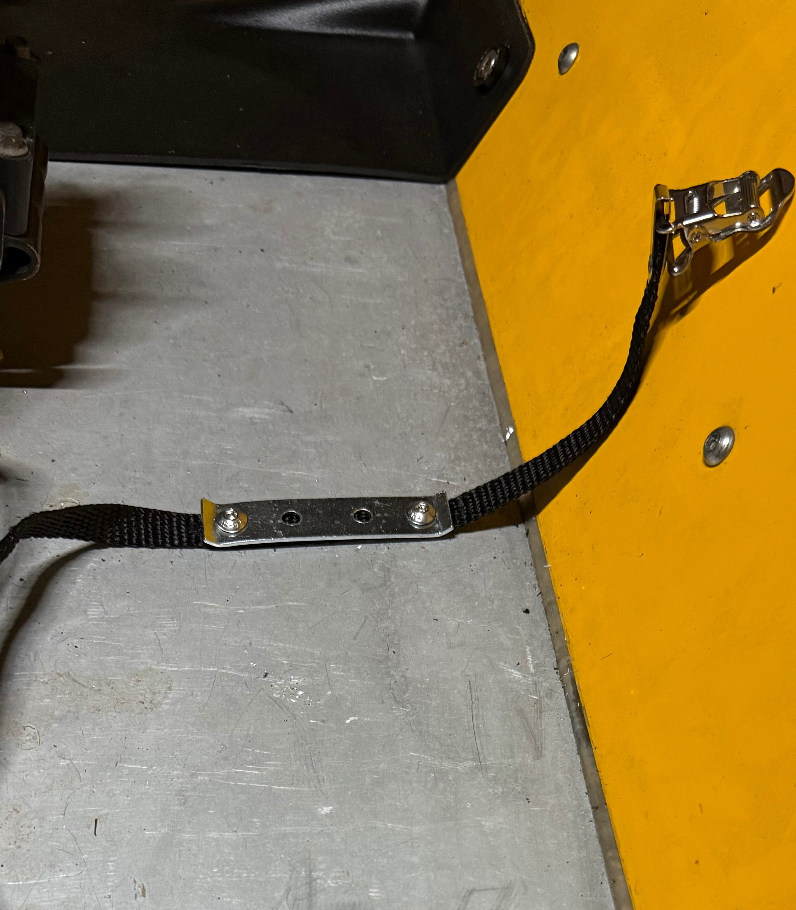

As simple as this. Four M5 rivnuts, two nylon straps, with plates on top to spread the load and prevent them trying to pull through. All ice and secure. -

I’ll take a photo tomorrow and all will be revealed. Then I’ll show you how I fitted the plates -

nice job Tim, I was looking to do something similar, how did you fit the plates on... -

Another quick job that I’ve been meaning to get round to for longer trips and euro blats, was using the empty underhood space to fit a tool roll including a jack and wheel brace. Just popped some M5 rivnuts in and used a couple of cycling toe straps, held down with stress relieving plates to hold this natty canvas bag from Amazon. Easily removed if out locally, but I’ll probably just leave it in there. -
