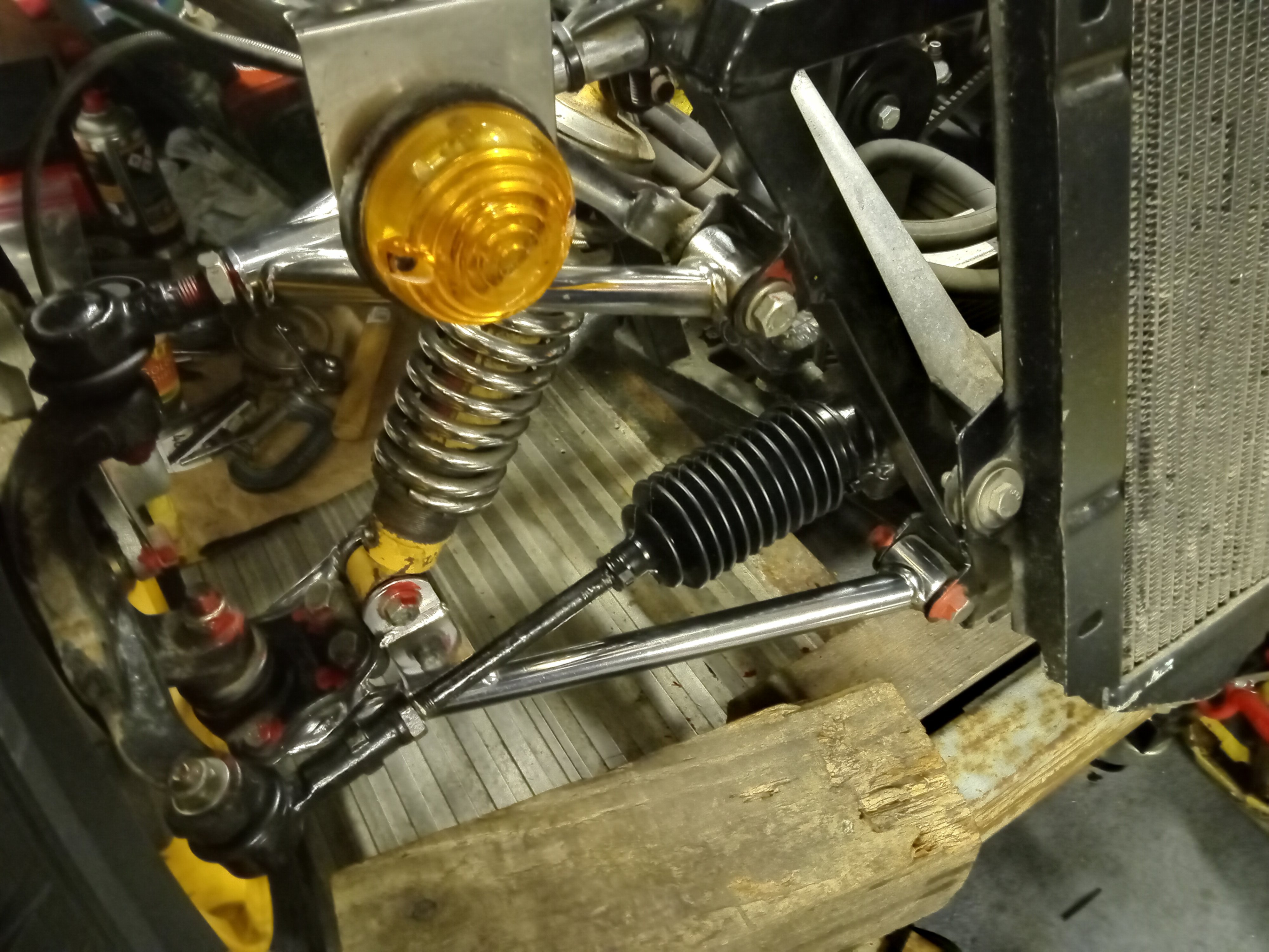

  3. Davemk1
    New member in Michigan USA
    Nice work on the bumpers...I hope that gets you through the process. I have a comment that is completely unrelated to the bumpers. In looking at the photos of the front suspension something caught my eye. I see that the tie rods attaching the steering rack to the uprights/hubs angle down dramatically as they go out to the upright. It's my understanding that these tie rods should be more or less horizontal and not angled down. I just went and looked at my car (2014 Mega S2000) and see that the tie rod end sits on top of the steering arm where yours attach to the underside of the arm... hence downward angle. I suspect that the steering arms are on the wrong side of the car and this means that the tie-rod end can only mount to the underside as yours are currently. If you swapped them side-to-side then the tie rod would mount to the top side of the arm and be much closer to horizontal. This is important due to the bump-steer that will result from the angled tie rod. As currently set, the wheels will toe-out in a big way when the wheel is pushed upward by a bump. Ideally there is almost zero toe change (with the arm horizontal) but with this downward slope the wheel will toe-out a lot. This can be a serious issue and can cause the car to be very twitchy as the alignment changes when you hit bumps. It's none of my business of course and you should do what seems right to you...if it were me I'd check this out to be sure all is as it should be. Attached is a photo of my car for reference. I hope this all makes sense. dave
