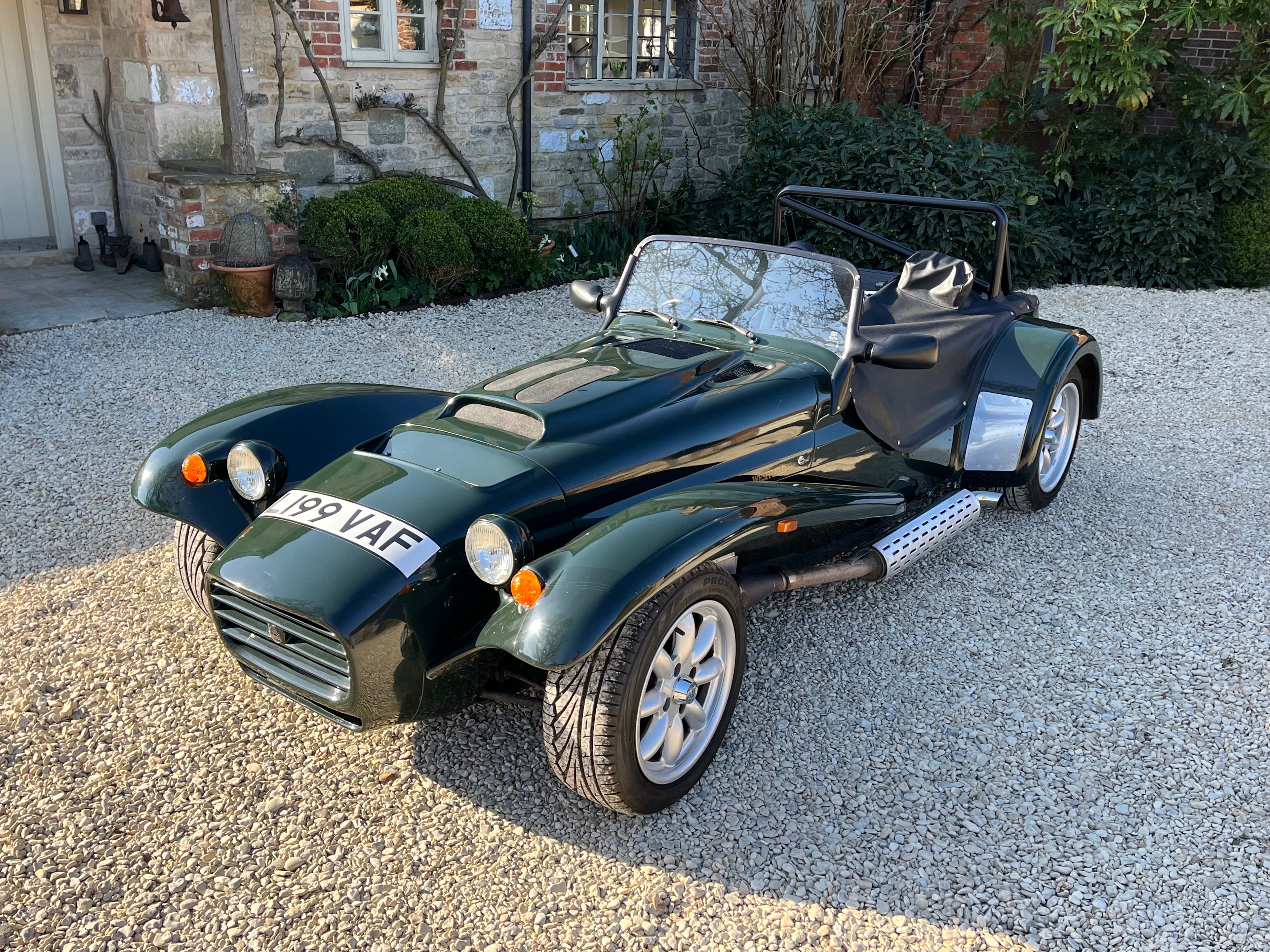

The dark green gelcoat on my 1993 SEiGHT is beginning to show its age, with a few areas of crazing, scratches, etc. I’m loathed to paint the car, but getting a good colour match with gelcoat repairs I suspect will be next to impossible. So the obvious other option is a wrap. (Which can be taken off in the future if required, with very little chance of any damage to the existing gelcoat.) I could go dark green, and keep it looking original. But that seems a little bit of a waste of the opportunity. I’d like to do something more fun. I’ve been thinking of race liveries. There’s a lovely Gulf car locally, but I’d feel a fraud copying that. Can’t do Martini as I’m not so keen on the main body of the car being white. And liveries that split the car in two horizontally, such as Gold Leaf or Rothmans do not suit my car which has the butterfly wings. Hence at the top of the idea leader board currently is JPS. Wrap the car in gloss black, then add the gold coachlines, wording, logo’s etc. Given the age of my car, and the wings, I’d rather go with more period/classic look, than something too modern. Has anyone got any other ideas? Would love to hear other suggestions or see pictures.
