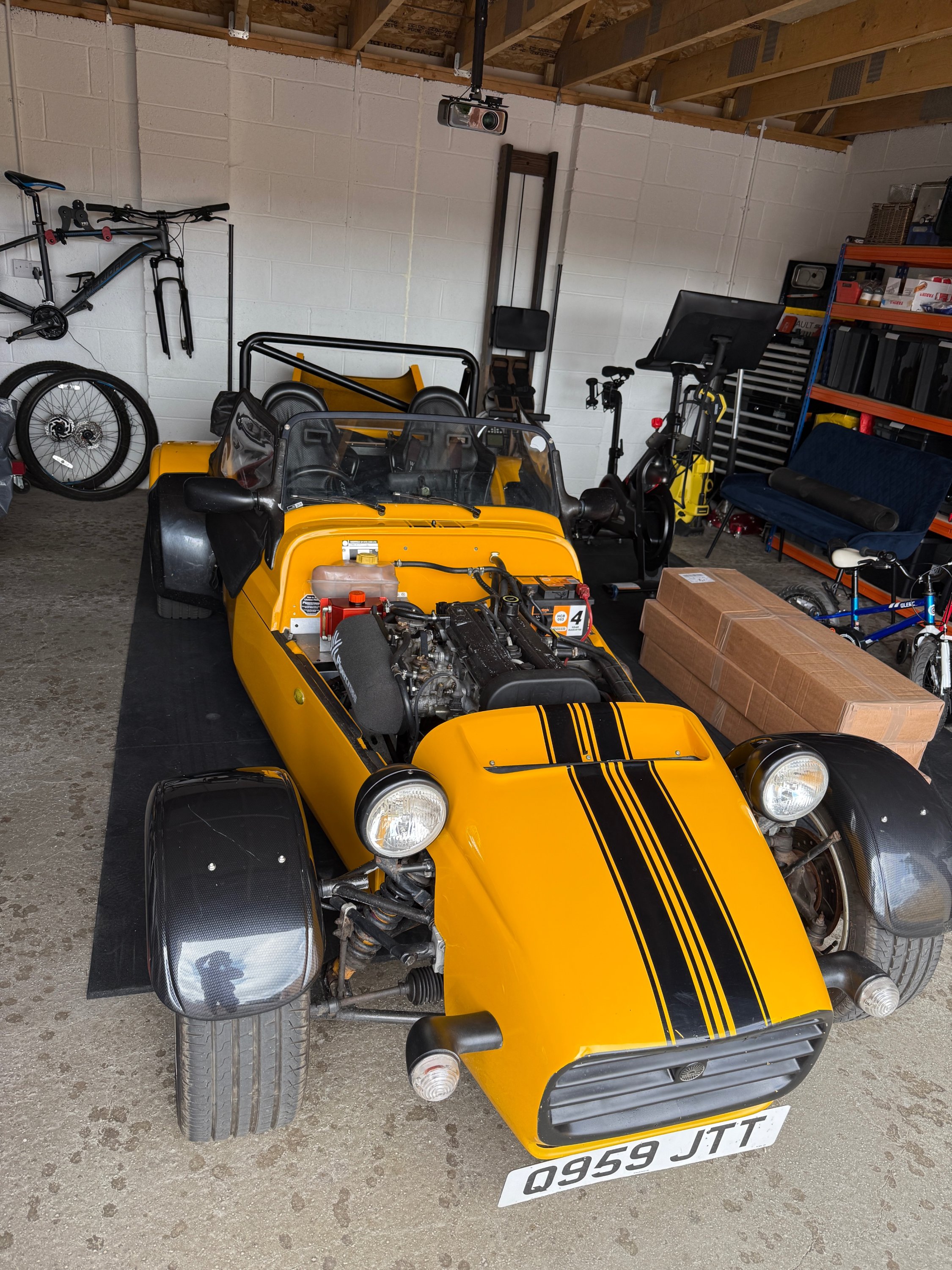

    The first two paragraphs seem a little redundant now..... 🙂 Check the float levels. The bowl in the carb should hold enough fuel to get you around a sharp bend or roundabout without cutting out. If the float levels are too low then you might not have such a "reserve". At the same time check cables into the spark ECU and coil pack just to be sure there's nothing loose that's cutting spark with lateral g forces. Give the cables a wiggle when the engine is running - if there's an issue with the wire you should get the same effect. There's a good few threads on what you need for changing from carbs to ITBs if you have a dig around in tech-talk.

    Just to elaborate on issue above - the electrical plug going to the ignition seems to be the potential issue. Must have a loose wire or bad connection as when touched while running it cuts the power for a fraction of a second. Assuming the forces when going round a bend might be enough to cause this movement. Fingers crossed.

    Hi folks, Recently joined the forum after purchasing a 2002 SEiW last weekend from a colleague. Had various cars over the years with high power but nothing has compared to the fun I had driving this home last weekend, pure joy. It currently has a 2ltr Zetec Silvertop with twin carbs. Recent rebuild of engine with Raceline head and cams. Plans are to swap the carbs for ITBs, refresh the suspension and then just enjoy. Took delivery of some Pro Race 1.2s and Rainsport 5's this week so they will be first up. One question I have is today when driving it in to work (after filling up), it cut out a couple of time on when either on a bend/turning/omn a roundabout. It's a very quick blurp and then fine again. Assuming something to do with fuel starvation but cant figure out where its came from. At the same time a slight squeal has started which seems to be coming from manifold side not the front. Anyway, great car and great fun. Hopefully meet some of the local members at some point 😁 Arran

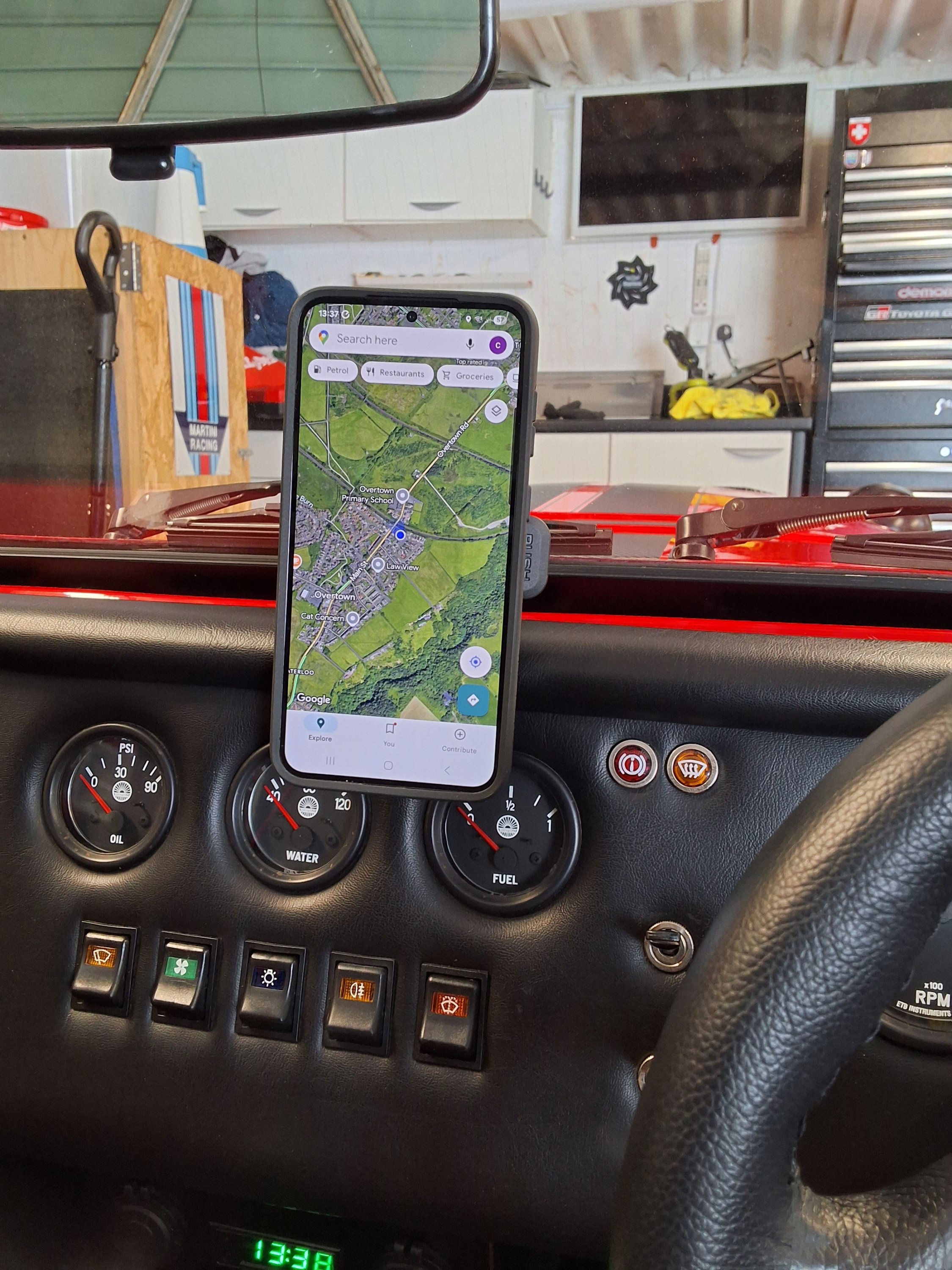

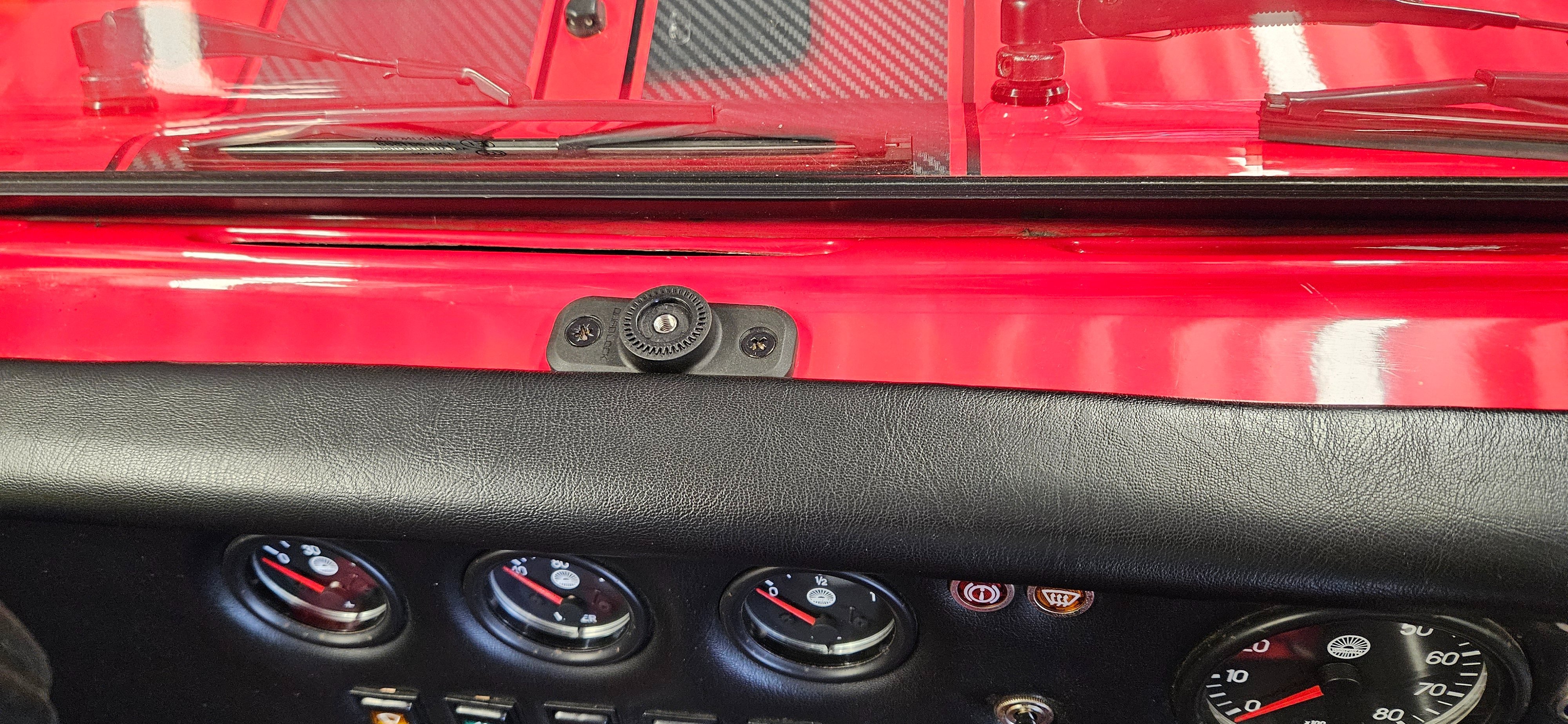

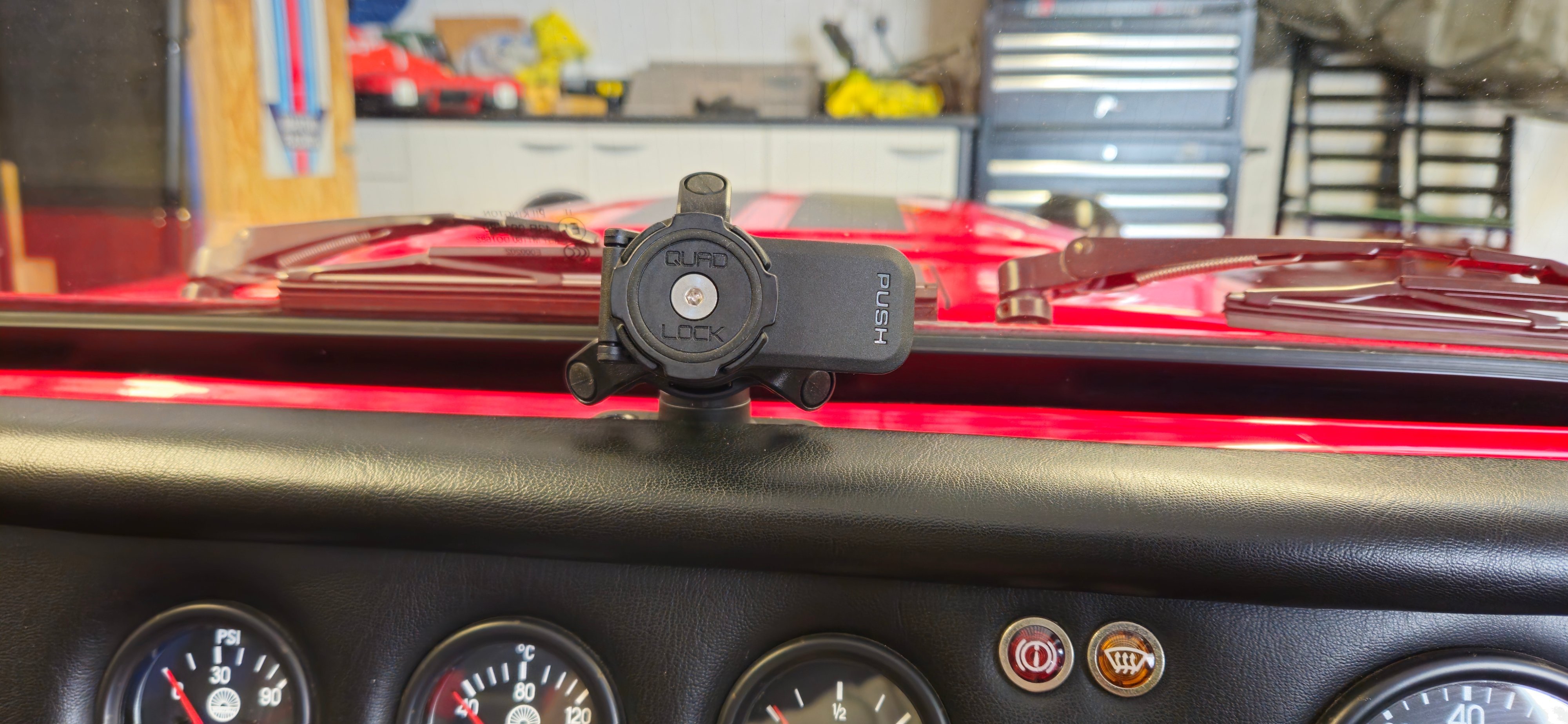

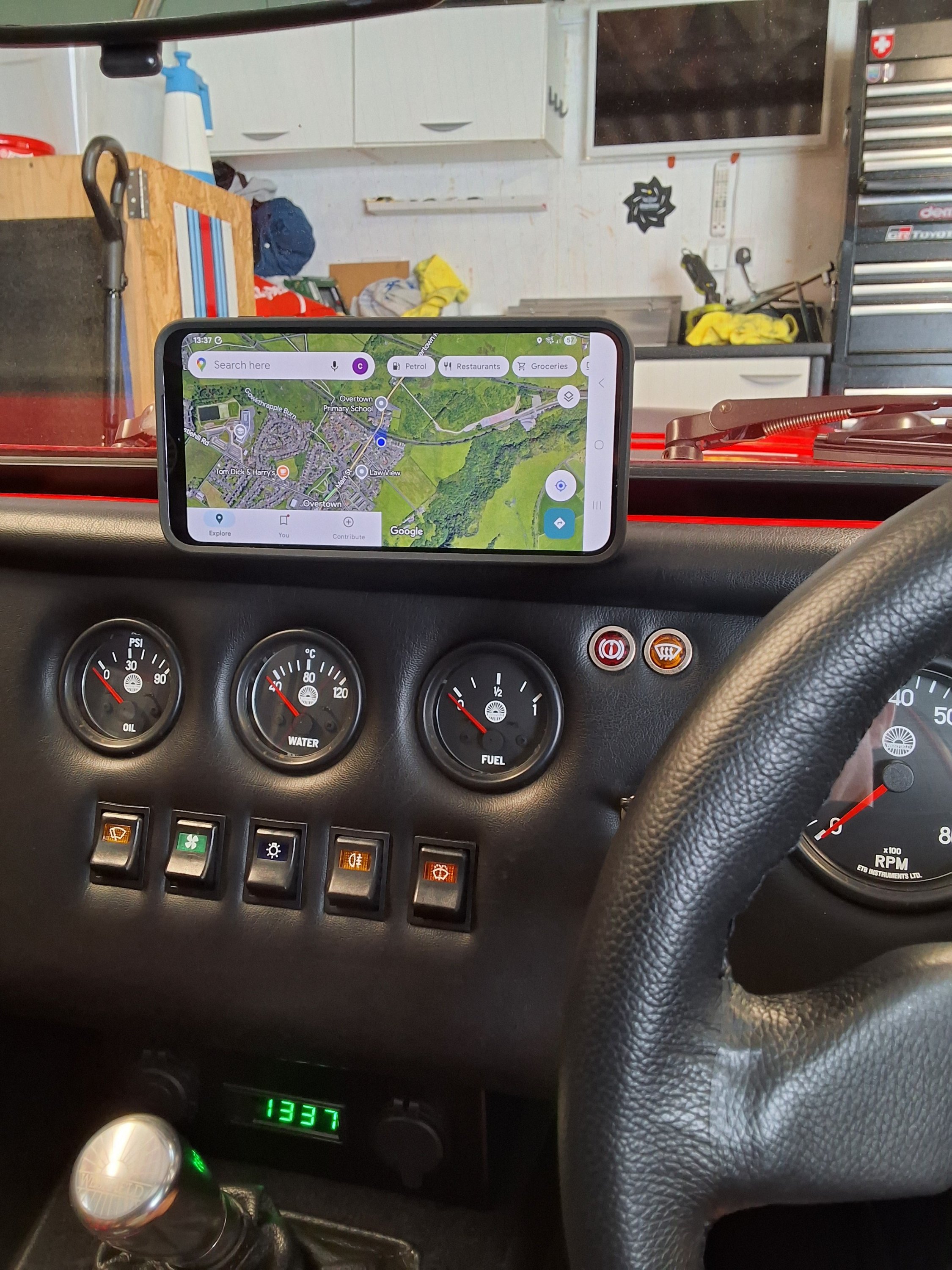

  16. Flying Carrot Steve

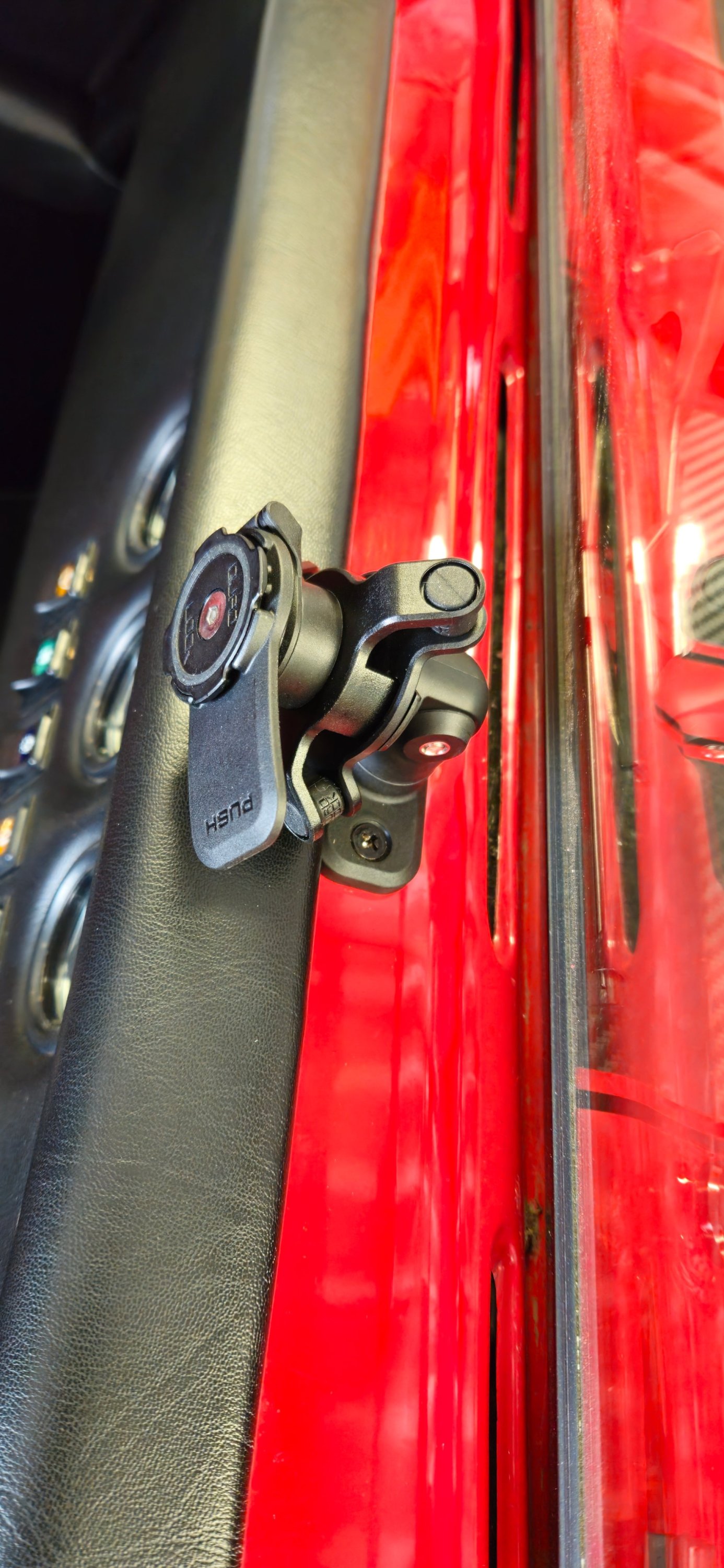

    Where are you planning to mount it? I have a kit for a bicycle, the bracket mounts straight onto the roll cage next to the wing mirror, to which attaches the waterproof case the phone goes in. Got it from Lidl, about 5 quid and it's brilliant! Have put case away somewhere though and can't find it atm 😬

    @Craigieboy Would like to see a picture once you’ve fitted it 👍🏼

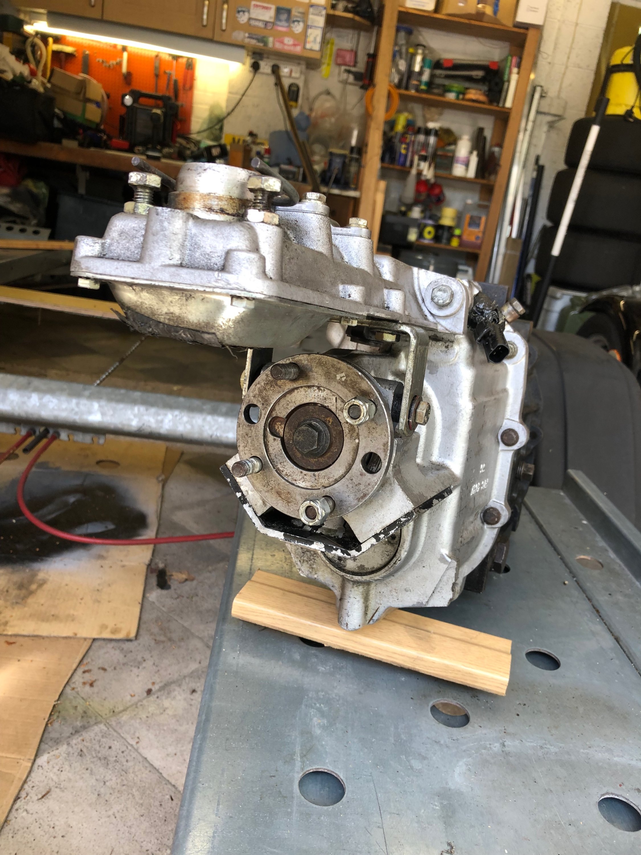

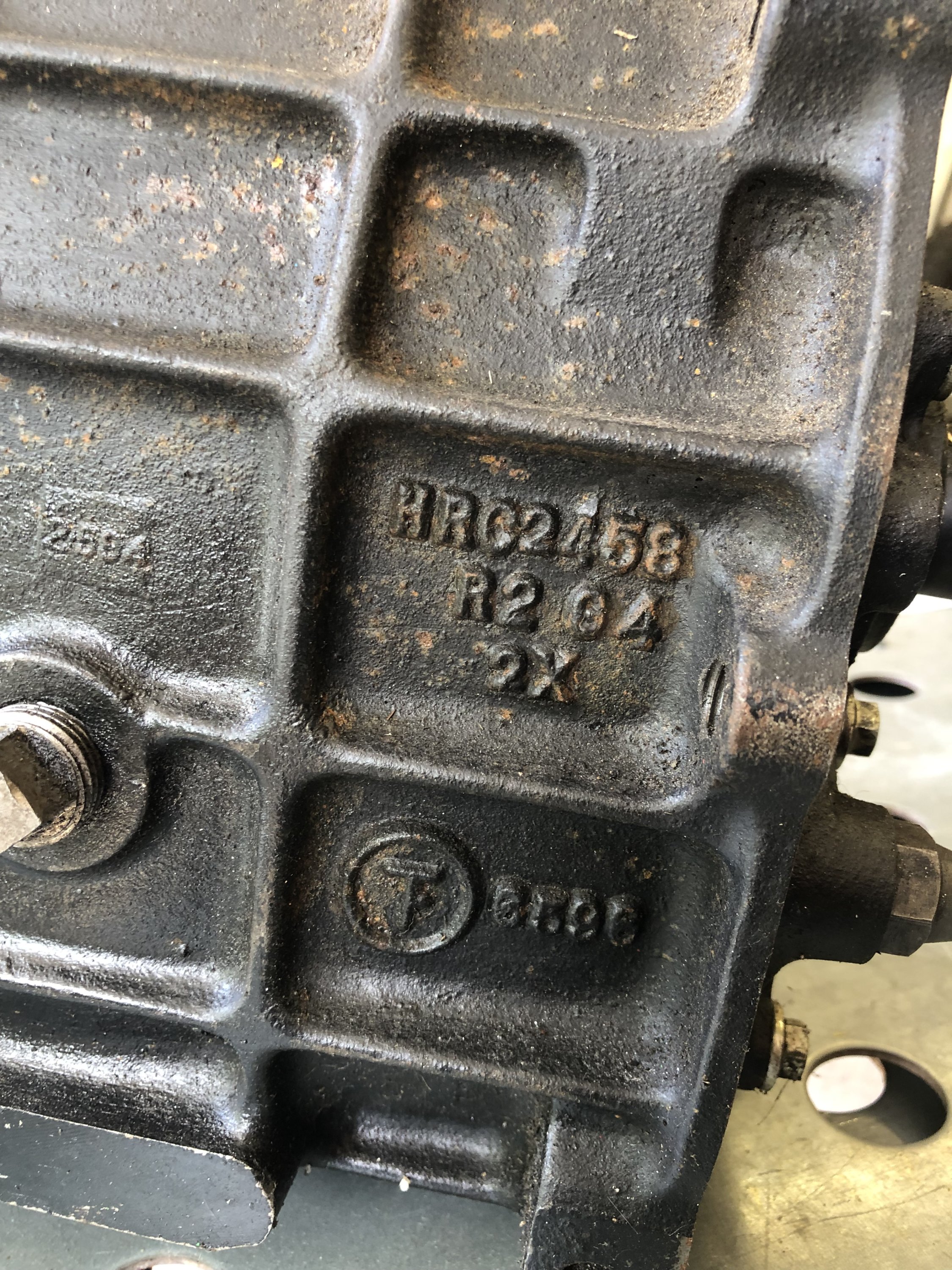

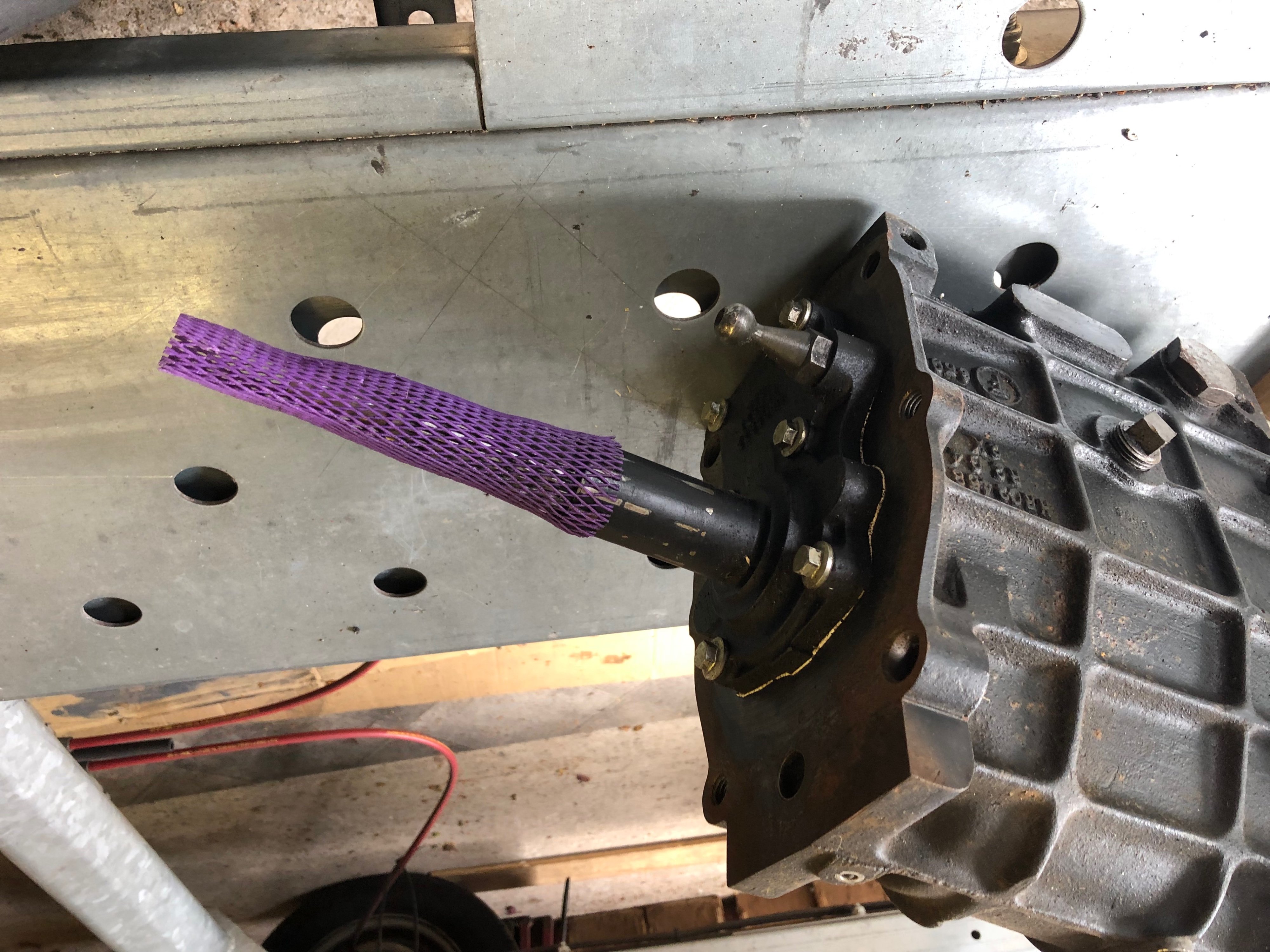

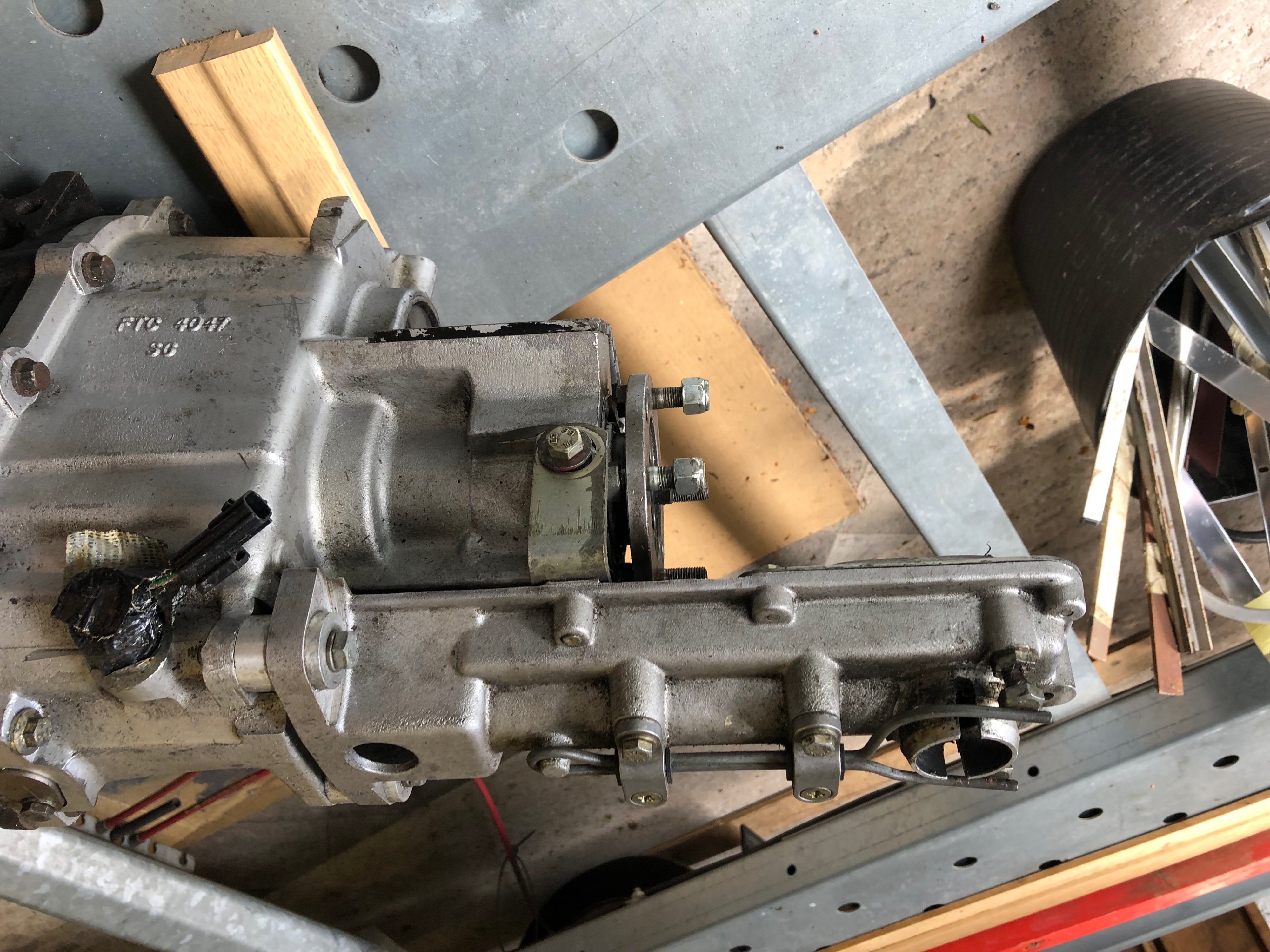

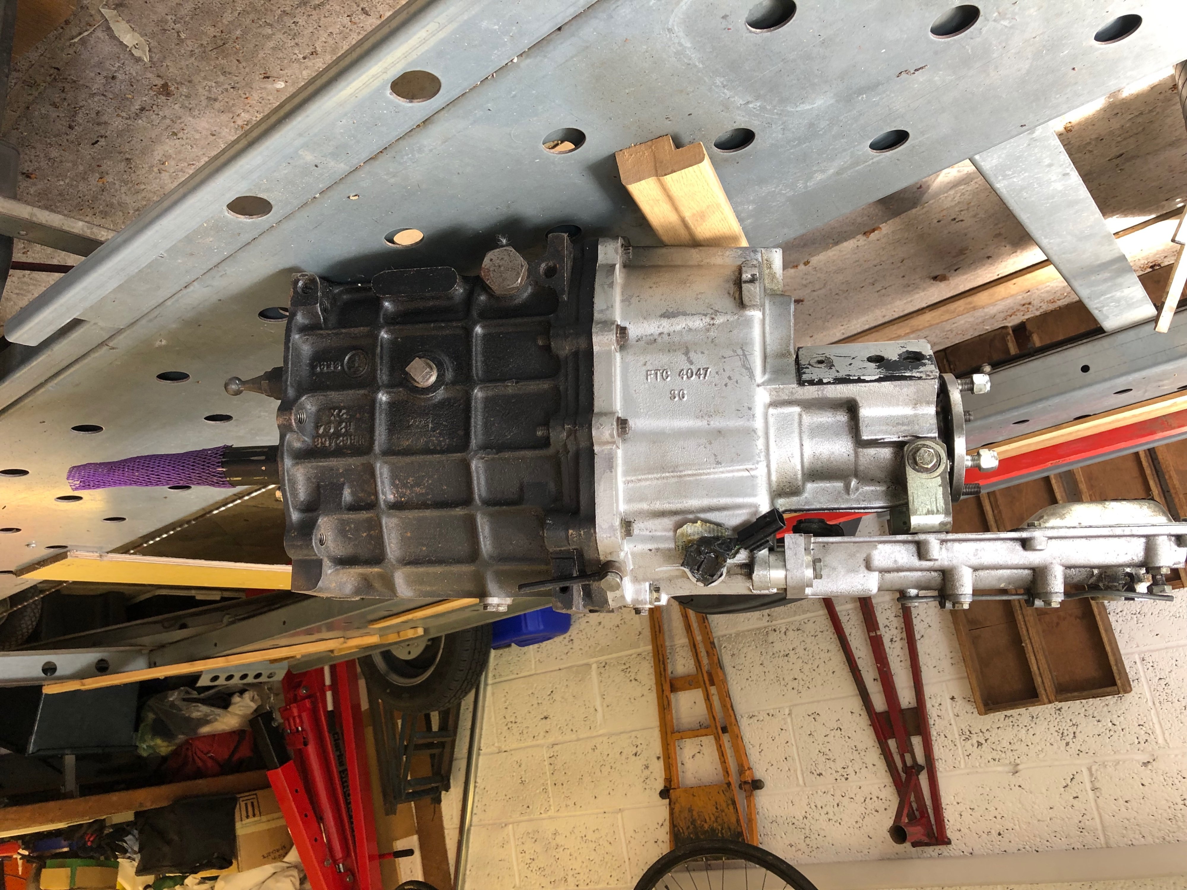

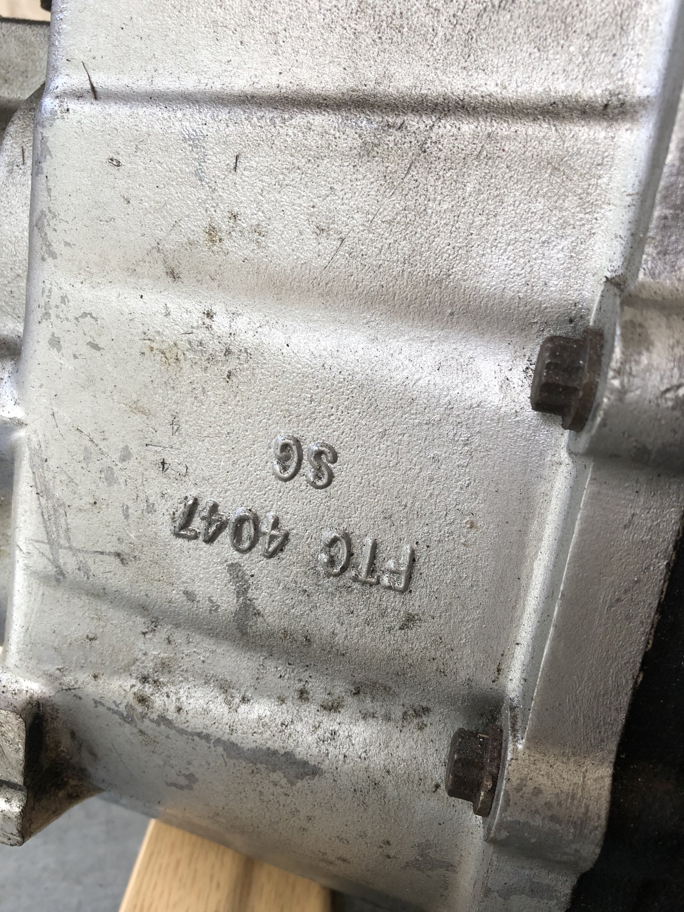

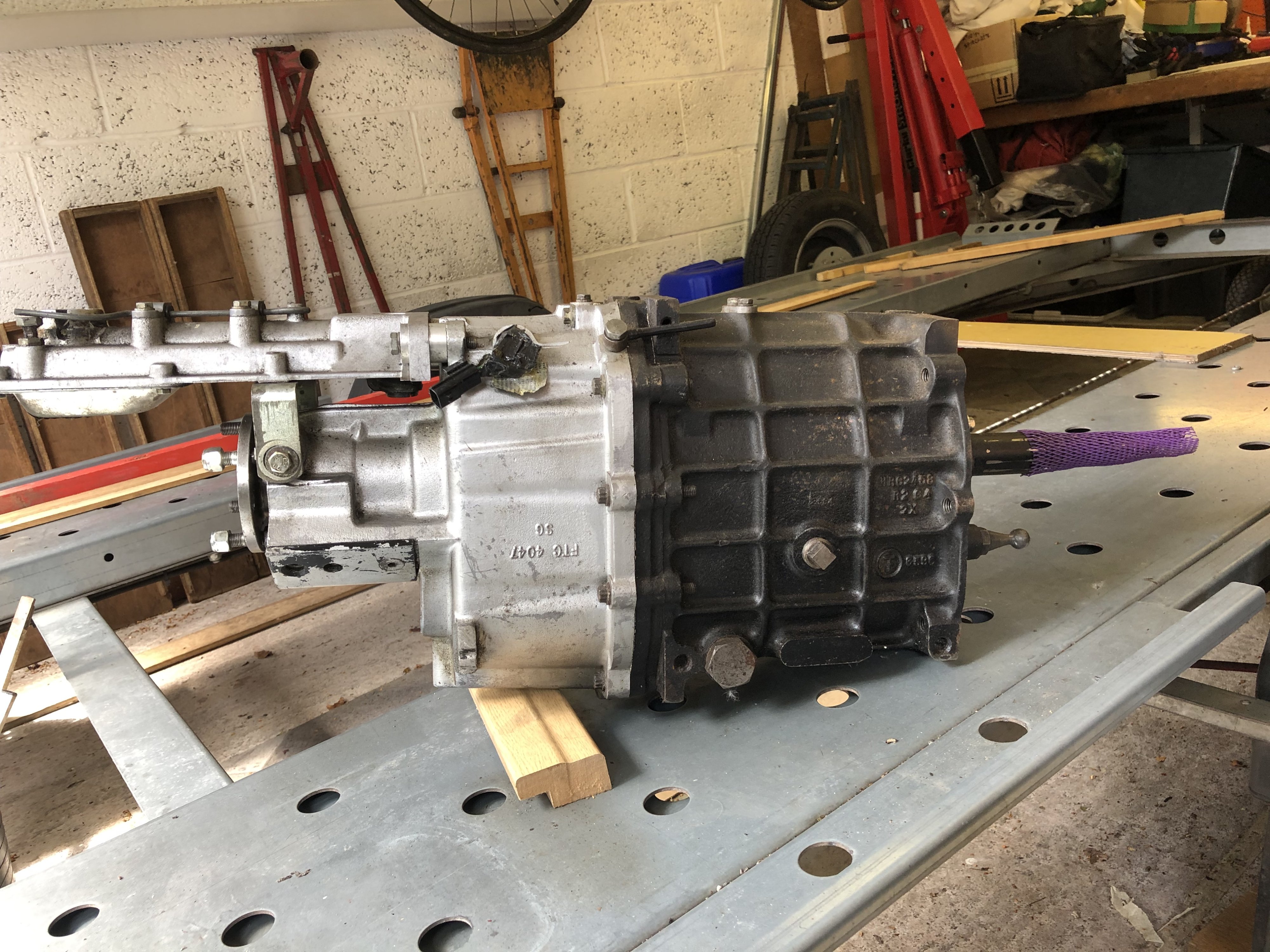

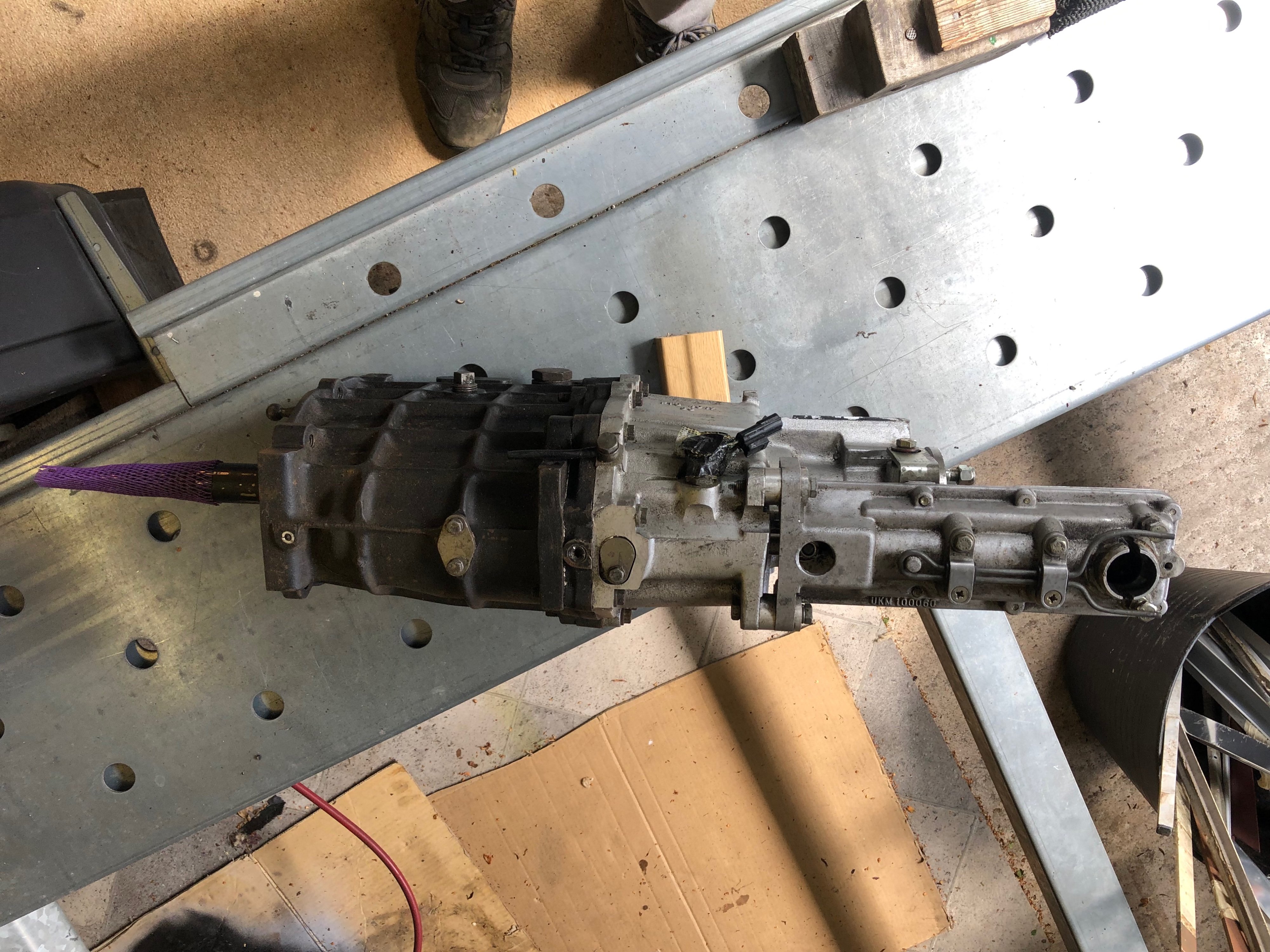

    River R380 V8 gearbox.
    This gearbox was bought from the previous owner with the intention of fitting it in my V8 engined Westfield. That Westfield has now gone so it’s up for sale. £250. Offers invited. location south of Birmingham.

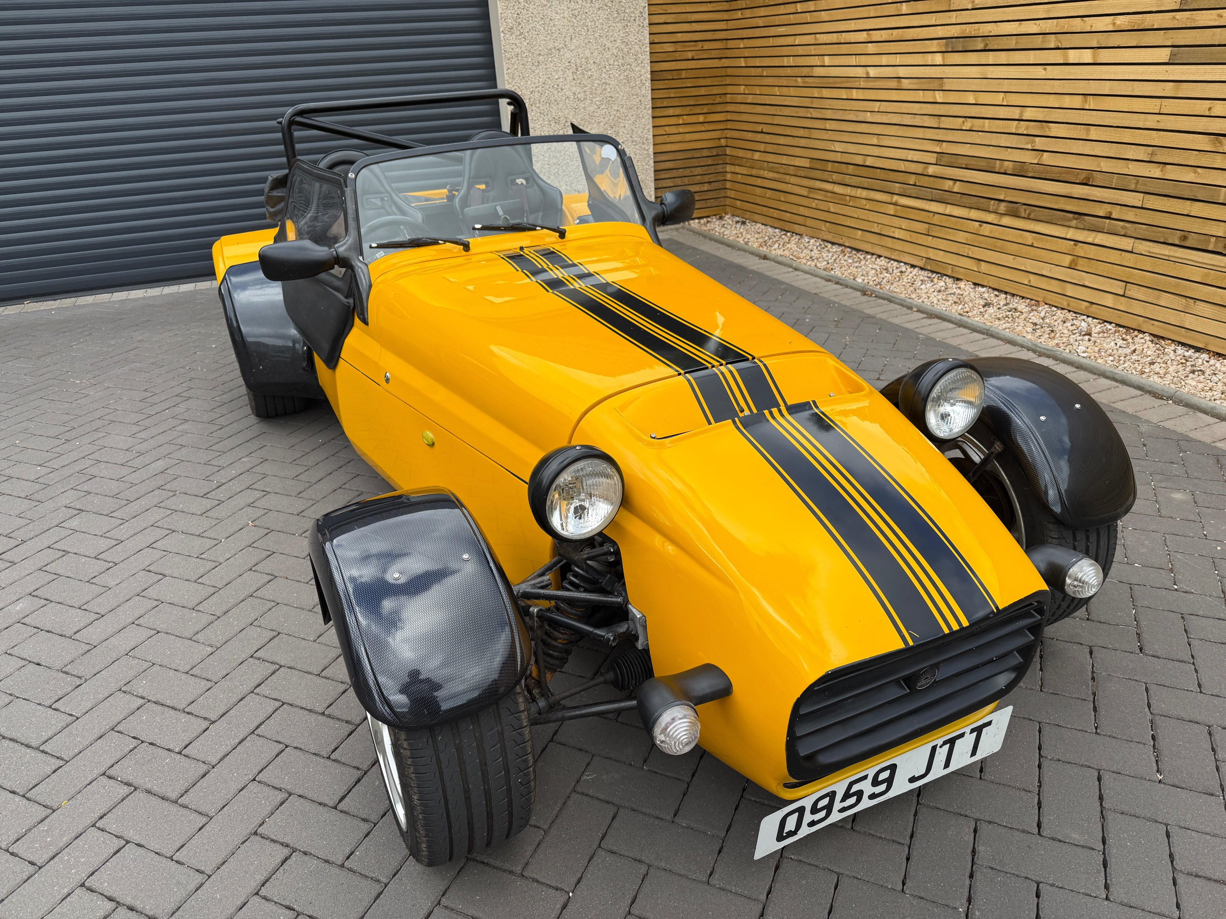

    Most recent of my new Westfield! Although it has since had a machine polish.
