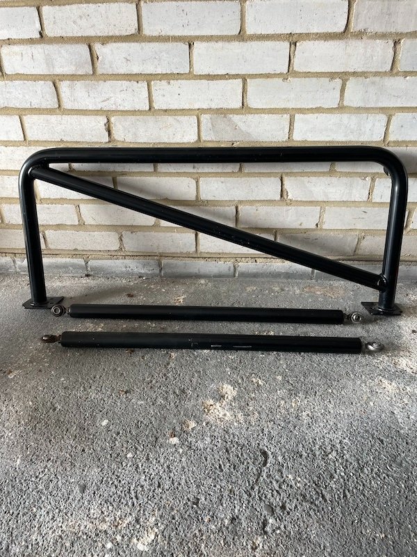

I have removed this from a Westfield SEIW to install a full roll cage. £100 ono Please contact for more info.
