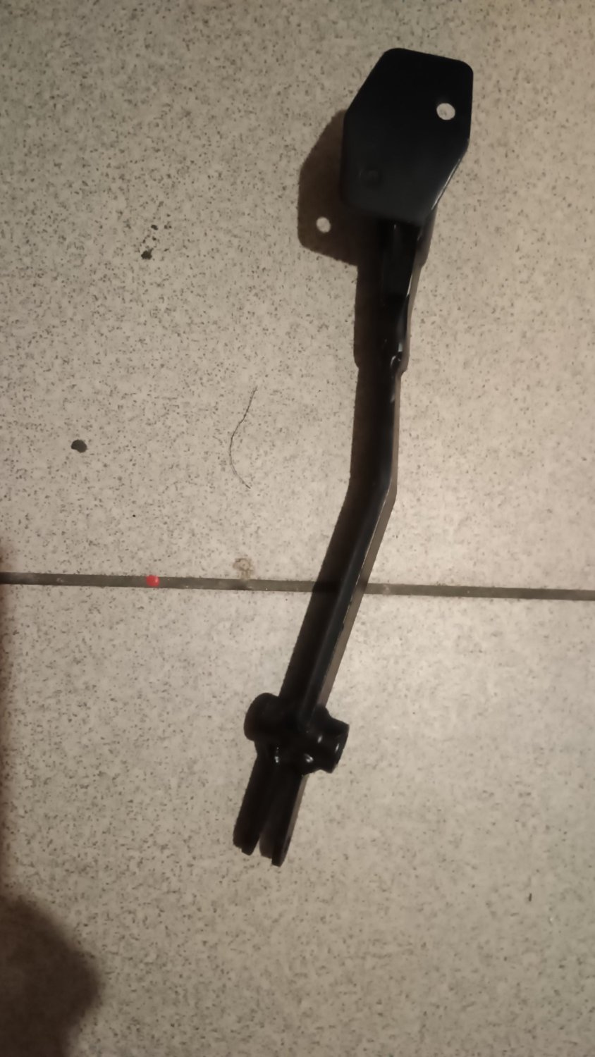

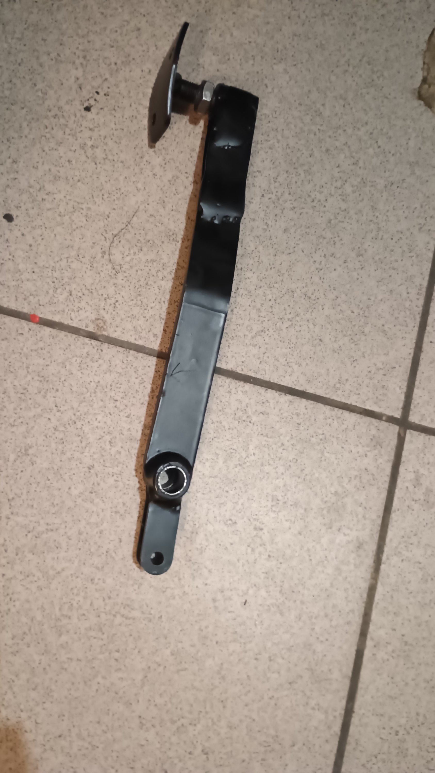

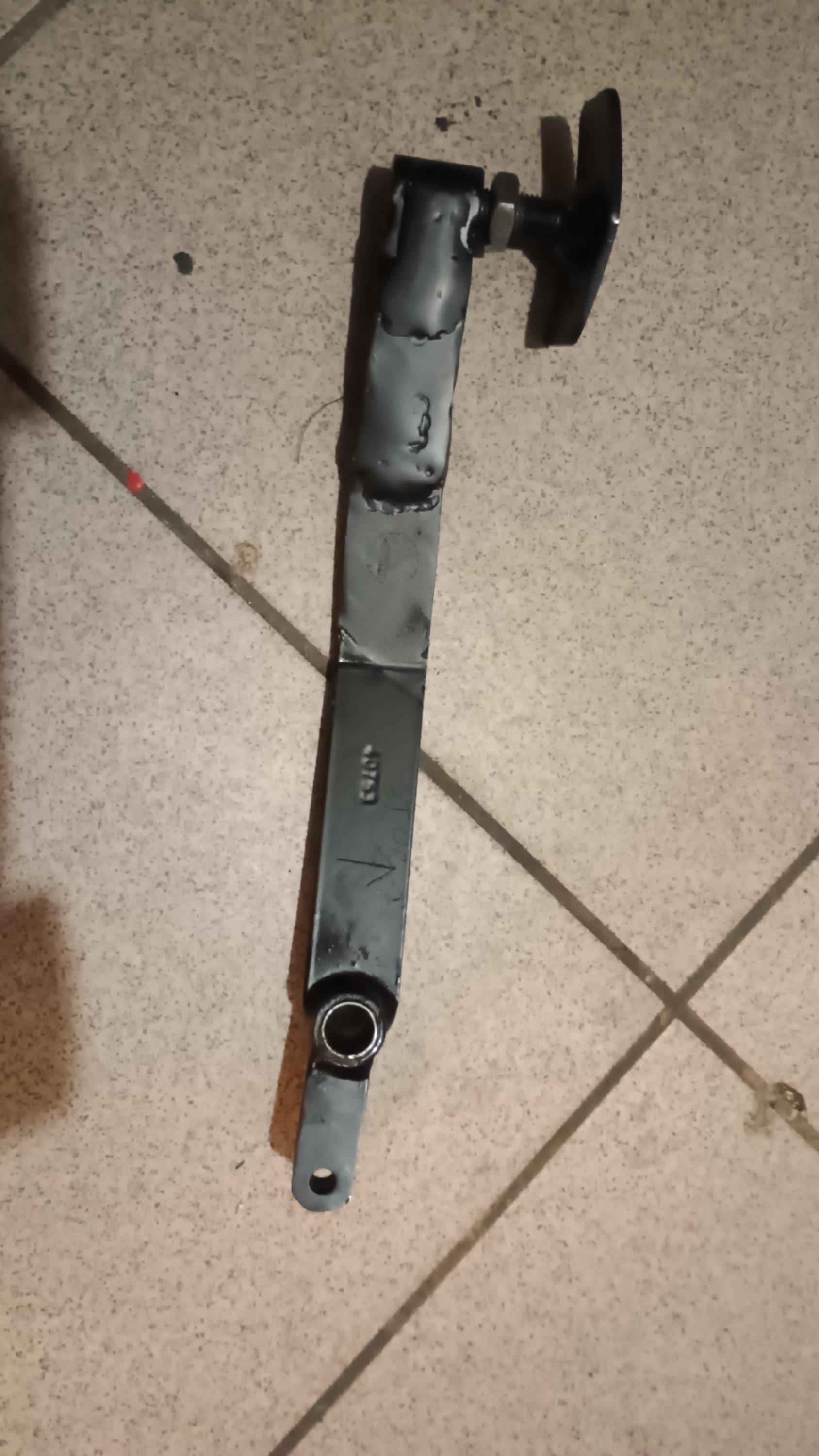

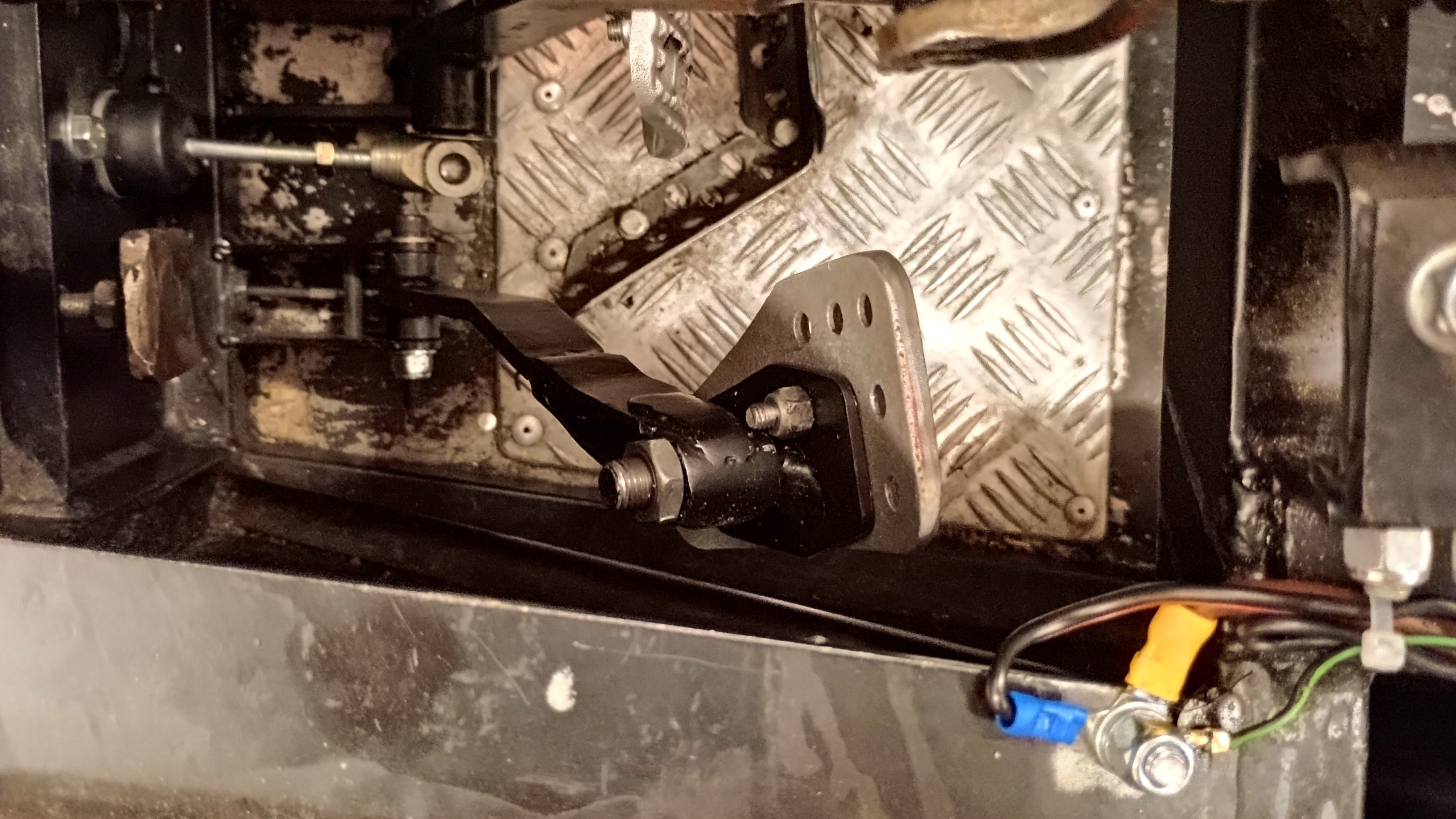

  3. Fabricated longer clutch pedal instead of previously intended hydro change clutch major rebuild.. Calculatiions said IT will be 15-30% less efforrt on foot and it seems it is closer to 30 or more. Extended 4cm . In calculatiions 3cm. (Some time ago i thought it is good idea to fit sport clutch and clutch plate both helix with 200hp zetec and 240mm rear slicks....its not needed ! . Ended with metacarpal bones fatigue fracture...ouch... ) Easier to lenghten pedal so no engine and gearbox out to change clutch plate to standart or modifiaction to hydraulic) Longer pedał travel , yes ! But seems acxeptable do far stationary. Will see on track if it works.
