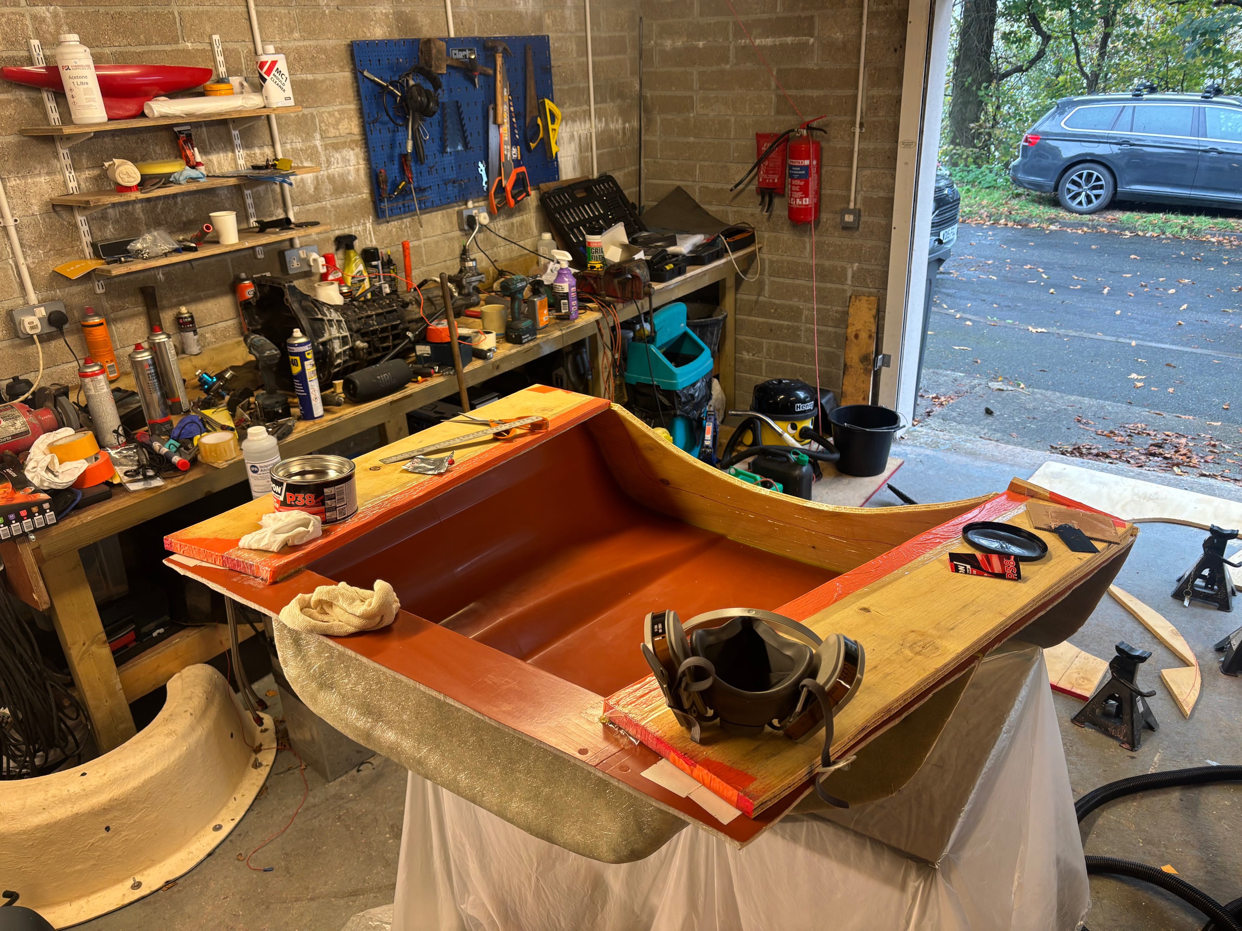

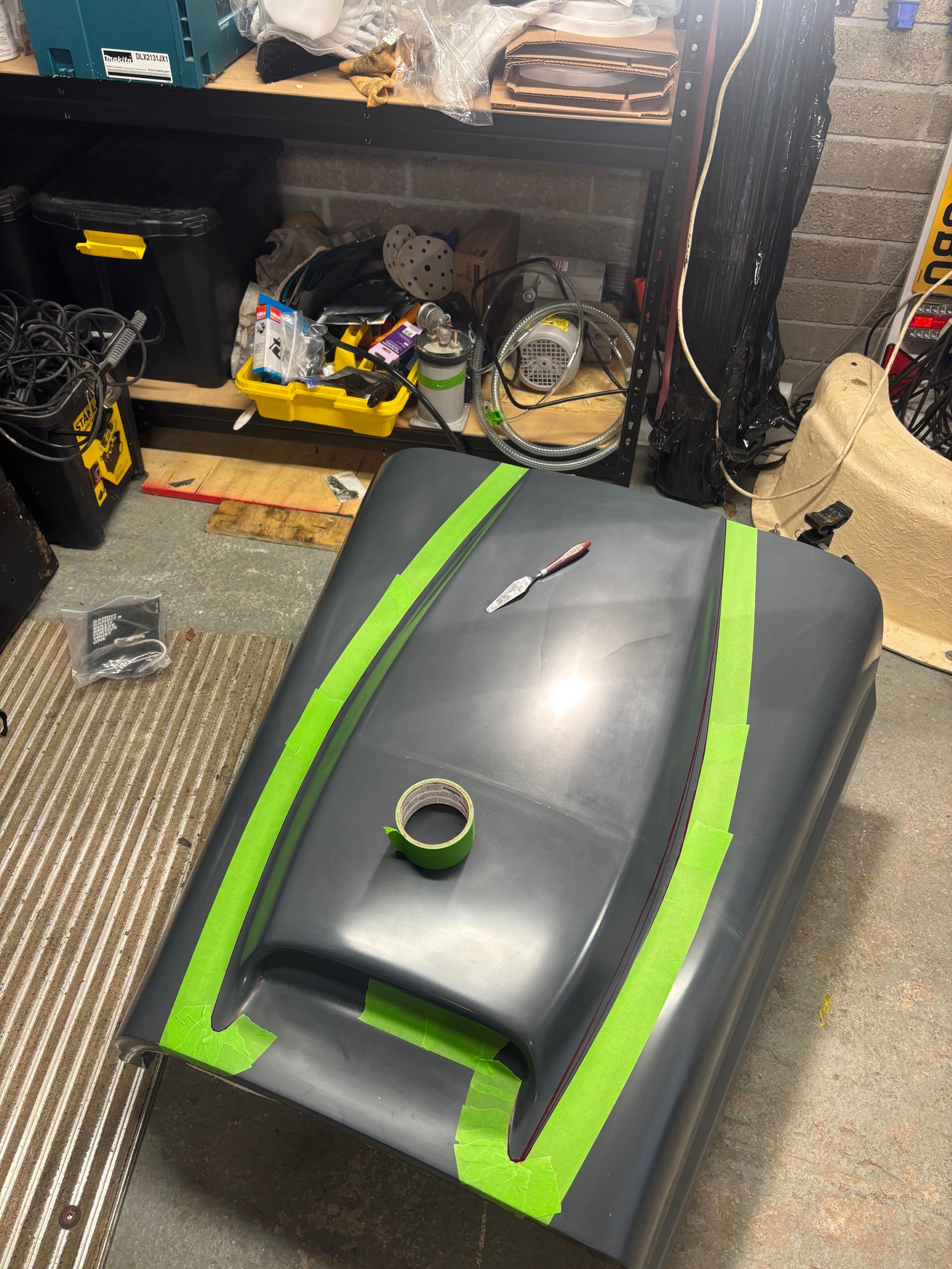

  3. Bonnet mould having release coats applied, and between coats getting templates made up for the cloth layup. Thinking of doing a 0/90 spread tow for the scoop, and twill for the remainder. 45/45 biax mid layer, and coremat for extra stiffness. Haven’t done weight calcs yet, but should end up much lighter than the grp bonnet, and of course be much stiffer. Haven’t decided on vents as yet, but will make these separately and make them into a feature. Using the plug for my templates, and will be doing an infusion.

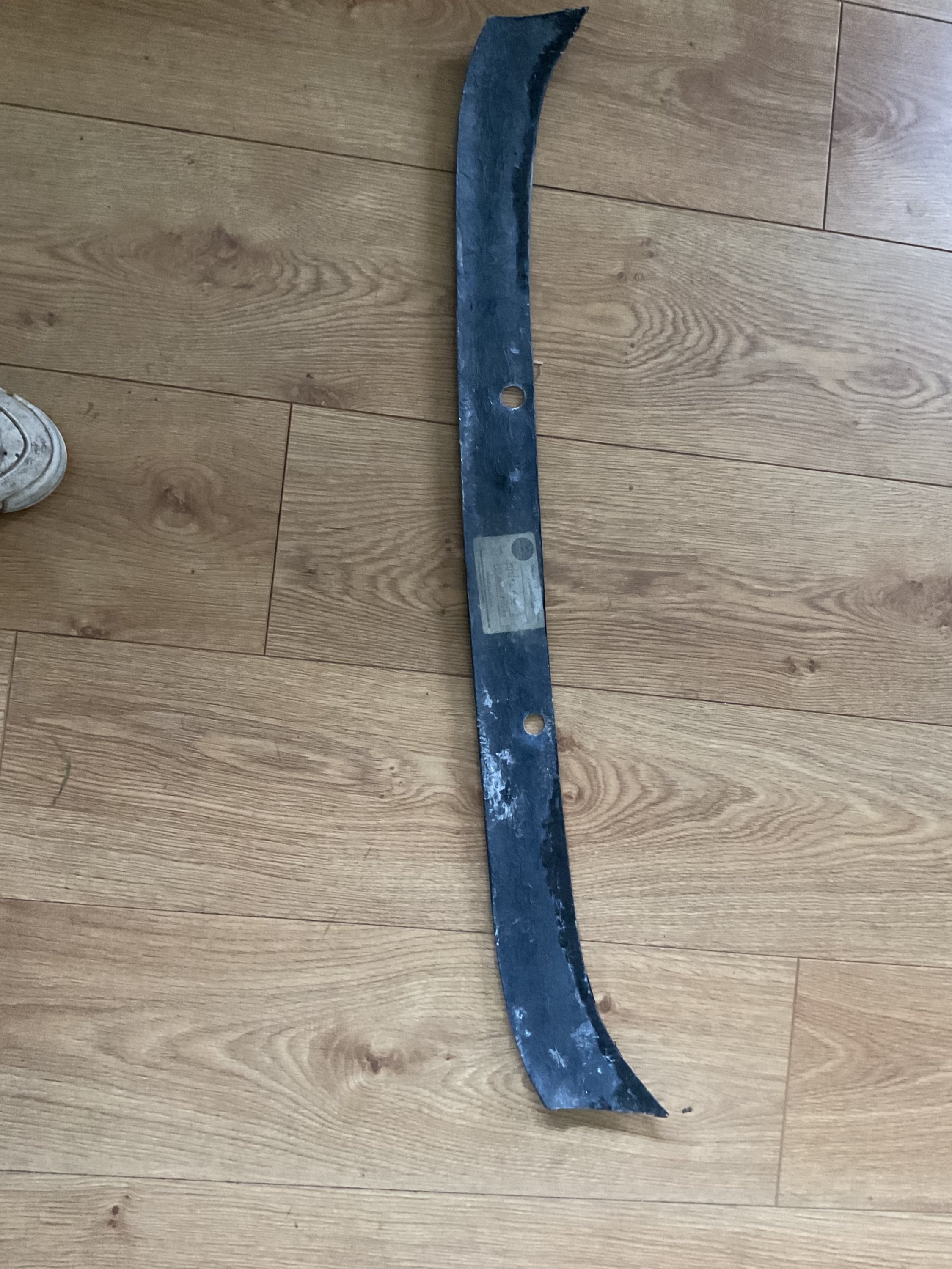

  14. The Machinist
    Narrow chassis windscreen fillet

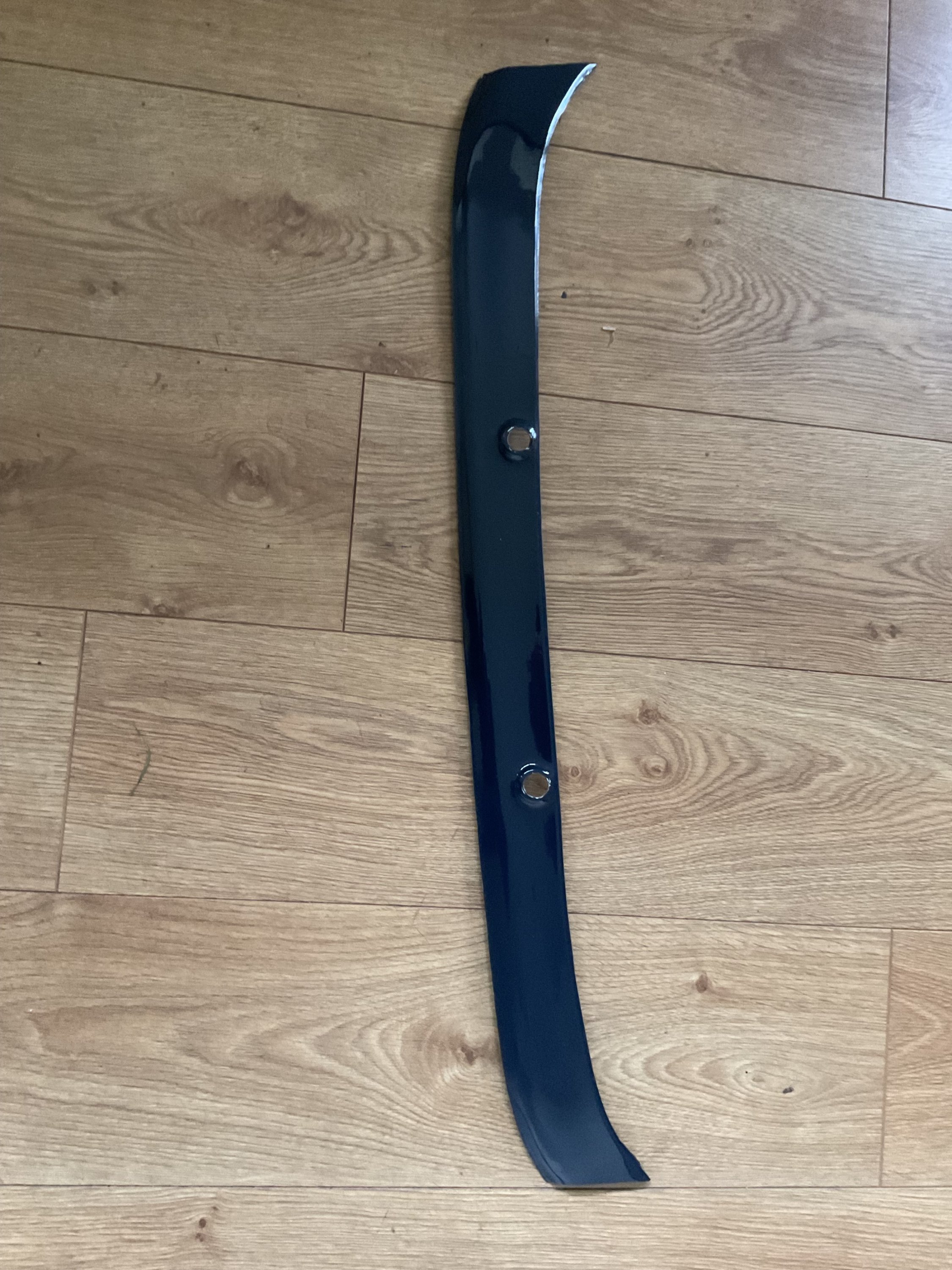

    Narrow chassis windscreen fillet in blue, used but good condition £20

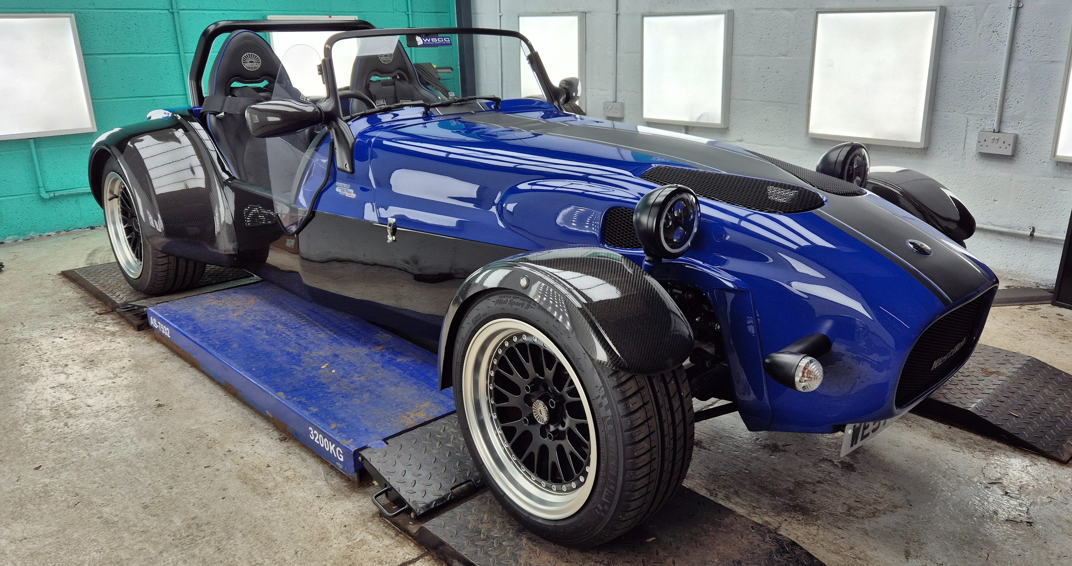

    Had a little bit of pampering done over the past two days. Nothing crazy, just a good once over. There were a few super minor marks from prior to my ownership, and I like my cars to look as good as they go. Mission accomplished. Very happy.

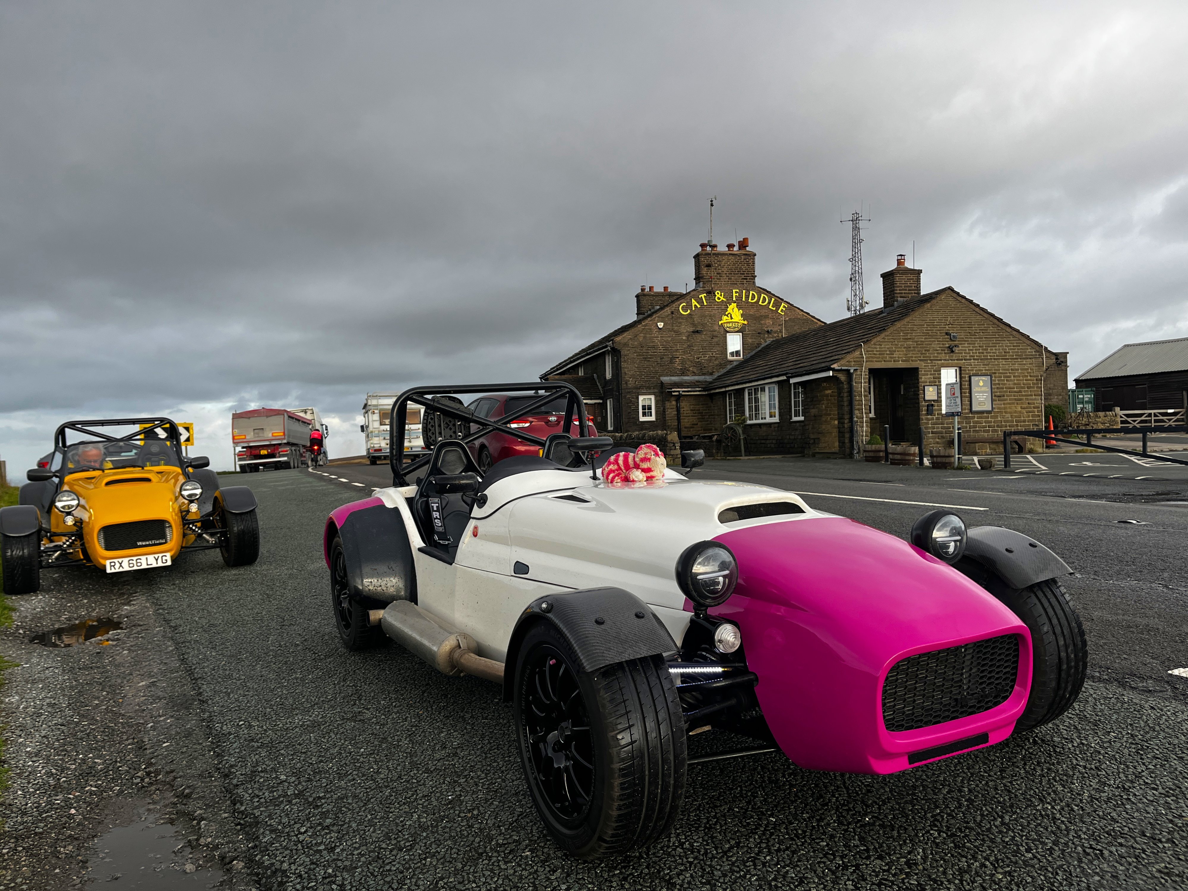

    It wasn't as bright and sunny as forecast, but we had a good blat round and got my oil warm ready for the annual oil change!
