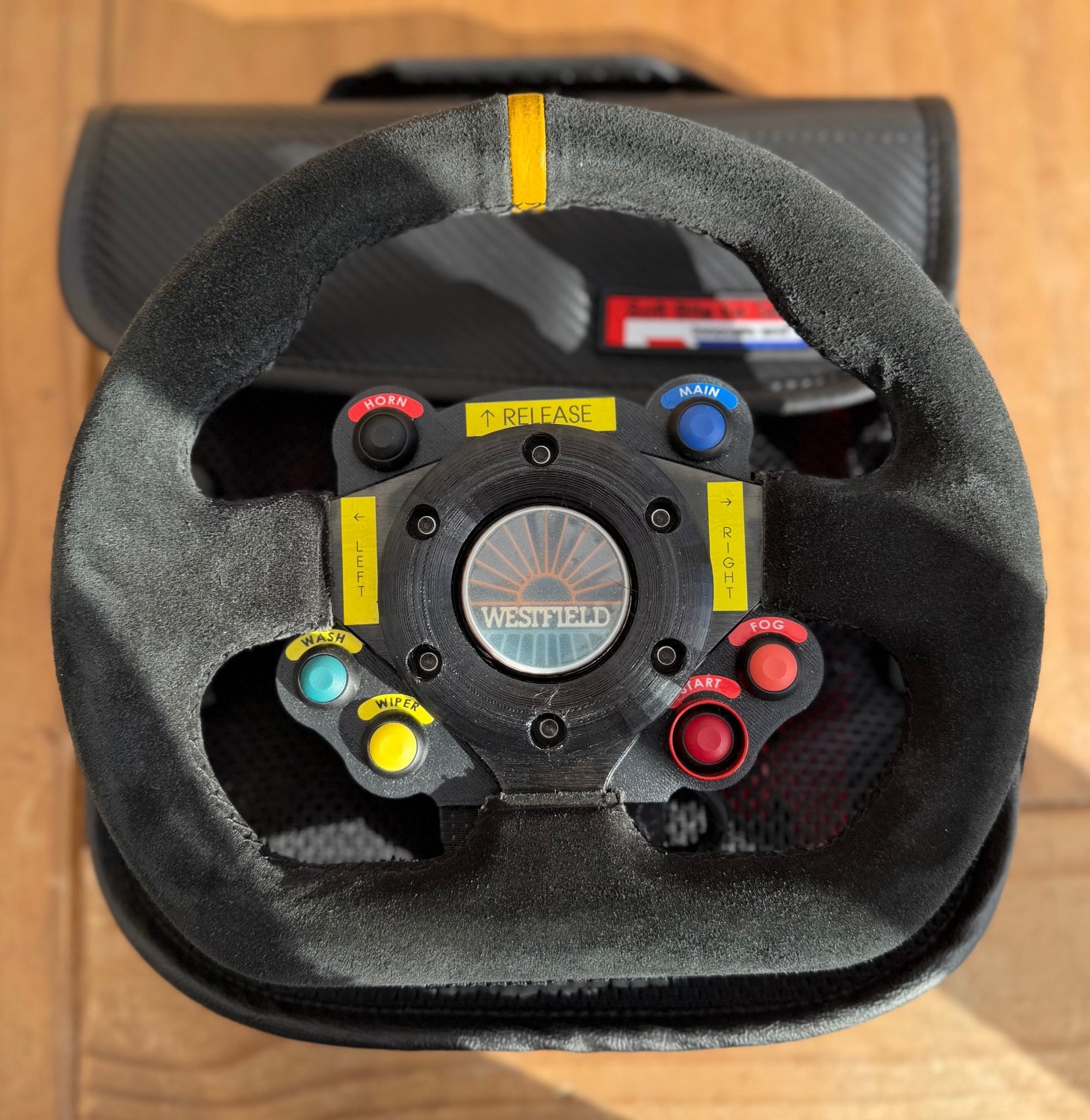

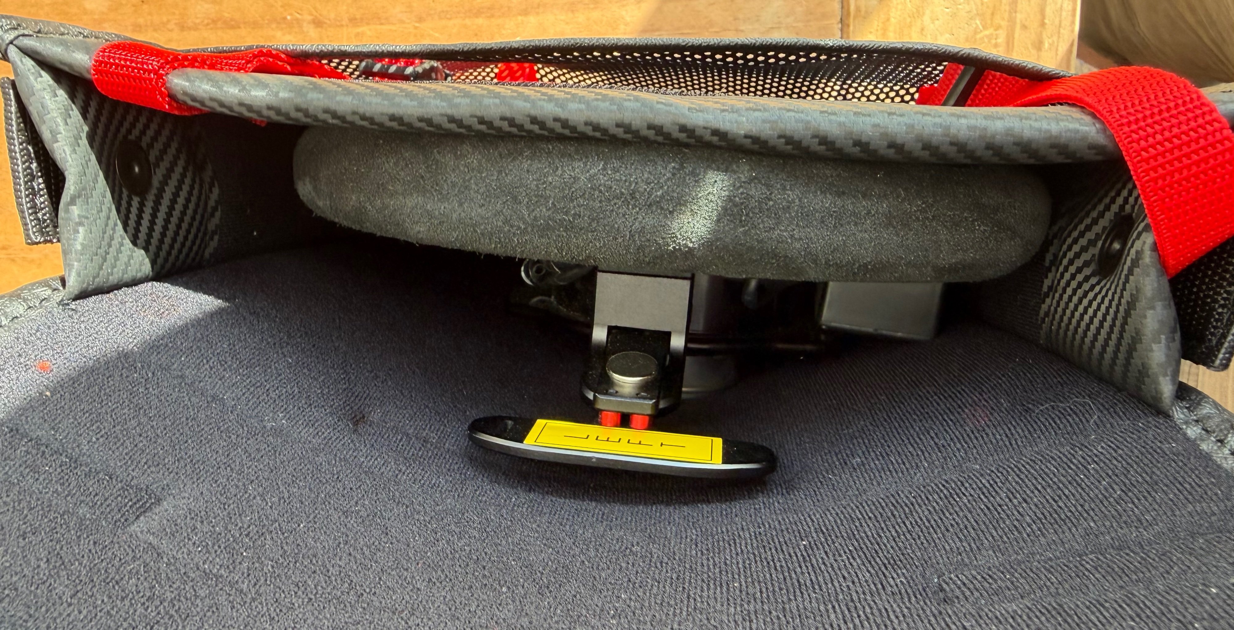

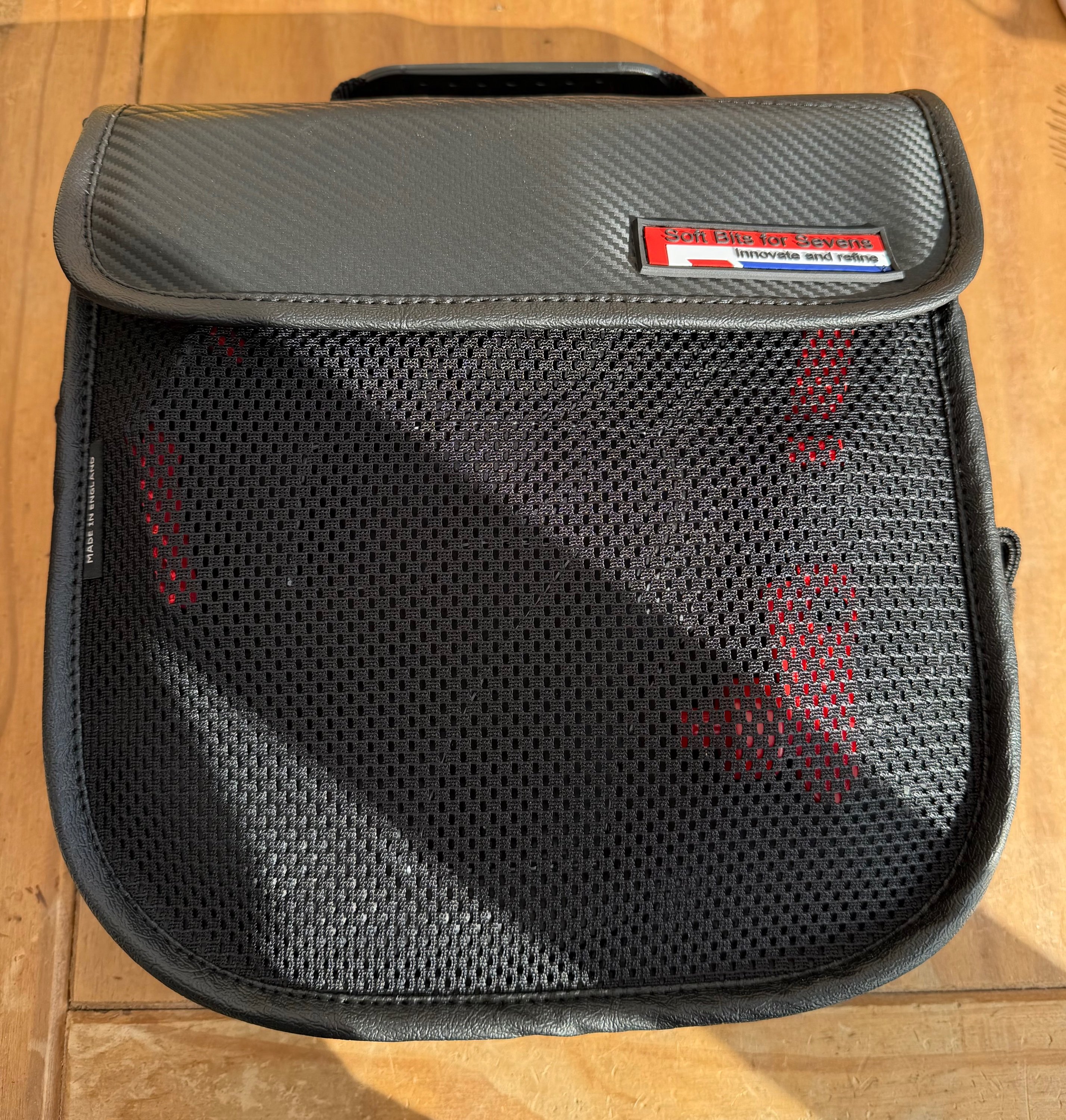

    Been waiting since December for this one, but well worth it. SBFS Steering wheel bag, takes my modded 250 very nicely, snug, but doesn’t activate any of the buttons so it is ideal.
