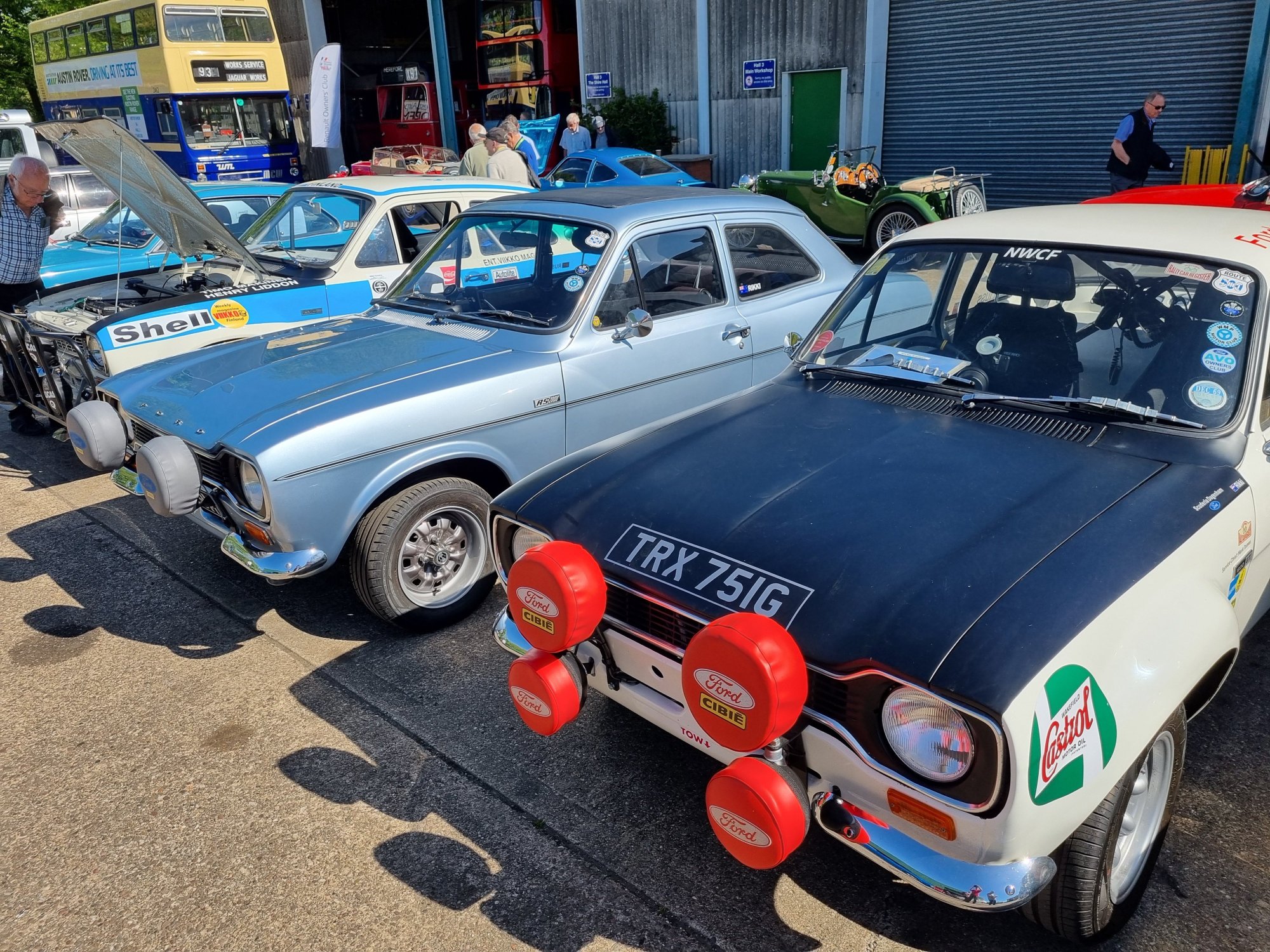

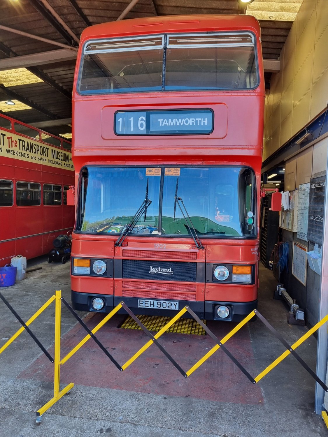

    Wythall Transport Museum Cars and Coffee/Drive it Day Event
    Some pics from today.
