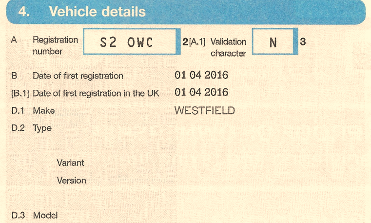

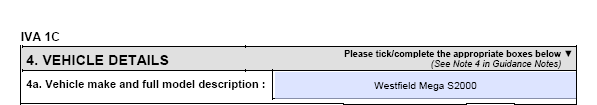

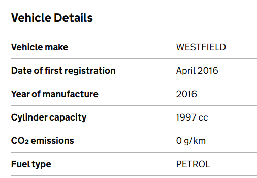

I'd not fret too much about the Sport 2000 record. When I built and registered my S2000- here's what I put on the registration application paperwork- Here's what DVLA's online checker shows- & the V5 is blank in some of the fields- I guess it all depends how much the DVLA Clerk wanted to type in on the day, perhaps! -
