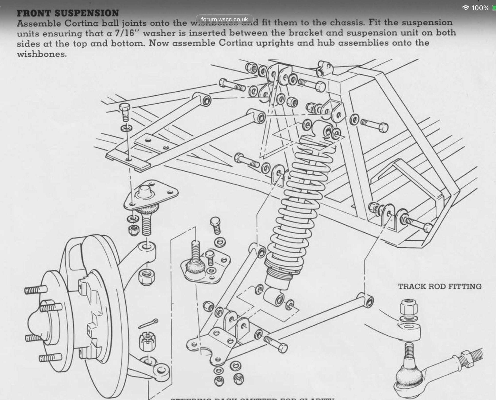

@7Westfield those look very similar to the XI wishbones.
interesting So, mine is the first variation if I interpret the chassis # correctly, it must be fairly early by the info I have, it's 71, laid down in 1985
To be honest that's not a Pre-lit because it is an early Westfield (clone of a Lotus 7) with Ali body. The pre lits that caused the court case with Caterham were the all fibreglass Westfield 7 SE built in the last part of the 80's. Chris Smith built around 800 of these and it was that success and the fact that they were cheaper to buy and build than a Caterham caused Robert Nearn to take out litigation. The red car is my first Pre lit built in 1986 and the other pic shows my current pre lit used for hillclimbs and sprints. Both have all glassfibre bodies and wings
The plot thickens we are now up to 3 variations on mine, the rear leg (both upper and lower) is straight, at roughly 90 degrees to the frame rail assuming the frame tabs are the same, it would seem my car could have a roughly 3 inch shorter wheelbase? Mine is equipped with a xflow, Ford diff, and Spitfire front uprights is there any count of cars so equipped? or how many came to the US? I know of one race shop that was building them over the winter, in order to keep staff busy
THis is a prelit top wishbone sitting on top of a standard track wishbone. I know the curved one is a prelit beacause I've built two pre lits and the curved wishbones came with both. I replaced them with the later wisbone to give better clearance for dampers and to increase track width and to provide better caster

If you zoom in you can see the bolt heads on the right hand side of the picture. I'll dig through and see if I have better pictures next time pc's on
Yes an early prelit one. It always frustrated me that others had the ball joint that threaded in and adjustments could be made
nope
I think that's a bottom wishbone.
are you sure? Doesn't look anything like mine
