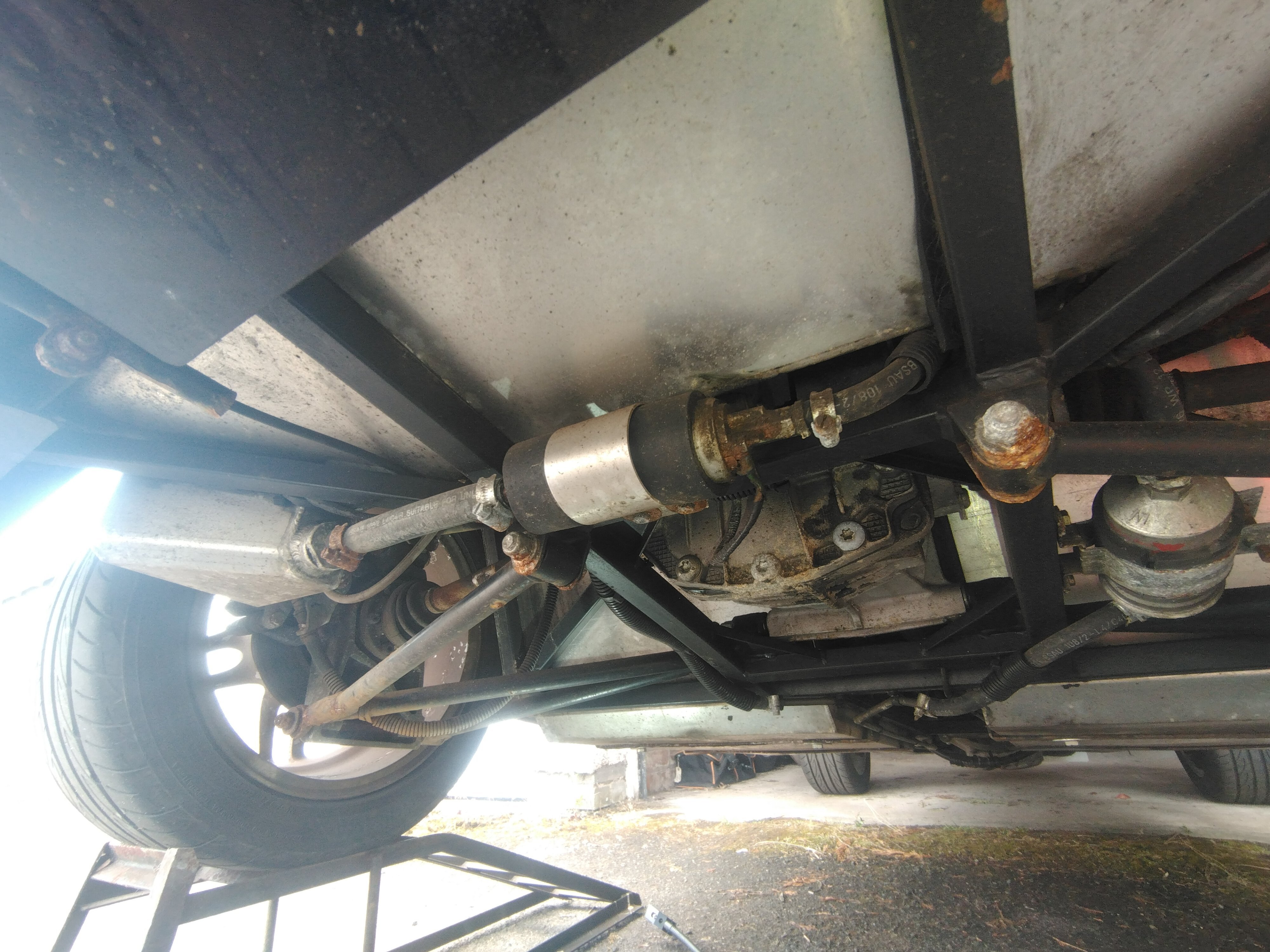

my duratec FW
Ian Kinder (Bagpuss) - Joint Peak District AO replied to mTT97's topic in The Start Line
I put cable ties under the aluminium tank straps. Then fasten the hose to the cable ties with other cables ties. -
my duratec FW
Good work @mTT97 I found the self adhesive pads didn't stick too well to the tank. I hope yours do!
