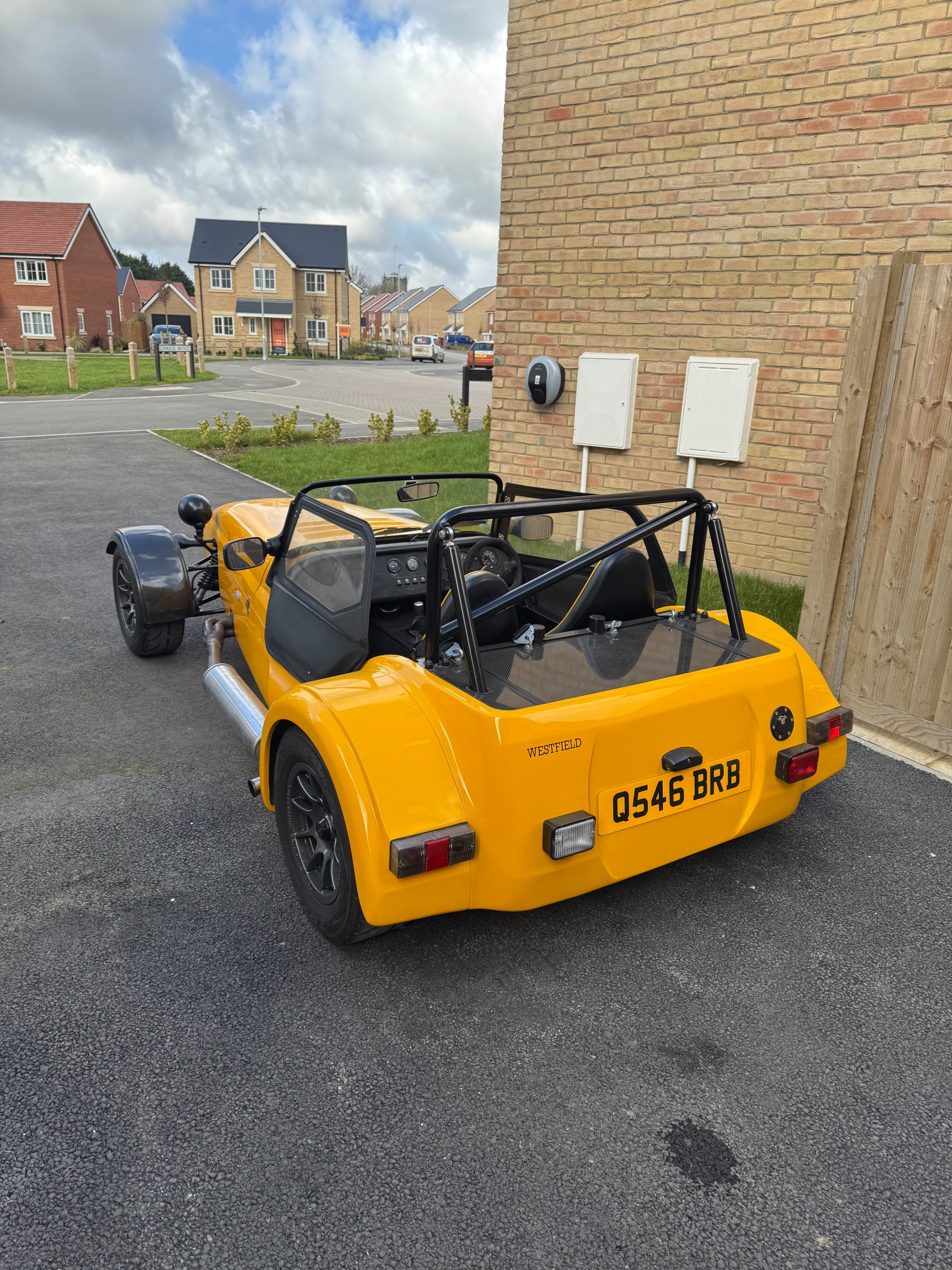

Selling due to lack of use, its mint. 2.0 Zetec blacktop. Engine was replaced a few years ago, its covered around 3k miles i would say. Currently has 12880 on the clock. Ive had it 2 years and had a new clutch, new diff. Its on twin webers which run perfectly. 2 fat folders worth of history down to nuts and bolts used on the build. It had a mini restoration by a previous owner a few years ago, which i have aprox 100+ photos from. New suspension brakes, and the engine. Ive covered probably 600miles in the two years ive had it which just isnt enough for me justify keeping it. I know i will regret it massively.. £11950
