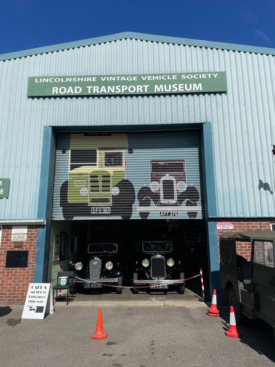

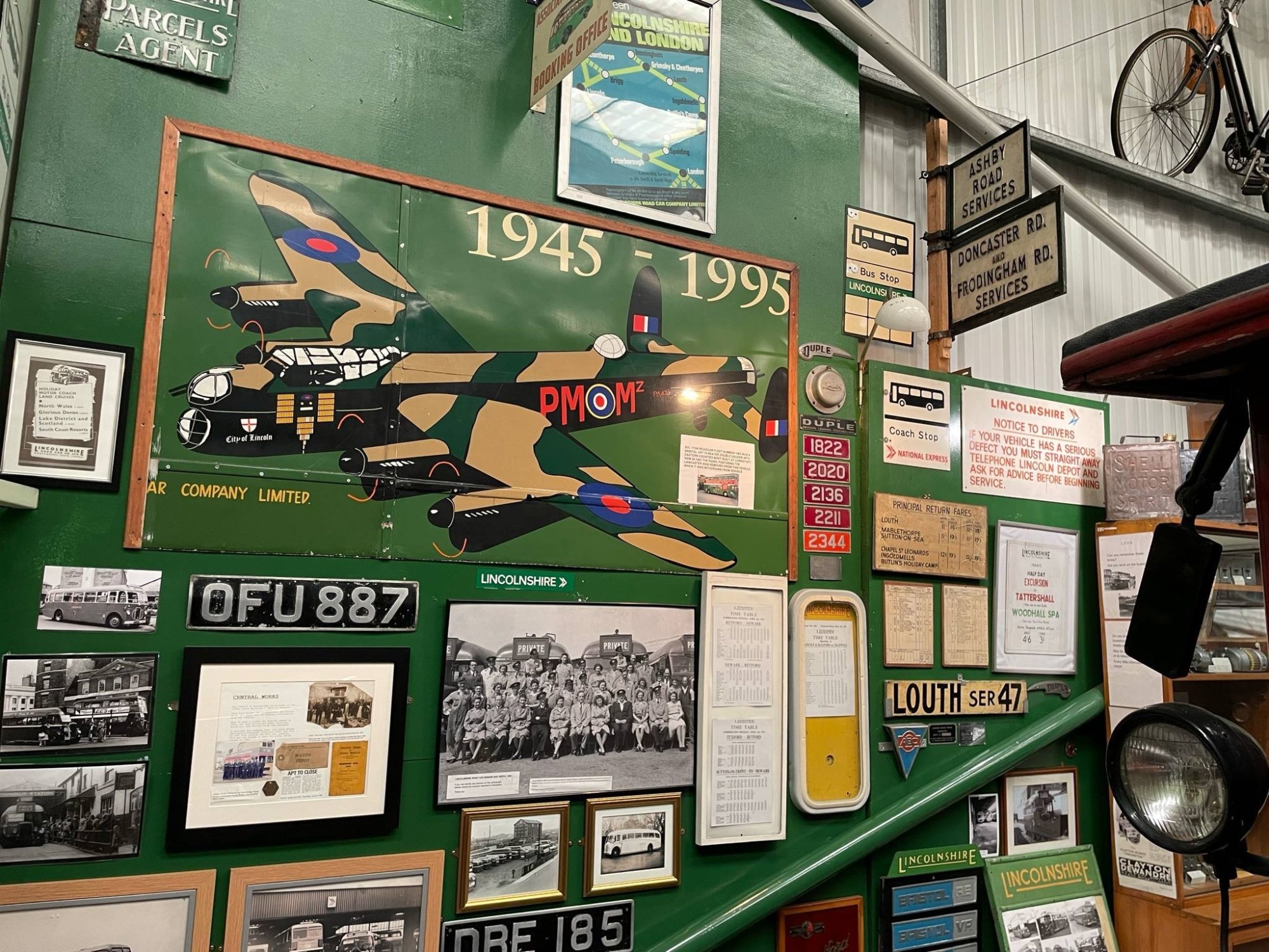

  3. Today was the tail of two halves. First half not fantastic. Second half surprisingly good. Starting with the first half - arrived at the Lincolnshire Road Transport Museum at 10 to meet up with @Jakejmagee, @matthew902and Gary Kingsnorth. Museum was interesting but not particularly overwhelming. At least with Jake there, the photos are good - Second half much more popular. Unfortunately @matthew902 had moved on having decided to visit the Bomber Command Memorial. We were joined by @Chris Emm and Mo at Daisy Made Ice Cream at their car event. This clearly didn’t have the word ‘classic’ in the headline so the average age of the public was significantly younger. Much bigger spread of cars and more of a buzz. Unfortunately Jake had to leave so the photo duty reverted back to me so not so good or plentiful. Glorious weather, lovely company. Quite a day. Thanks.
