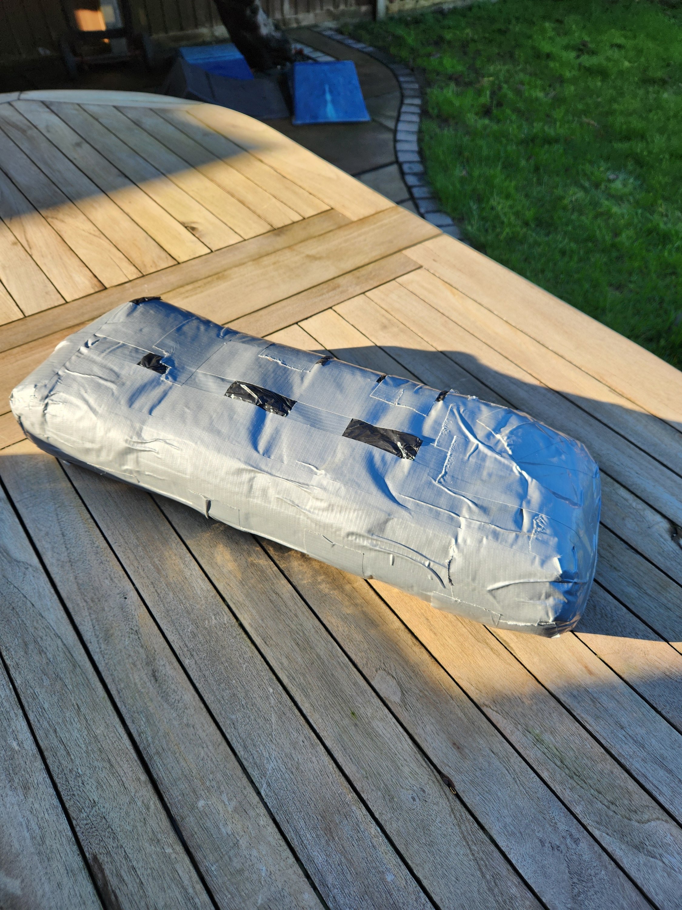

my torque wrenches arrived today good job i don't need them urgently it's going to take a while to unwrap them they come with a free roll of duck tape -
