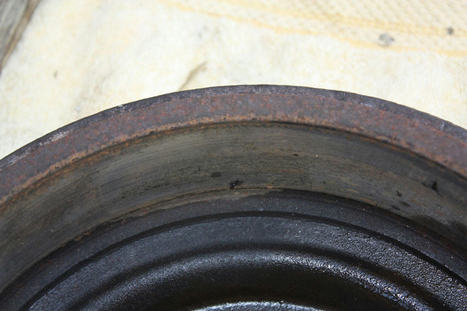

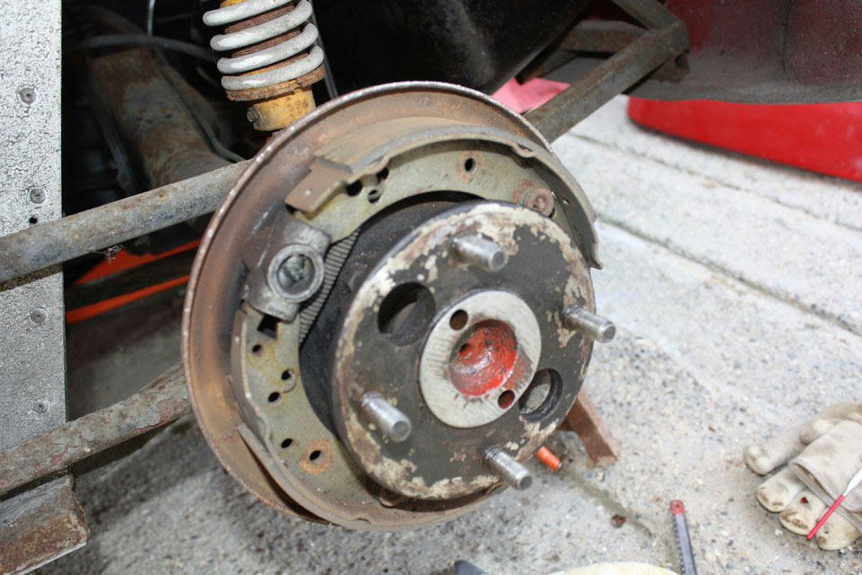

Well, after my many hours of toil trying to remove the nearside brake drum, I think a little Cozy would be worth listening to. It's off! We persevered with the process of using Rost Off and jiggling the drum about plus a generous amount of filing around the axle and eventually, pop! it came off.

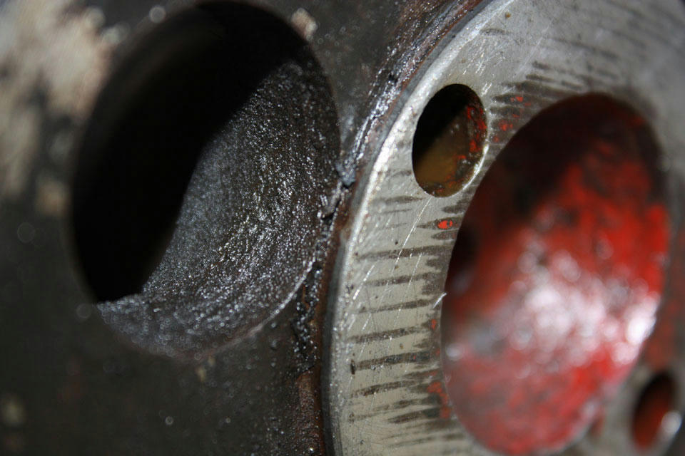

Just visible on the right is the red handle of Alan's diamond file that did a sterling job of removing enough material from the end of the axle to allow the drum to come off. I'll be giving both the drum and the axle a light sanding to clean the surfaces to ease re-fitment.
The shoes look good, just a clean and gentle rub with steel wool will see them back to life. As this wheel cylinder was weeping a little I ordered a new pair of Borg & Beck cylinders from Ebay. They'll arrive Wednesday so I can get this side fitted and work on t'other.
The drum doesn't have a lip on it but a light going over with some production paper will clean it. The axle wants cleaning a little as there's paint residue on it which could have contributed to the sticking drum.
