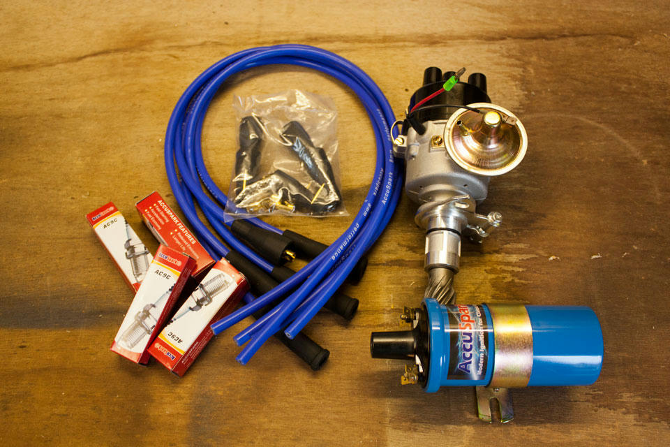

Right then, ditch the points, condenser and old coil, distributor and leads. Buy a new set, or, like me, buy an electronic ignition set. Having researched a few, I settled on Accuspark. They provide a new distributor, high power coil, triple electrode plugs, ignition leads and for a little more, a timing light and rev limiter.
I fitted these items (all but the leads) and tried to remember how to set the static timing. The distant memory of getting No1 piston to TDC crept back between the burnt cells of my squishy bits up top so I got that sorted. My neighbour and I rigged up a temporary fuel bottle direct to the carb as I thought the pipe from the tank was blocked. Still no joy, but a few jolly good bangs! Some research needs doing then.
