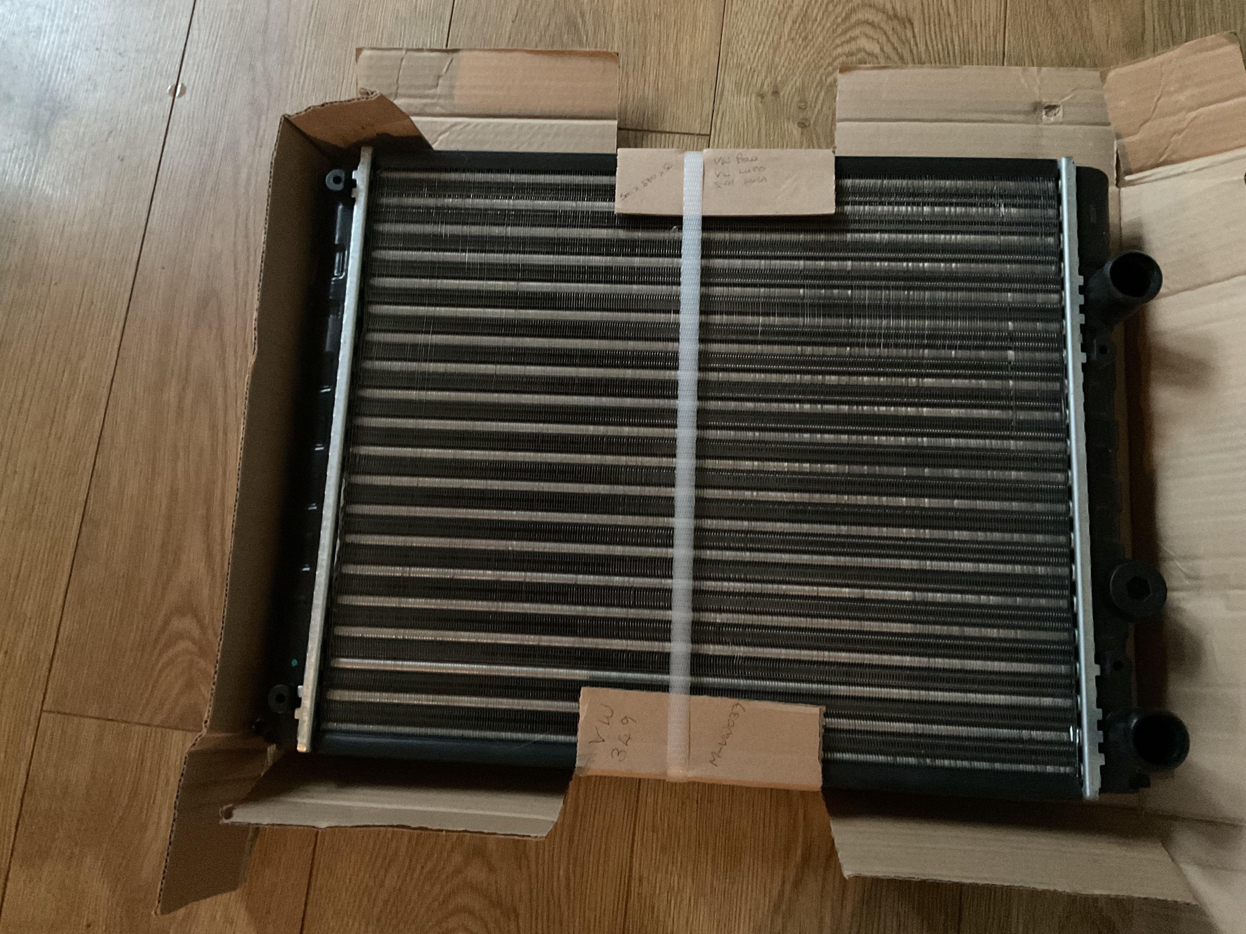

    Radiator fo sale
    Brand new VW 349 aluminium radiator 580x380x38mm fits polo / lupo / seat arosa better cooling than the VW 302 due to larger surface area £25
