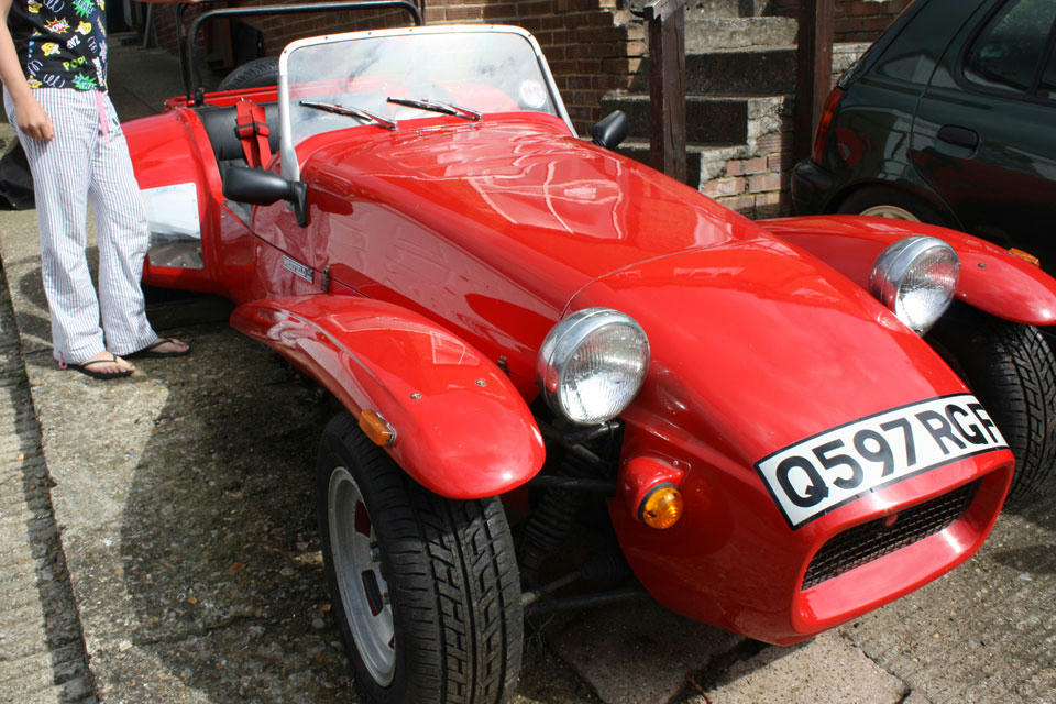

As I don't think I have seen any indicators on the top of the clamshells to 'hide' the screws, I'm assuming there is some legality preventing it?
I think it would make them more visible to other motorists (and I might actually remember to cancel them if I could see them)
Could I reposition them here?

Instead of reposition, why not just add some and splice into the existing loom?

Just added some side repeaters on my swept wings a few weeks ago - give me a call to discuss details. :)

Mine has them perched right on the edge of the wing.
I don't have a problem with them being there. Ordinary new cars seem to have done away with visible side repeaters so maybe the law has changed.

Back on topic, is it possible to use small LED repeaters here? A greater light output could be achieved with a smaller unit these days.

Yes. I have all my front indicators (front and side repeaters) on the cycle wings in led form. Lots of good choices on ebay.

Yes, but you may well need to change the flasher relay to one compatible with LEDs.

Good point Scott. I have leds all round so have one led specific electronic relay for all indicators, but if you mixed it up leds and bulbs then you obviously could use resistors on the leds.
